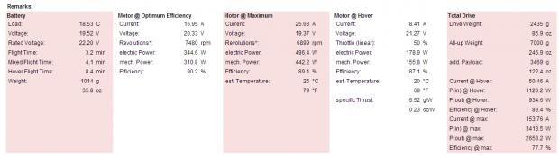

Couldnt find the DJI motors on Ecalc.. so this is done on HP 4114 400kv.. 7kg and 2 x 5000ma 6s 30c lipos

Great thank you. What is the softwares definition of flight time compared to hover time? Does flight time mean aggressive flight? Should I be looking at the mixed value for a flight time prediction when flying for filming?
Jumpy07
I find ecalc tends to be worst case scenario.. doing AP work you unlikely to be chucking it about.. so would go with somewhere between mixed flight and hover..

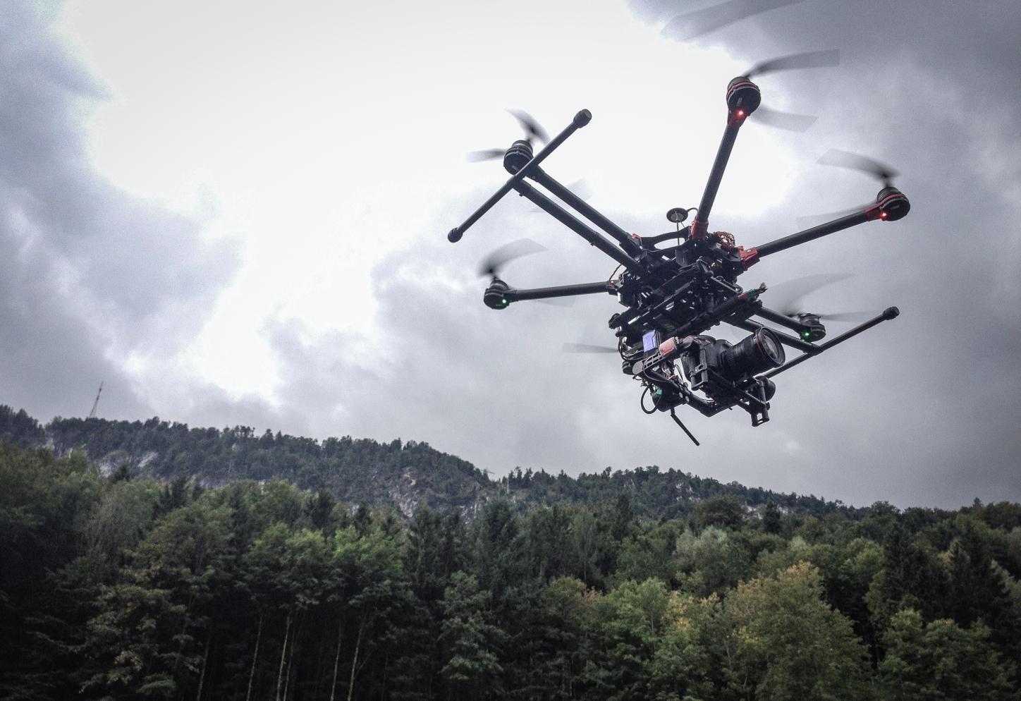

if anyone is considering flying the s900 with a canon 5d. today i did a testflight with my s900 + besteady one plus gimbal + canon 5dmk3 + 1lipo with 8000mah. i got 7 minuits of easy flying. i recharched 6000mah. im pretty stoked ...

Cracking picture Screwdriver...
Thats a great flight time.. wouldnt have though u would have got that long..
tikigod19
Great. That's exactly the test I've been waiting for.. Now I have no excuse to hold off on a £6k purchase! Be brave.. Click buy..
Tahoe Ed
Did you get the longer landing gear with your S900? I would think with the 5D you would need it.
