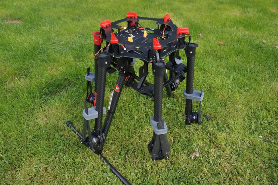

Picked up an S900 / WKM / GH4 combo today (wont get gimbal until next week). .. It came with the extra long legs..

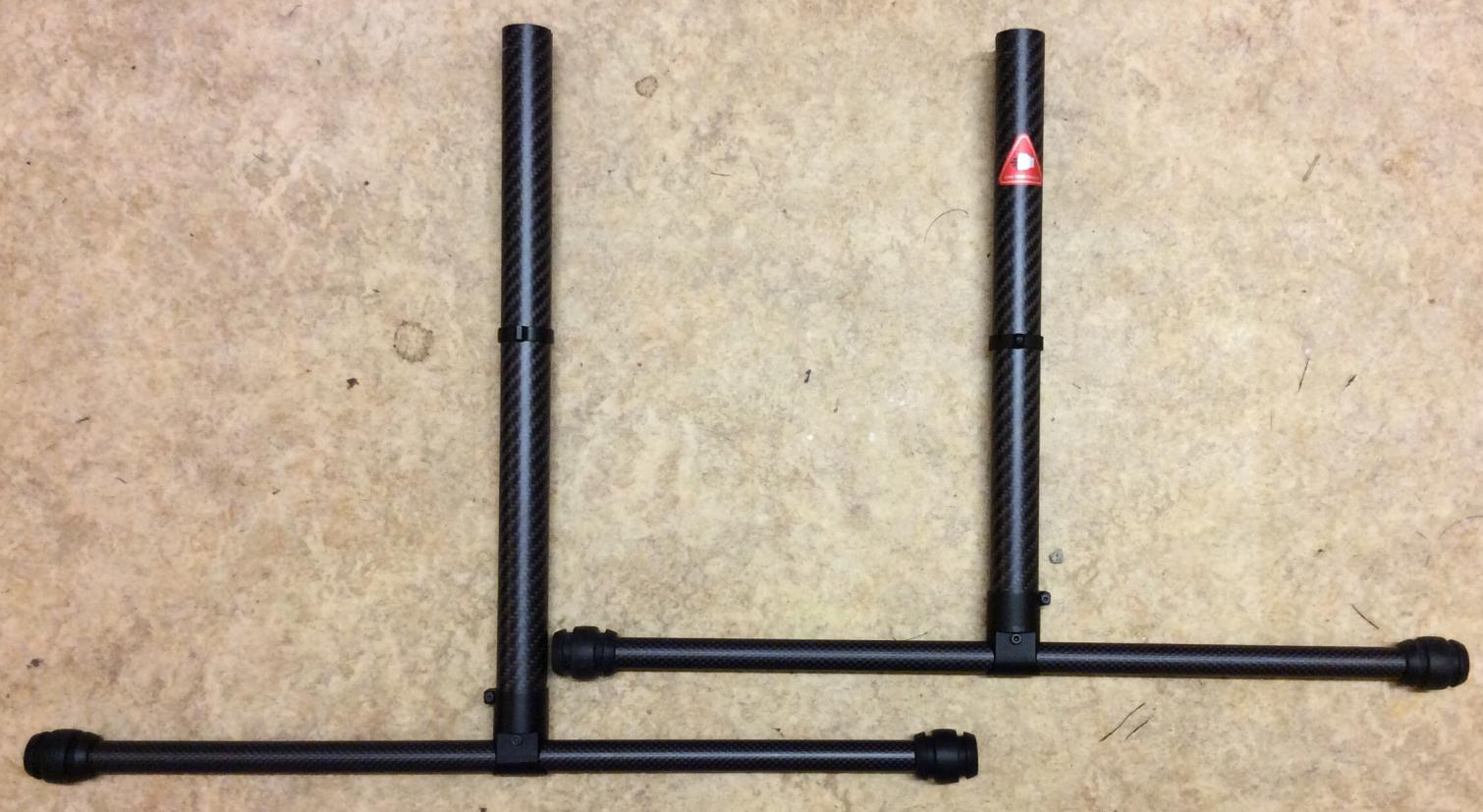

Difference in long and short legs.. carbon twill looks different.. and they feel like a lighter tube...I weighed them and there is 3gram difference in weight per leg.. so long legs 6g heavier..

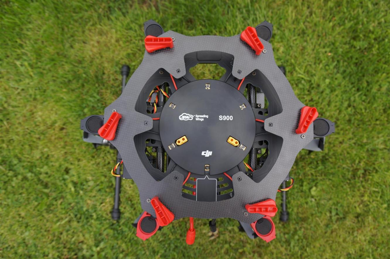

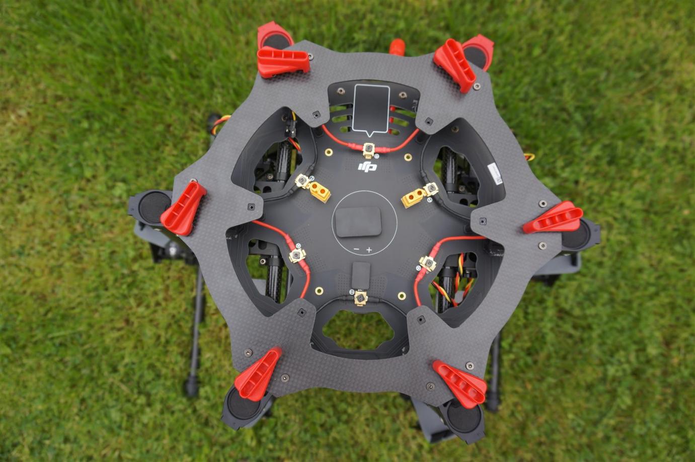

Started the build..

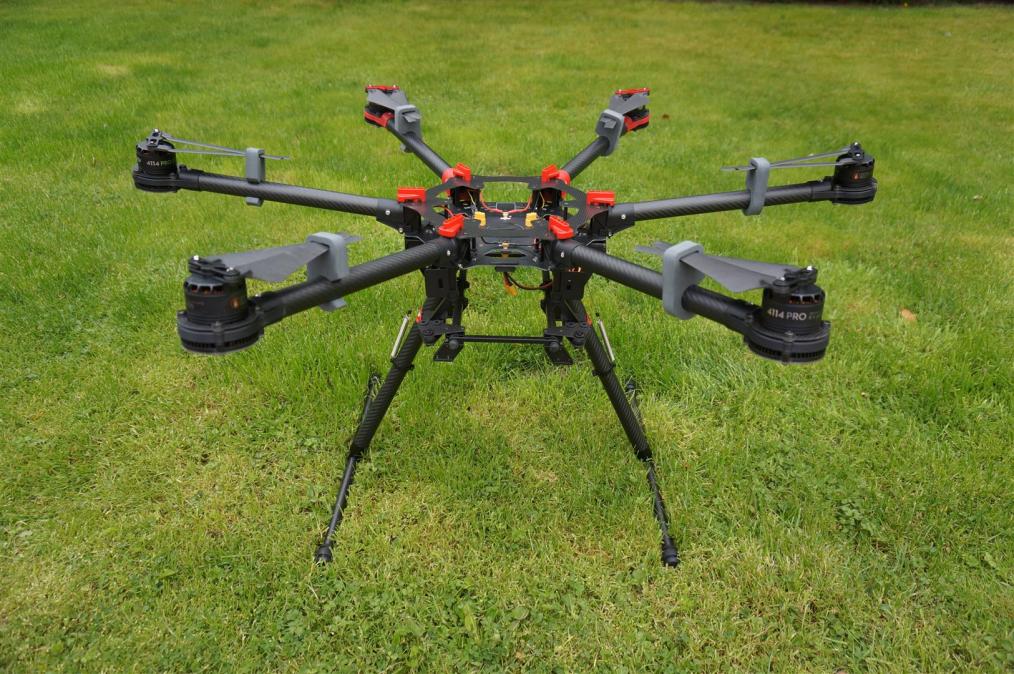

This is the S900 with the longer legs, (not I had red arms to rear.. but have now moved them to front before anyone points that out lol)
I really like the design, its a lot smaller than my CarbonCore H950 Hex.. and looks quite squat.... loads of room..
