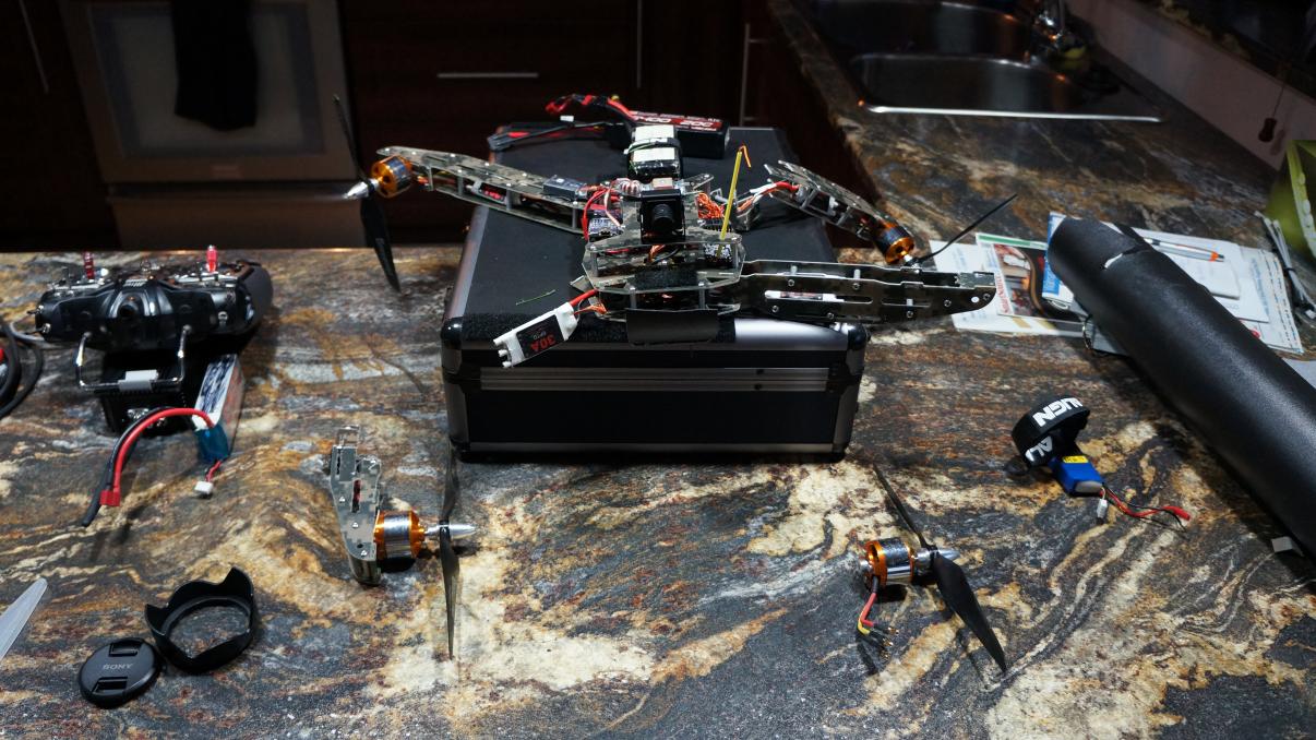

I got this as a play thing for the 550D and a test base for a new adventure into the use of 4 voice coil driven inner axis system.
