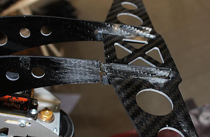

Just to diverse for a moment, The more that I look at this thing the less I like it. What intelligent person would design a landing gear so that it focusses all of the landing loads at the weakest point and then drills a nice hole at that point. Oh I get it. It's supposed to break. Yeah that would be very good for those expensive replacement parts.
@ jess I don't have a proposal for the low end market. In an effort to create a cheap solution I played with servo drives a while back and decided that it was never going to work properly. The professional market should be just that. The hobby market is something else but it should at least be fit for purpose.
Normaly the landing gear must be plugged deeper. the vertical part nearly touch the ground.
Anyway on the new landing gear there is no more the skids but rods.
