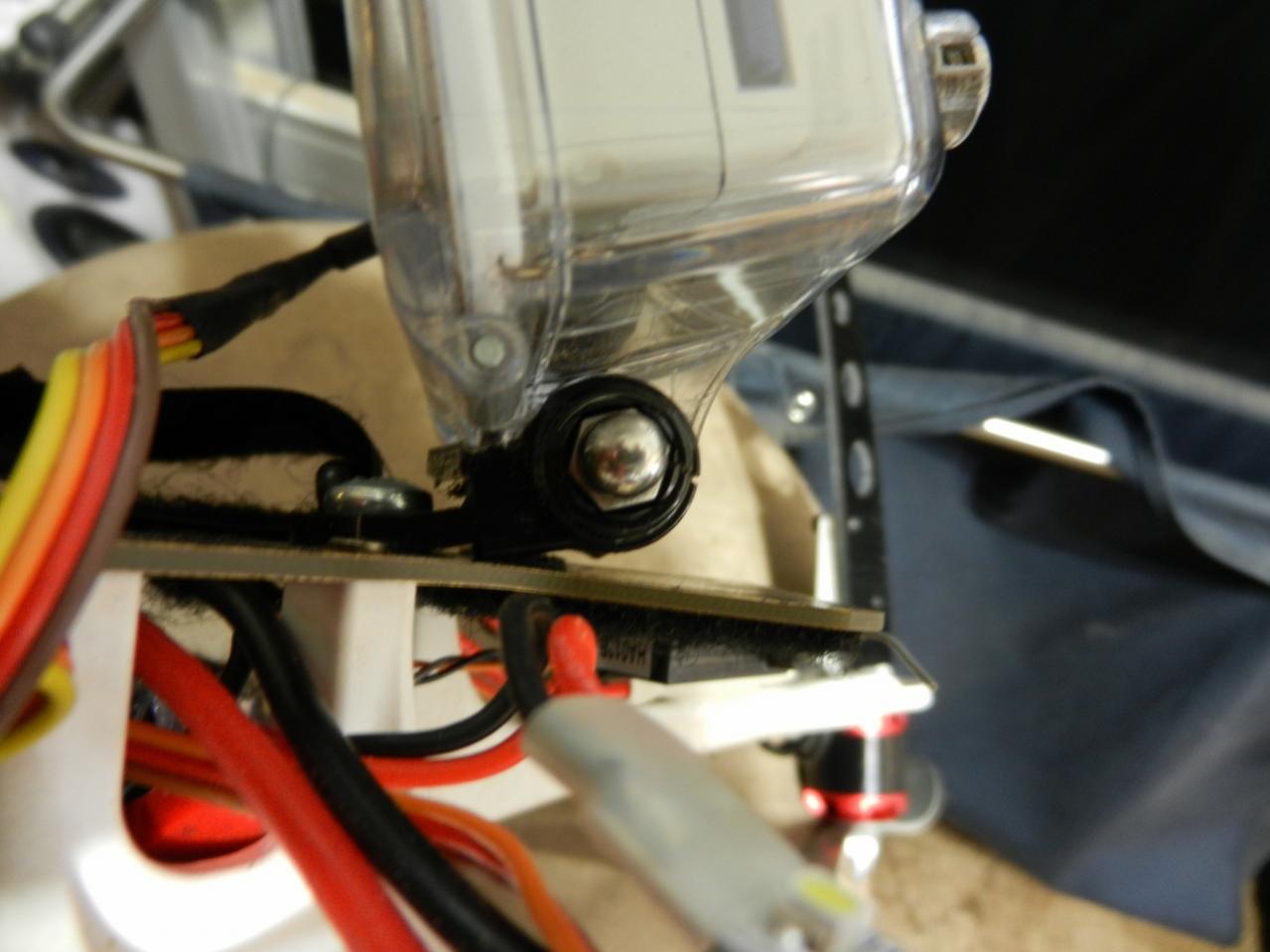

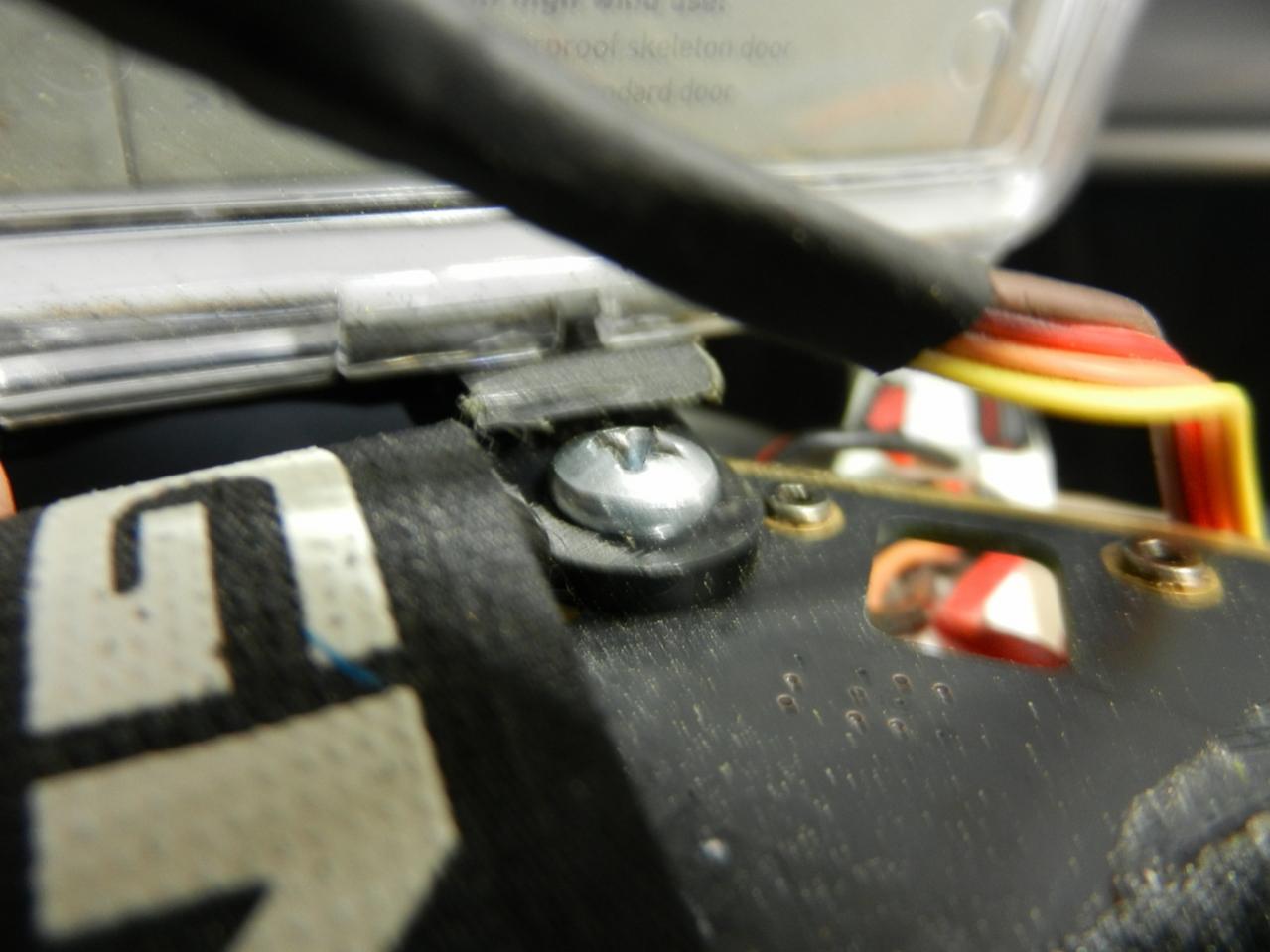

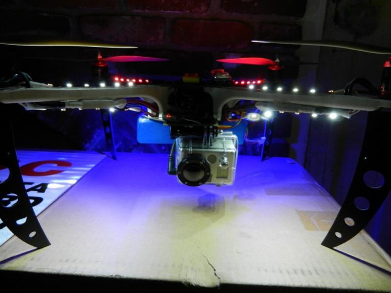

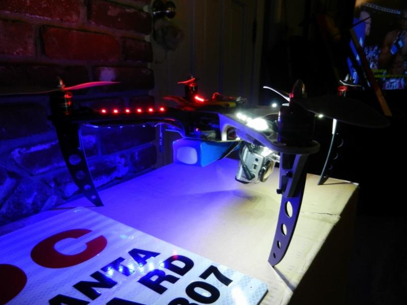

kloner,
Your videos don't look to bad at all. how do you have the camera mounted to the frame? Are you using any soft mounts?

I'm talking about the pitch/roll in basic and atti. i've fallen on 120 basic, 80 atti and it's as smooth as can get it. Have made 232 go pro vids trying to tune it so far since new years. The lower settings give the camera a fighting chance to smooth out. higher gains made it shake, forget jellow
View attachment 2501View attachment 2502
Thats underneath next to a leg with the lens centered
View attachment 2503View attachment 2504
