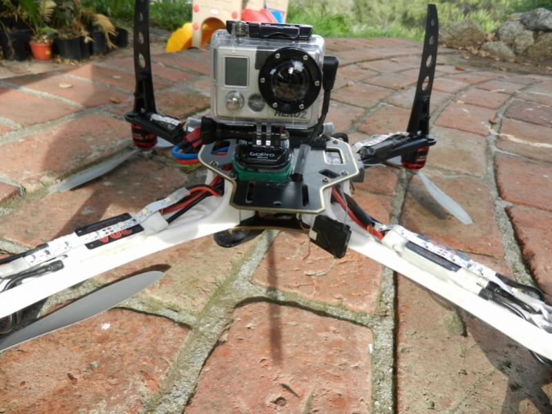

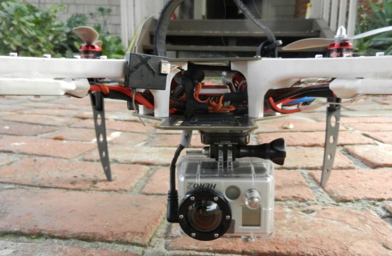

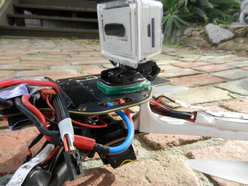

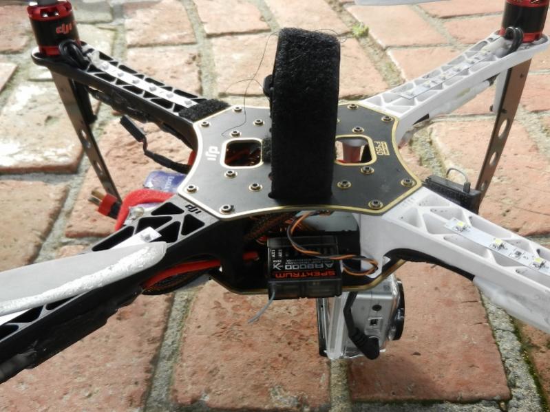

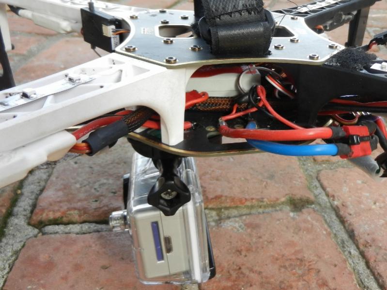

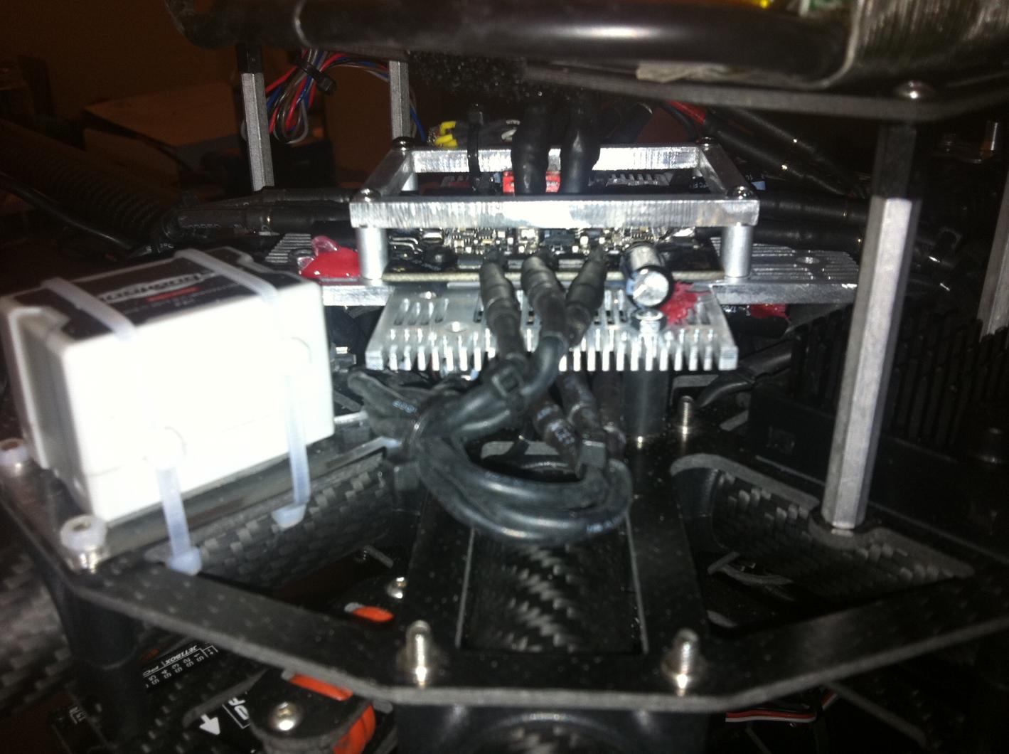

I've tried the camera in alot of spots, so far the best spot i found is under the bottom plate, super stiff but the small vibes were still getting me from time to time so i added a piece of zeal between the frame and gopro slide in mount and i thingk it finaly got the grind out of the camera, it sounds different, was getting like you hold your ear to something affect and whatever was closest was loudest
this was last night, went up 185 feet according to the gps
in the begining i kept stopping before going up, was trying 70 atti, 80 atti and 90 atti, then at the end i went up high and back down at 90, then did it at 70
Was trying to tape the onboard difference

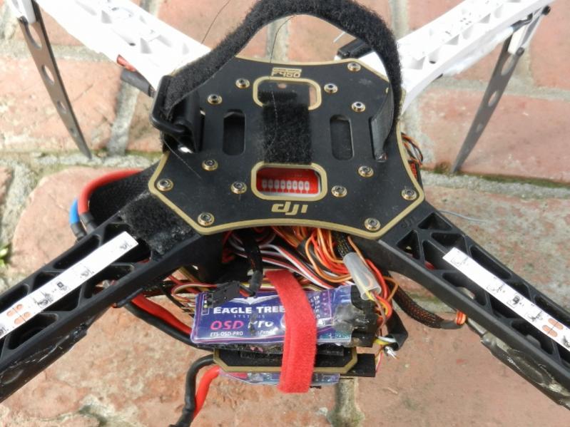

It's the eagle tree gps with the osd pro and the v4 logger..... I thought about trying one, but been pretty satisfied like this. It's gonna be fpv and it kinda gives me a little more aspect of how big i am and what it's gonna go through, i may still try it if that doesn't work out when i go for my maiden fpv adventure. the biggest thing i want is to record my venture somewhat clear and jello free and i'm about there. the legs were out of view till i moved it back and set on this tape.
I bugged out of the hole mount, got it clear but it had that ear to the chest sound coming in driving me nutts. Went to this with the battery back up top, also went to a 3000 mah 4s and am getting about the same flight times as the 5000 was giving me. Got 6 of em. The zeal was cut oversize so it would wobble on the tape, but stay steady down inside it. I'd pretty much gotten out what i couldn't get tuned out with the apc props. my graupners get here tomorrow so it may or may not be needed, but sure is easier to listen to other than the wind noise. can hear your props buzz or not, helps tune a little

so the zeal tape has that good of a hold?
i got some coming so we will see, im thinking of mounting the naza to it as well
had to use a dab of shoe goo on the frame where it went over that gap for the battery strap but only because the front edge of the tape had 1/16th of a inch on the front tab past the gap and i didn't trust it to stay. Even with vibrating props it changes the frequency alot lower and less.
My naza is sitting on that 3m 4010, it's the same kinda of idea being gel but is thin like the tape that came with it. Ace hardware has it, red plastic liner
