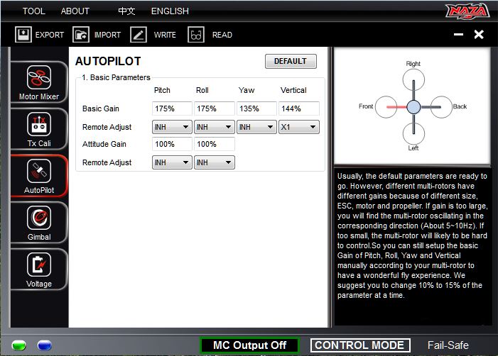

man, you got it cranked up.
Yea, fire it up in manual, when the manual settings are set right, she holds really well. think i'm at 150-150-130-100 then 110-110 on the atti
A few days ago i was screwing with the altitude setting and had some weird stuff happen up high so wasn't sure what it was, but it seemed like it was trying to slow the motors by alot and i didn't ask it, as it came lower it picked itself back up. i was up in the 130's when it did it, freaked me out, dropped back to 100 and she hasn't acted wrong since
