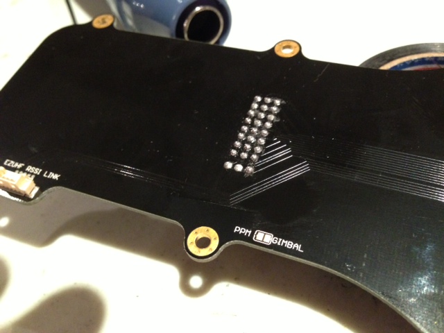

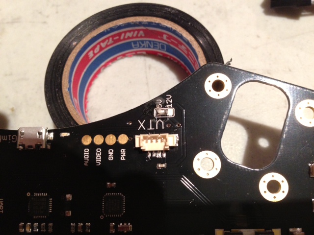

Sorry to bother you all but a couple of soldering questions;
1. PPM Gimbal Pad - Do you DAB on one or the other, both separately or bridge the two together?
2. Stock VTX comes 5V from TBS - To enable 12v kind of same question - Single Dab on 12V? Bridge them together? Bypass both and use white Molex (think thats what its called) connector? Bypass both and use solder pads to left and if so does the 12V pad still need some action???
Thanks guys and thank you TBS, it's AWESOME having to ask favors from all my internet buddies. Nah, manual?? Exploded Diagram??... no really, seriously,... thank you!! asshats..
haha, they figure that's the line where if it's too hard they'd rather you had it built, they offer it
you will make both ppmpads bridged with solder, run the iron across the vtx pad and it will unbridge then solder across the middle to 12v pad to enable.The rest of the adjusting for hero on a switch and such is on the osd setup screen, hold down enter to start, up down to nav. I put my vtx on plugs so can hot swap in the field if theres a problem, same with camera
