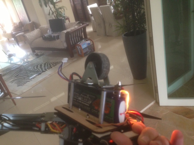

Man, I cant wait to get my DiscoPro. I'm in batch 2, shipping Sept 9. The waiting is making me do funny things like removing the landing gear of my Y6 and placing a caster wheel just to see what happens.
