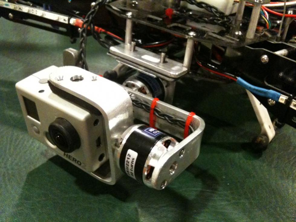

my frame got here yesterday so i had to build it out. this is 900 kv motors on stock arms. had the gains too low on the naza and this is the alexmos settings out of the box. uploaded the raw hero file

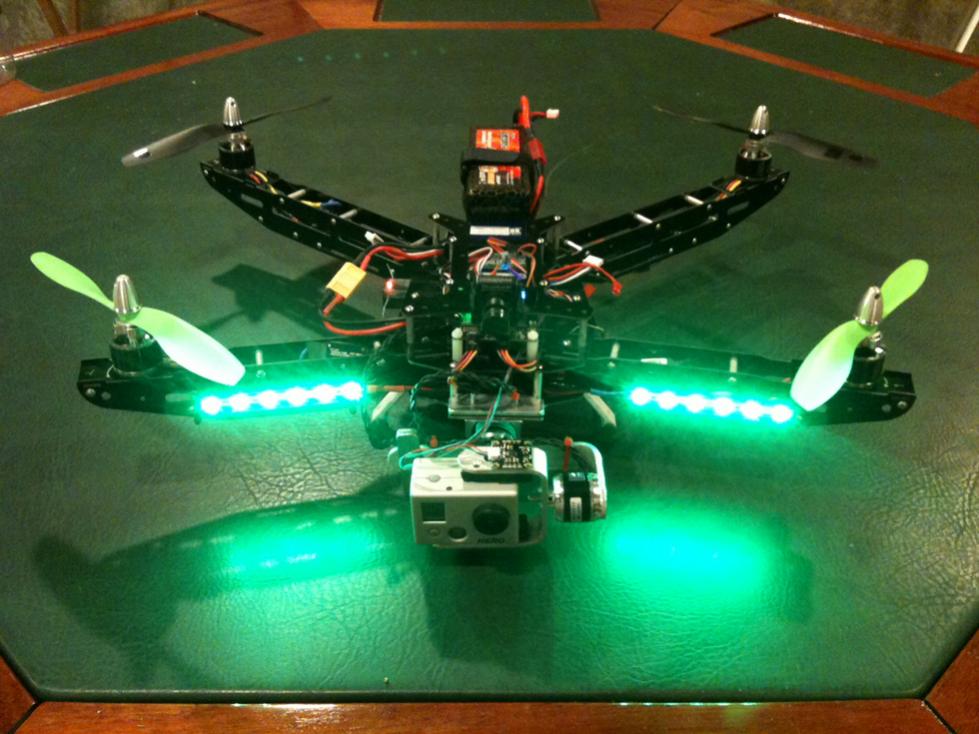

this is that 4s setup i always run with the leopard motors on 4s and 9" props... shes a smoker, but nothing like it will be next week.

the pro with 3515 tigers and a Droidworx ad quick release it's 1870 grams..... the 6s packs i'm flying are 435 gram, hero is another 100 grams

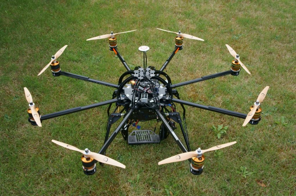

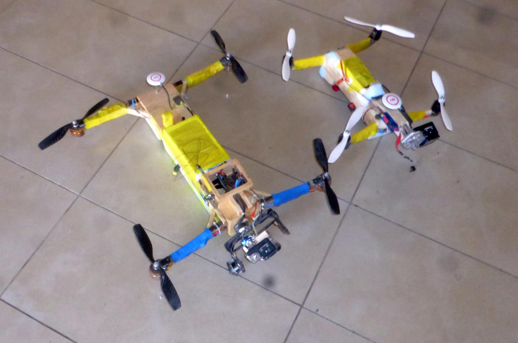

That is a very interesting SBG you have there, tell me more...production???
I've been piecing together a couple DIY gimbals myself with good results but having a tough time getting the COG on my quad in balance since the gimbal is out front so much on the HoverThings FPV. I'm also thinking that the original motors on the quad, NTM 28-26 1200kv's, just ain't got the pop to handle the additional weight. Not sure how big I can go on this frame and I'm still waiting on my Disco Pro to arrive, tracking indicated it's stuck in Singapore, so I'm using an old HoverThings VC-450 modified for now.

to carry something like the load you got there would take at least 28mm motors like 2814....

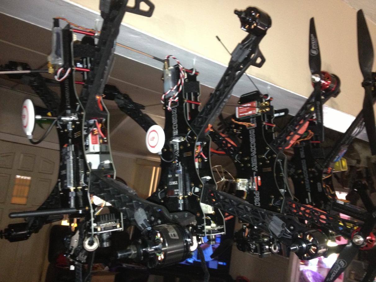

this rig of my friends is that setup and man, something wasn't right. those arms suck butt,,,,,, were gonna change that
