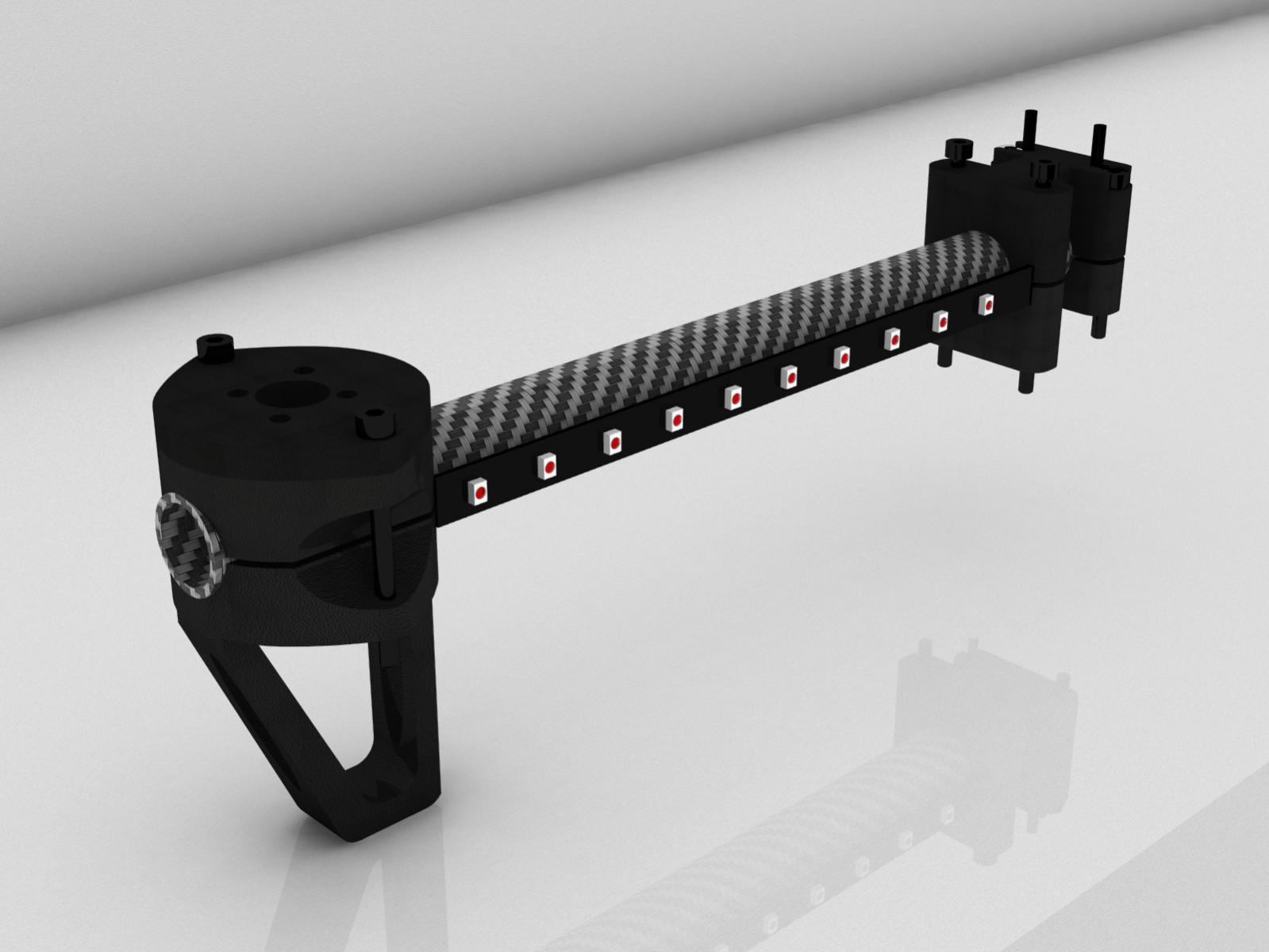

Also ordered one. Just not to happy to have to deal with the DJI arms again especially because i would like to knock the motors up to 2814/22 axis for example:
So i started sketching these parts ! Should allow to have standard 16mm booms attached to the tbs frame or any DJI frame.
Any thoughts on this or things you guys would do different. Parts will be 3d printed:

Freakin' awesome......not only for the Disco. But with this booms it's easy to have two motors on each arm with different motor mounts.

Thanks Chris ! Yes that was also my thought to have the option of mounting coxial , with an additional LG mounted to the boom. I just noticed that I forgot about the ESCs and that in most Disco cases they will be mounted on the arms. Have to think of something there that is stays clean !

Awesome Boris, exactly what I need. I already today use 2814 motors and need more stiff material. Imagine an X8 design with this small size factor.

Great idea Boris, the DJI arms are the major weak point of the Discovery IMO, at least they're cheap to replace!
Seeing the pic makes me think I should go out to the garage and start carving up some Delrin on the mill and give this a try on that spare set of Discovery frame plates I have :)

Hi Iris,
I will not be selling them ! Just gonna supply the STLs over shapeways and components from shapeways are not competative anyways since they are expensive !
Its designed now for 16mm tubes. I personally like those the best, 1.5mm thick very nice finish ! http://flyduino.net/3K-CF-Boom-34cm-matt-15-wall-thickness.
Sending the parts to shapeways now and gonna give it a try ! Final parts ! : Sorry couldnt deal with texture and a nice render !
Had to change the LG legs to fit under a ESC!
View attachment 12620View attachment 12621View attachment 12622
