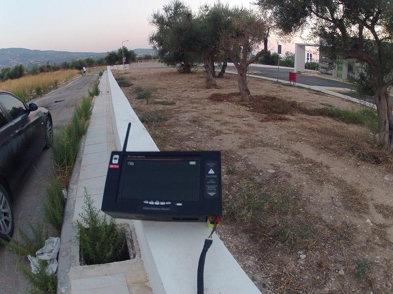

I have tried all options, Auto, 1080p and 1080i.
Got myself a miniHDMI to HDMI cable today and connected the can directly to my homecinemasystem with great succsess....
So I guess there something wrong with the FF card??

I have tried all options, Auto, 1080p and 1080i...
Just leave it on Auto. Do you have another camera with HDMI out to try?
The big ungainly, metal-boxed HDMI converter has been known to be a bit selective with which cameras it will work with for. Perhaps your FF item has the same problem.
As I said before get in touch with Freefly. They took your money, they should help.
