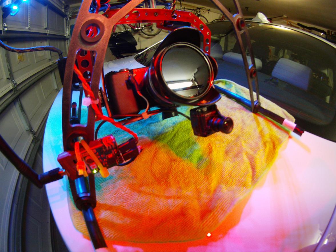

This is how I do it!
I have the stock Sony NEX-5, my setup is quite simple. I drilled a hole in the lens hood and attached the fpv camera below it. It doesn't exactly match the photo dimensions on the NEX-5, but it's pretty close. On the Fpv camera you'll have a taller picture while the NEX-5 will be showing a slightly wider ratio image with the stock lens. Here's the picture of my setup. I am a real estate photographer and I've been using this set up all along!:tennis:
