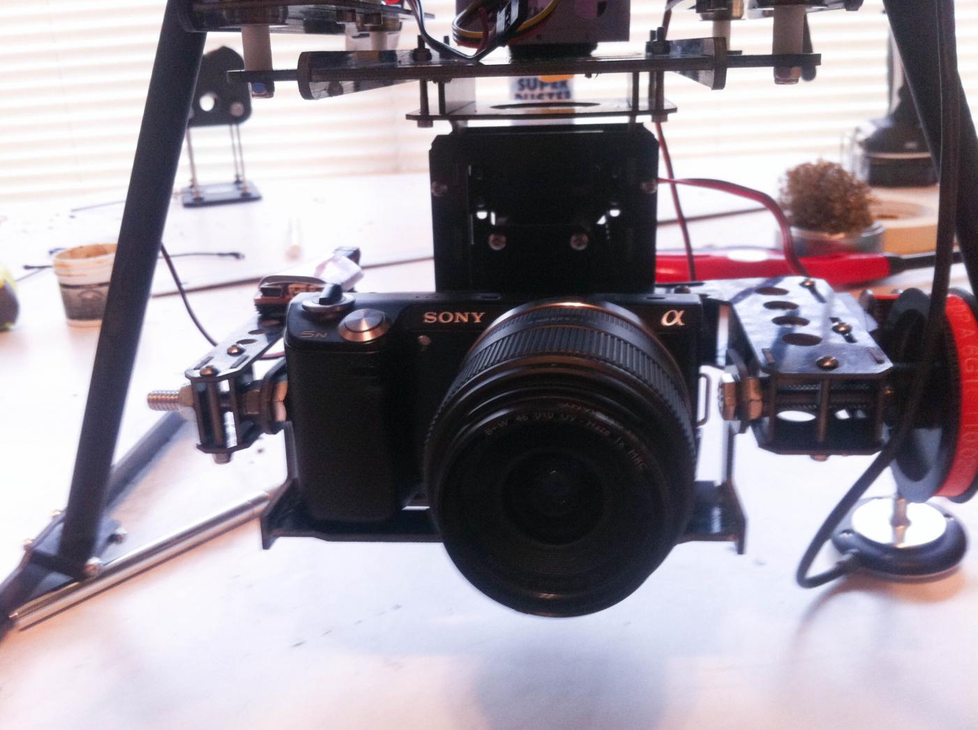

Is anybody using the Askman AG550 gimbal? If so, which HDMI cable are you using with the NEX5N? I have purchased two cables. One was a thicker cable with a right angle bend. One was an ultra thin cable. Neither would fit in the clearance between the camera and the mount. I tried letting it extend into the gap in the side of the mount but that interfered with the tilt. I tried hacking the covering off the end off the cable to squeeze it in but that didnt seem to work. I am out of ideas.

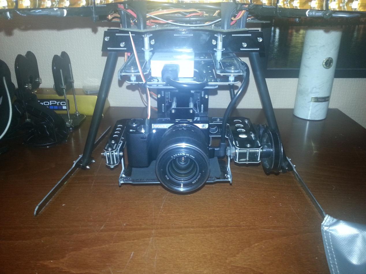

I got that exact one but there was no way to fit it between the camera and the mount that i could see. If you got it to work, could you post a pic?
Dr.phil

I don't appear to have the same yoke as you. My camera rests with the body in alignment with the tilt axis, your's appears to sit further back. With the left (facing front of camera) resting against the left axis bolt, I have a little less than .5 in of clearance on the right. Also, your lens appears to line up with the roll axis (as it should, mine doesn't) I wonder how I could have gotten a different yoke.
