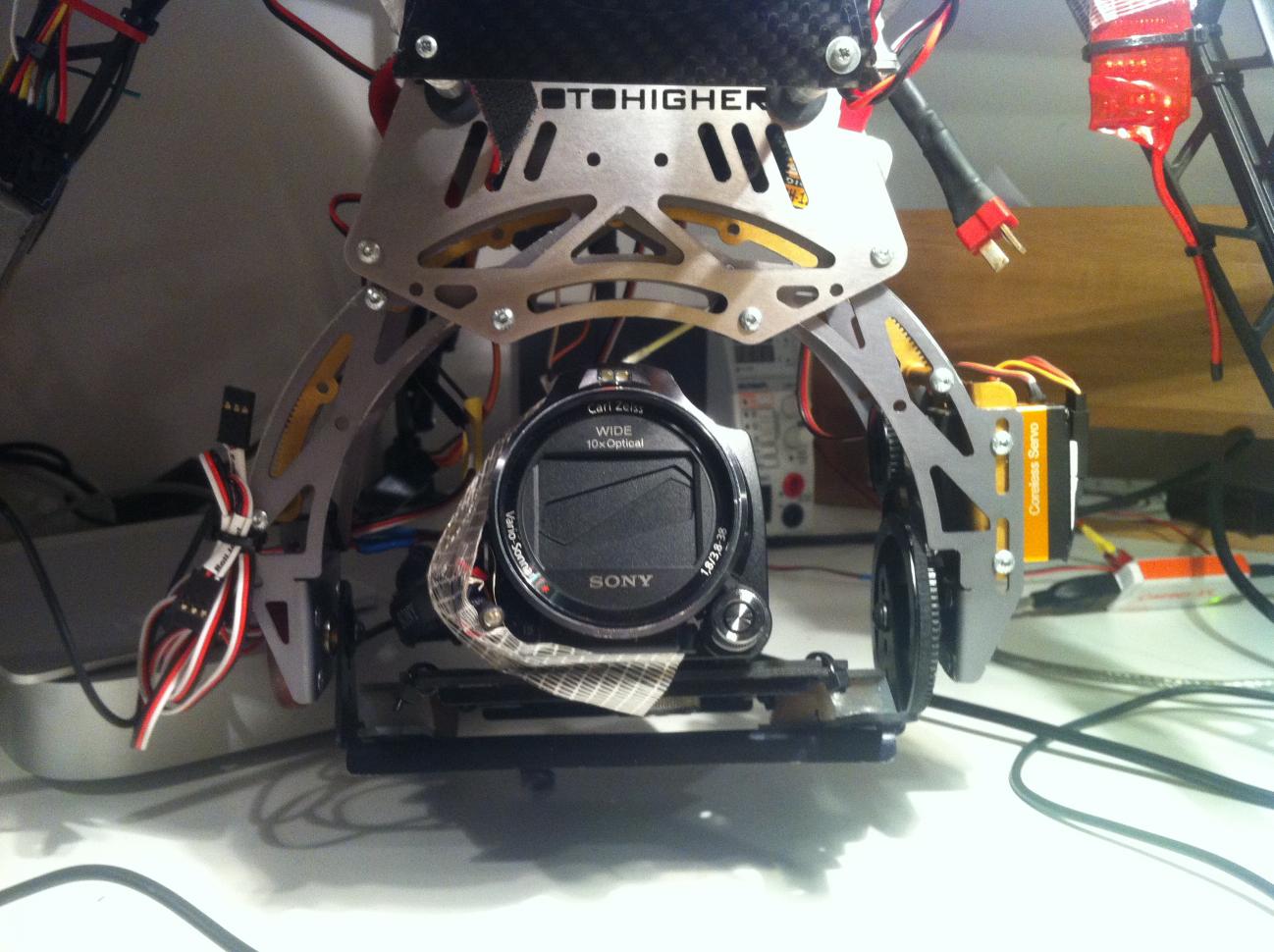

diaconescu
with a compact camera without objective or gopro2 stabilization is ok but cx730 or nex7 oscillations appear on tilt. RSGS not deal well with av130 while the AV200 is good. I think the problem is mechanical av130 CG is very sensitive because of the small size.
Michael64
My skyline acts the same way small camera no problem move to GH2 oscillation on pitch start really nothing to do to stop them. I thought I might have a bad skyline but now you say you acts the same way most be in the skyline coming from absence of the pot on pitch I guess.
Michael64
pixvertex
I have no problems with a 150 tilt gain and 700 gain on roll on a av130 with a Sony 730. I use also gel dampers for the cam. Firmware 1.2.2 and dummy pots.
Michael64
Which version of the Skyline do you have mine was 1.2 and got the jitter problems. You may know but if not look right above the connector on the skyline it will tell the version.
Michael64
pixvertex
I use the offical 1.2.2 Actually i modified what needs to be done for the loom and i made the dummy potis.
The camera is mounted on a gel mount. But actually these normally makes thing even worse.
1.2.2 is light years better than 1.6. I even powered 1.6 with 3 power sources.
Now everything is powered with one 6v switching bec from staufenbiel around 20 euros.
Wanted to make a test flight today but i had no time ... Grüße micha
btw. check your belt on the tilt if it aligned tight !
View attachment 6320 View attachment 6321
