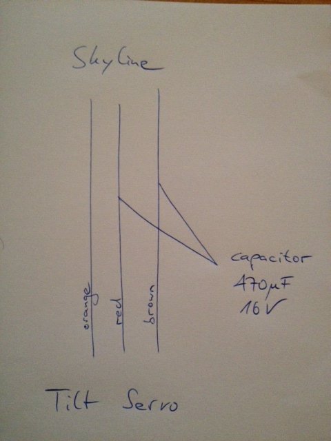

My problem is that I have to put the tray in the lowest position to be able to operate the CX730 and then when I tilt it the camera is front heavy, the tilt servo has to fight against it and it jitters.
I tried to put a capacitor in front of the tilt servo, without success...
I also use a felt washer.
And I use 1.2.2 with the new cable connections and the dummy pots.
So... does anyone have a working skyline with AV130&CX730 which is jitter free at any tilt angles?

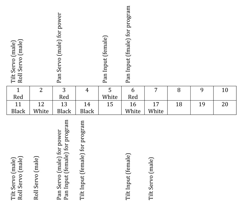

So they removed the power from Pan servo? they had that in 1.1.6, so I can remove the pan servo cables and adding roll input(without white) to power the skyline?
So they removed the power from Pan servo? they had that in 1.1.6, so I can remove the pan servo cables and adding roll input (without red) to power the skyline?
Hold on, hold on. We'll have that wiring diagram in an hour or so. Don't break anything trying.
Also, don't use any FW other than what's on the website with the new wiring changes. If you make the wiring changes and then try fW1.1.6 (lets say), the Skyline will exhibit some very creative (yet unpleasant) behaviour.
swalas
I was planing on using the new FW, but I just thought that the skyline still got power from the pan servo, I can easily add the roll input and get power from that if that is preferred, BUT when using a power source not connected to the flight controls(witch is recommended), the power source uses female connectors not male that is required whit the roll input cable, that is electrics 1o1..
