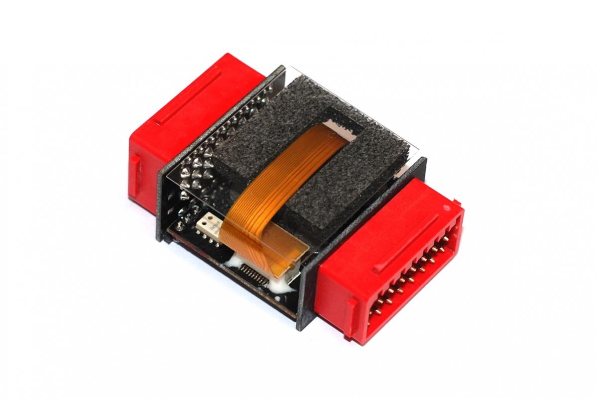

DennyR: Sorry if this is off-topic but I am going to assemble my S800 today with the AV200 and the RSGS unit as I mentioned earlier. When I mount my WKM IMU and MC how would you recommend that I do this? Would it be beneficial to use servo gel on one or both of them... or should I stick with foam tape (no pun intended)... or just use the double stick paper (no padding) sort of tape? Thanks.
The MC and IMU should only be stuck with the supplied gummed paper. the dedicated soft mounting is inside the cases. Do make sure that the IMU has clearance around the top frame cut out.

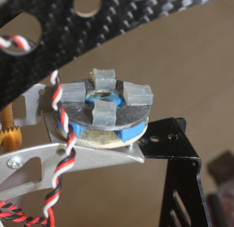

Rotary Damper: I mentioned a few days ago that I was waiting for some parts to test an idea as it would apply to the jitters in pitch movement on the AV200 gimbal that I have my RSGS attached to. The parts came approximately an hour ago and I no longer have any jitter as this did exactly as I had hoped it would. The odd yellow attachment method that you see is just a couple of wire ties that I used temporarily to test my idea prior to making a proper mount or drilling a couple of tiny holes to hold the rotary damper down with. I will attach a couple of pictures below. This is of course located on the opposite side of the RSGS. I just got creative with a longer screw from the inside pointing OUT, filed a couple of flat sides on the end of that screw so that my set-screws has something flat to lock onto and that was it. The only other detail is the take the flanged bushing that they have and reverse it.
It Works!
View attachment 5547 View attachment 5548
I will shoot some video in the days to come and will get it posted at that time. I hope that this will help some of you.

That's very interesting! Do you mind provides us the source for that damper?
That's the problem, for the moment. I used one from an inexpensive Chinese gimbal that I had laying around to test this idea and it worked great. I am trying to find a supplier to provide me with several different ones in a range of resistance so that I can choose one and then share my findings. I am very happy with the results and the advantage (over creating friction with washers, etc.) is that once you find the right resistance it remains that way wereas just creating friction can change with wear and time. I will get to bottom of this this and share it with everyone as soon as I know more.

You have to provide a vibration dampening between the pitch shaft and the IMU. NOT the shaft and the frame otherwise the imu will not control the movement correctly. The shaft must remain free to move and be mass balanced or it will not work. killing the jitter by holding the shaft is not the way to do it. You have kill the jitter at the source of the problem which is incorrect gyro mounting.
If you strap down the pitch shaft, how can it possibly move in small increments. It will stay put until it overcomes the friction and then jump.
It is a known fact that a high sensitivity gyro setting is required to stabilize a camera, the trade off, is that it will be sensitive to all other movements including its own feedback if it is not mounted correctly. A pid algorithm cannot deal with bad mounting if it is to maintain it's designed sensitivity level.
Also once the imu has been mounted correctly it will have some small amount of free play in which to move against any vibration. This makes it sensitive to any loose wires etc. that are attached to it. These must be strapped down to the same base or removed as even a very small movement will produce an unwanted reaction at the camera.

Take a look at just about every tail rotor gyro. they are usually supplied with an interim vibration absorbing plate that is sandwiched between the base and the gyro. the size and densities of the materials used are based on test results to determine the optimum characteristics. If you want to strap down your shaft in the belief that it will increase your servo deadband then go ahead my friend. If you want to destroy the resolution of the IMU then that is how to do it.
Why do you think that the Zen is almost friction free in all three axis. Why do you think that pro systems such as Cineflex run in air bearings. Friction and poor balance = loss of resolution and response time.
Those oil dampers that you mention are to reduce the airframe vibration getting to the camera mount. they would serve that purpose even if the mount had no stabilization movements at all. They are what is termed first stage vibration supression

A/ mount the skyline on a servo plate with gyro gel mount between servo plate and skyline.
B/ use the H loom
C/ Control that you don't have any mechanical play in your gimbal AND servo. Otherwise, remove this mechanical play.
D/ use a small washer of plastics or nylon or other stuff that will create a little friction between tilt servo and gimbal
Hope you wil find this helpfull ;)

Isn't it the same solution ? plcing the skyline on a small flange and glue it with Gyro gel like Khyosho ?
This mod has been described very early if I remenber well but effectively it's a good solution.
It's interesting to see that this solution (flange + gyro gel) has been found on french and US board nearly at the same time :)

OK, I understand (I think), but the RSGS is reading the angle of the moving frame while on the moving frame. Its giving the signal back to the servo and the servo adjusts the tray accordingly.... Dampened or not, the RSGS is measuring the angle. Which comes first, the chicken or the egg? I thought the dampening would only make the servo work a little harder (small force). Could you please explain to me how my understanding is incorrect?
OK what you have failed to understand is that the IMU measures the angle relative to it's movement in space, it applies a correction signal that must not be corrupted by any other source if it is to point the drive system in the desired position. If you place external loads on the servo that interfere with the PID algorithm it will not return the correct resolution. i.e. it will keep jumping from one position to another. The pid algorithm controls how fast the servo starts and slows down as it approaches its final position it does not know how to handle a friction brake. This is all irrelevant until you understand the reason behind mass balancing. Newtons third law as I recall.
