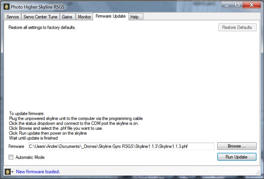

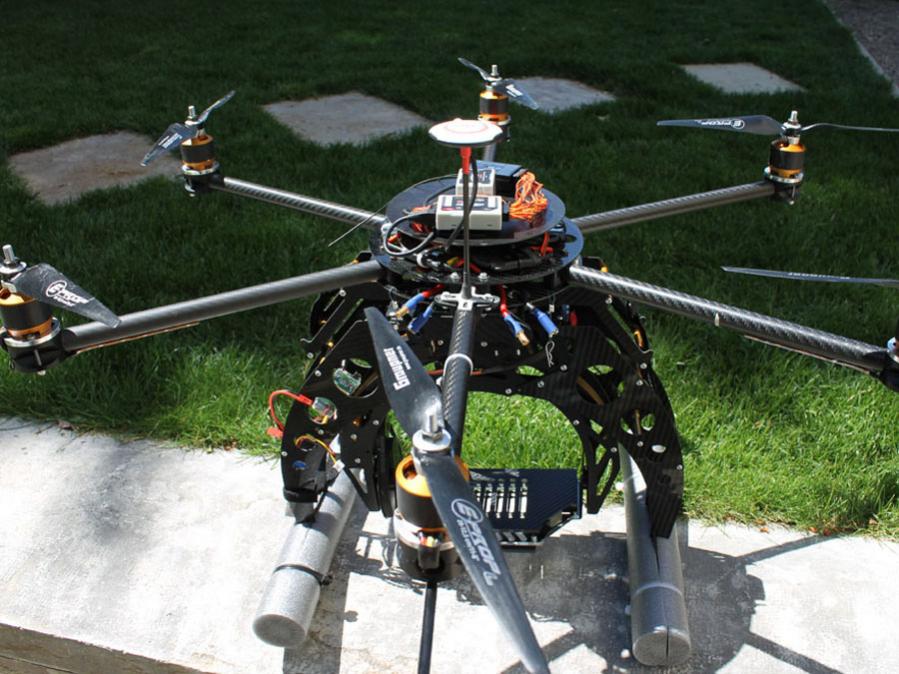

With my skyline monted on a AV130, with pan gain to zero, if I rotate my hexa manually, I can see the roll is moving....
Take a look at the screw at the center; version is 1.1.3.
http://www.youtube.com/watch?v=ipLq5DYR1tw

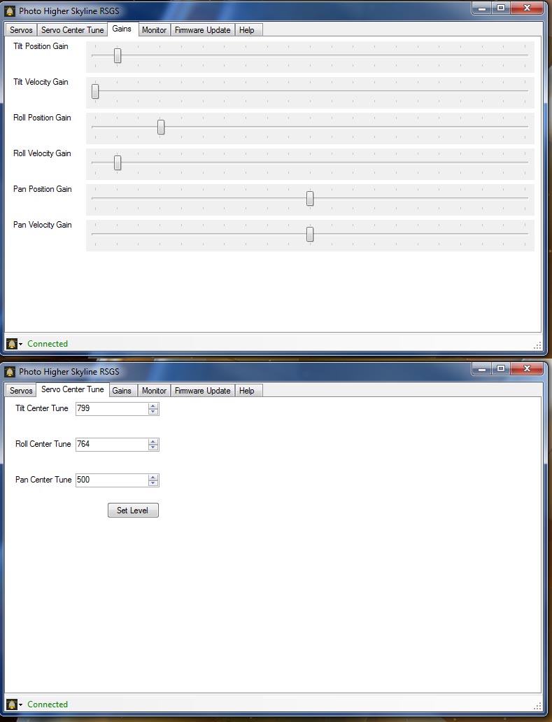

I am trying to play with the tilt center servo but no success.. The tilt servo trembles and goes anticlockwise eventually its compensating. ROLL is perfect !!
Did NYBODY EXPERIENCE TESE ISSUES

MultiHexa
You can tilt in the software set to reverse.
Gain Tilt postion shall not be set too high, otherwise begins Tilt to shake itself.
More tips I did not.
We will probably have to wait for the new firmware and hope that everything runs clean.
About the gain velocity: it's described in the manual: this is a dampening parameter: the more your push it, the bigger the dampening on camera control will be.
So use it wisely to "remove" vibrations problems.
