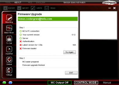

I am losing patience with this. I uploaded the new stuff and crashed my Octo for the firat time.
Now I am trying to "upgrade" to 5.12a and it will not accept: something like "authentication" failed, wrong software.
How TF do I downgrade to something that works? Anyone know? Earlier versions are just not there.

Did you try the upgrade with the new1.30a Assistant software ?

Chris, I have the same problem:
And I am using the newly installed Assistant sw 1.30a. :upset:
