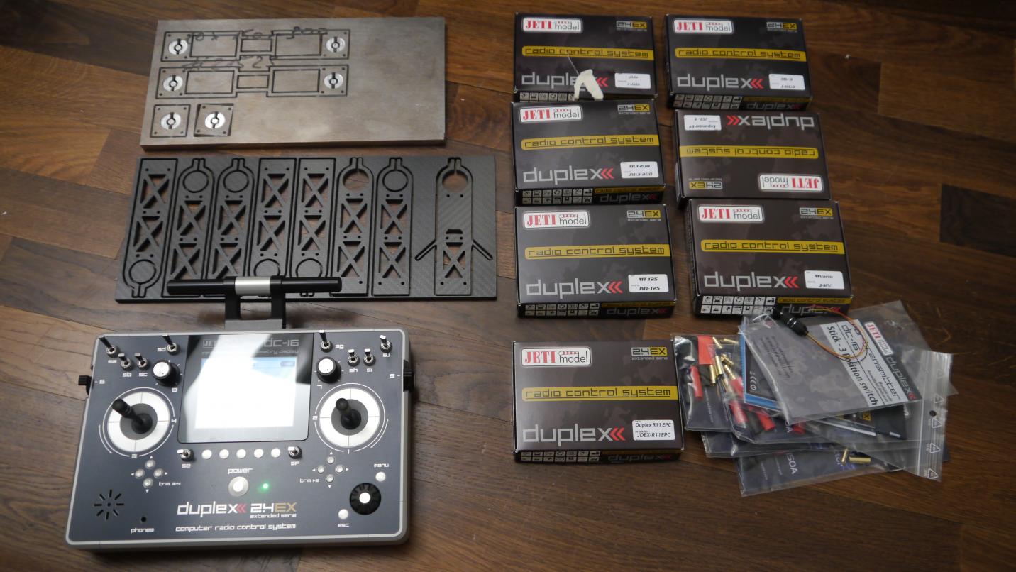

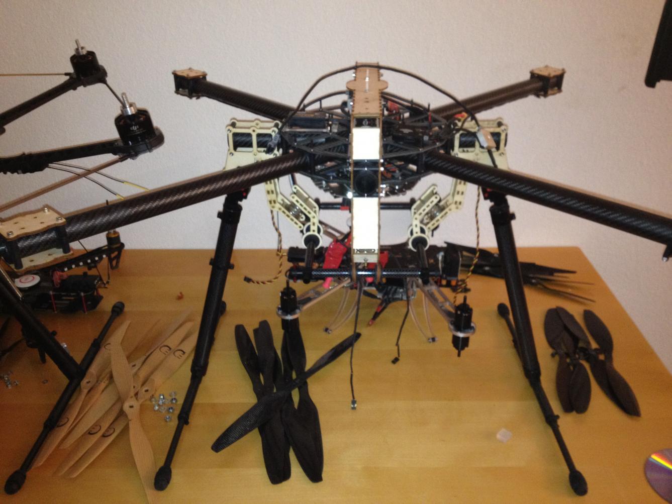

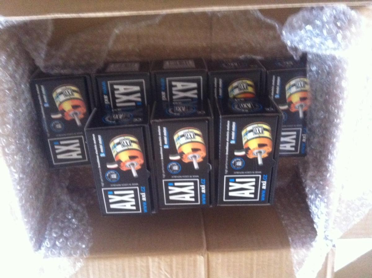

finally all the parts to finish the build :)
Christmas today already for me !

Boris Send this Santa to me too please.
Japp the DC 16 is really amazing just love the menu. No restriction can't do this or that this switch only for that, like usual, just clever programming and best design I have seen up to now. But it would be cooler if they wouldn't have put on the duplex 2.4 writing that big. Kills the design a little.

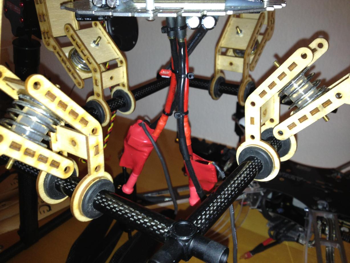

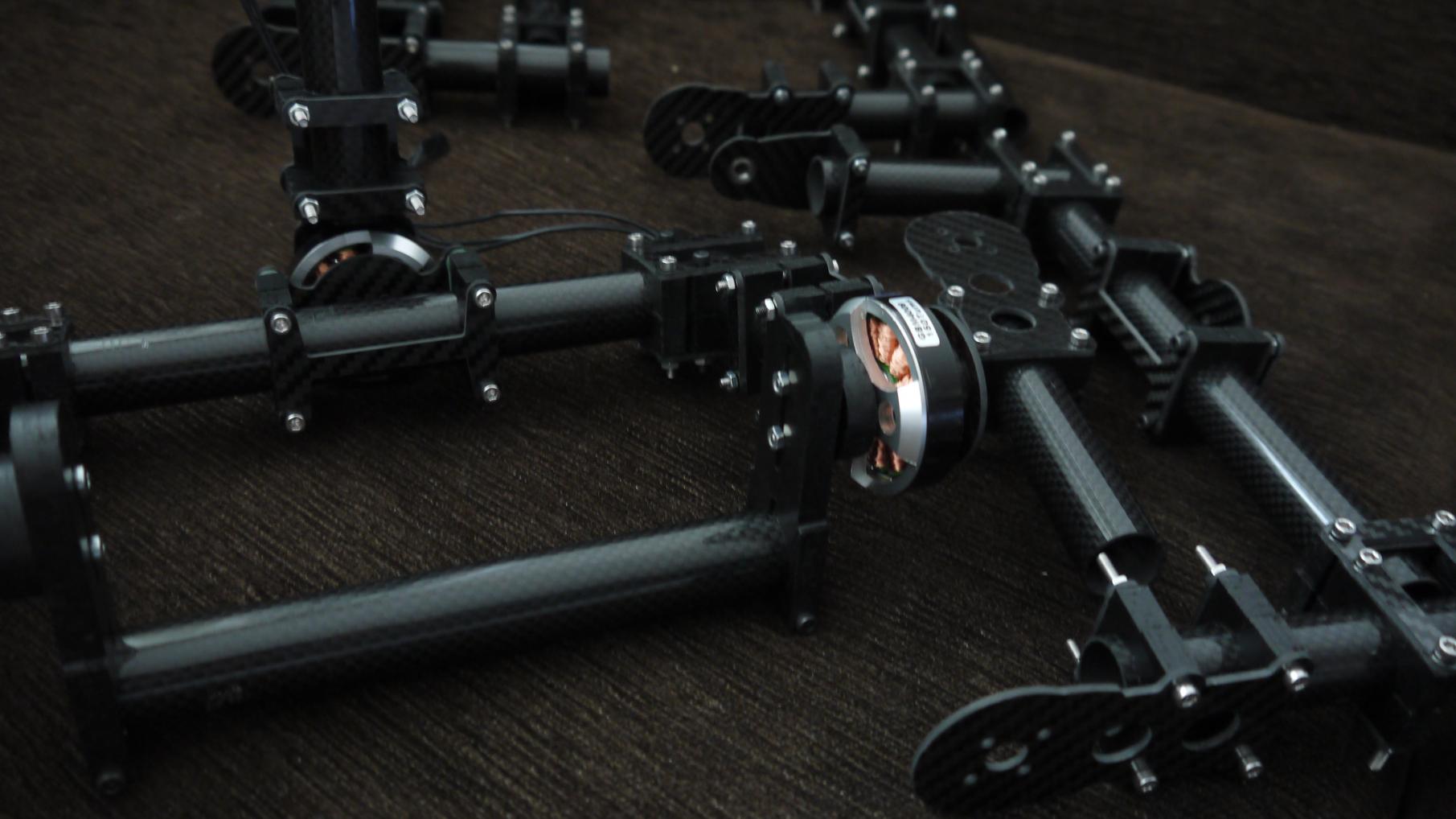

Bird is getting bigger than thought :) but i guess it will visually smaller once the carbon tubes are cut for the holders. Enouggh space for 4x 10000 6s :) All on the Landinggear hope it has the vibration reduction effect i am hoping for !

BorisS
japp ! I have the possibility now to take of the Landinggear since it attached with the s800 method of these 6 hand screws things.
But you are right for the zenmuse these are very good ! was eyeing them yesterday already

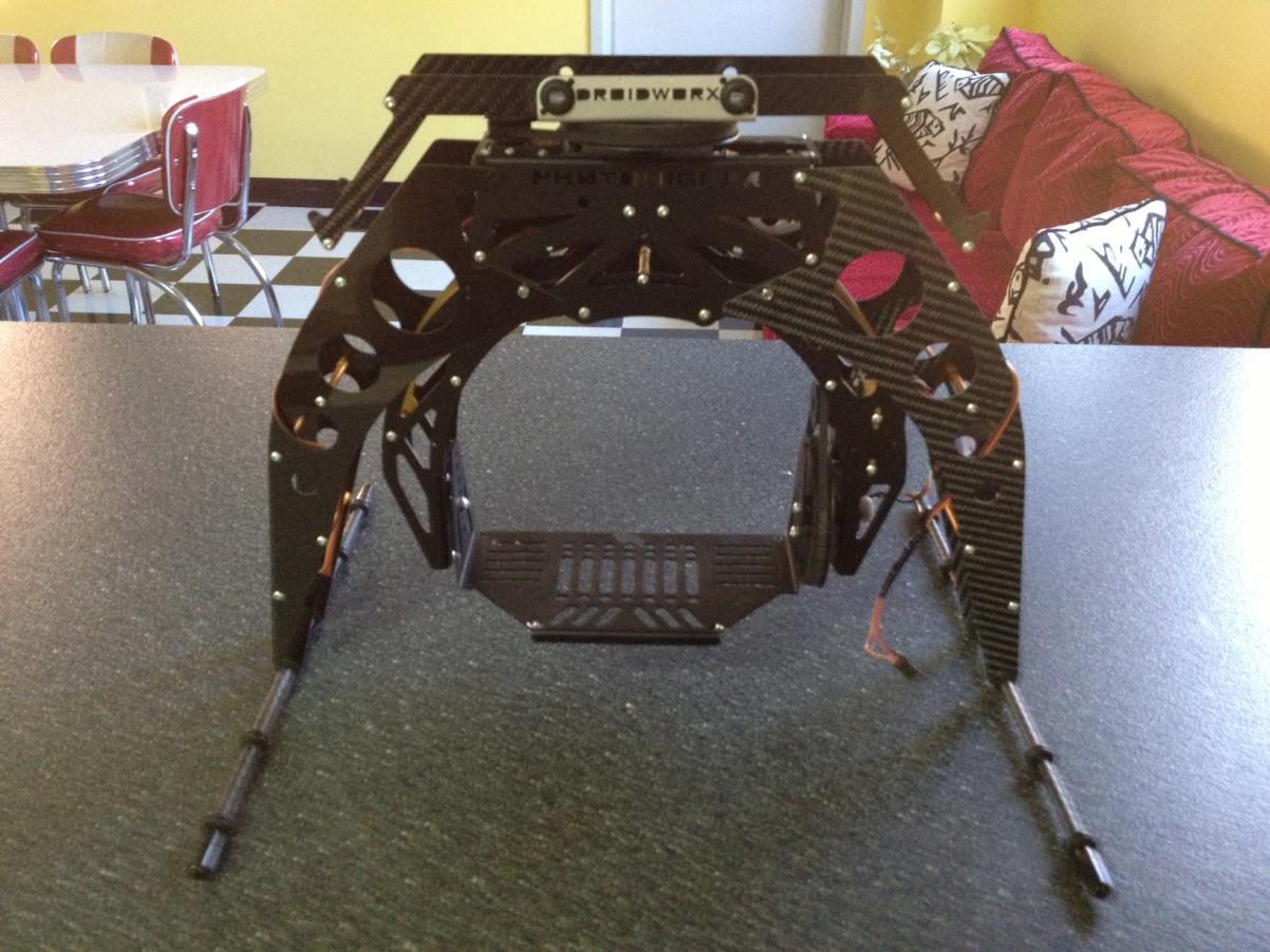

BorisS
so slowly finishing up the build parts finally went out to the water jet cutter machine, Decided to use that instead of a cnc.
View attachment 9612View attachment 9613View attachment 9614
at the moment setup for the zemuse gh3 modded.
Lets see if the vibration mounts work otherwise I have other ones in the works. Once the 3d printer is here they should be easy to produce in house.

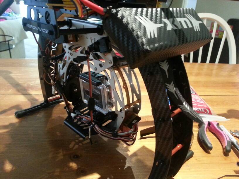

MombasaFlash
Heli's & Tele's bloke
so slowly finishing up the build parts ....QUOTE]

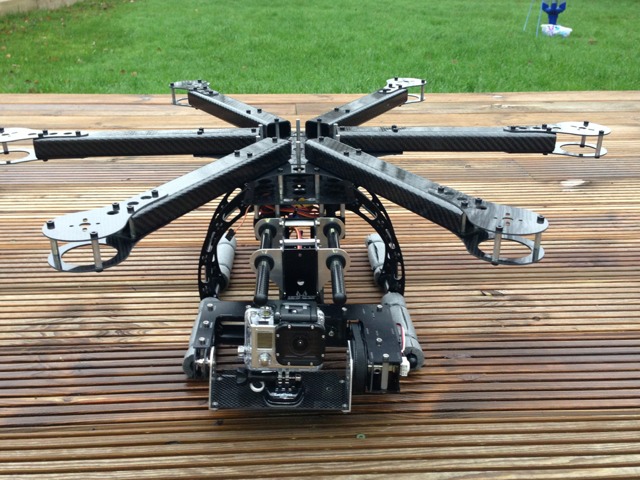

Hi Boris,
Have you actually flown yet with those Secraft v3 Pro retracts? The design is plainly far superior to the v1/v2 but I am still not happy with them. The vibration that is introduced to the whole airframe as a result of the small amount of play in the hinges is really just an amplification of existing vibes, but it becomes a problem because it gets through to the Zenmuse. The Zenmuse can handle standard vibrations but not these amplified ones. I even had one leg collapse on the table (right onto my bloody cell phone screen and the Zenmuse!). It is important to limit servo travel to avoid this.
Another big minus point is their tendency to occasionally operate upon power up. Not good when still on the ground. Because of this I had to install a small extension so that the retract servos could be connected AFTER the rest of the radio and MR was powered up, but extra little procedures like this are not needed when you are busy with a job. It is the sort of thing that can get forgotten until suddenly the whole airframe collapses onto the camera mount during a power up and the day's filming is over !
