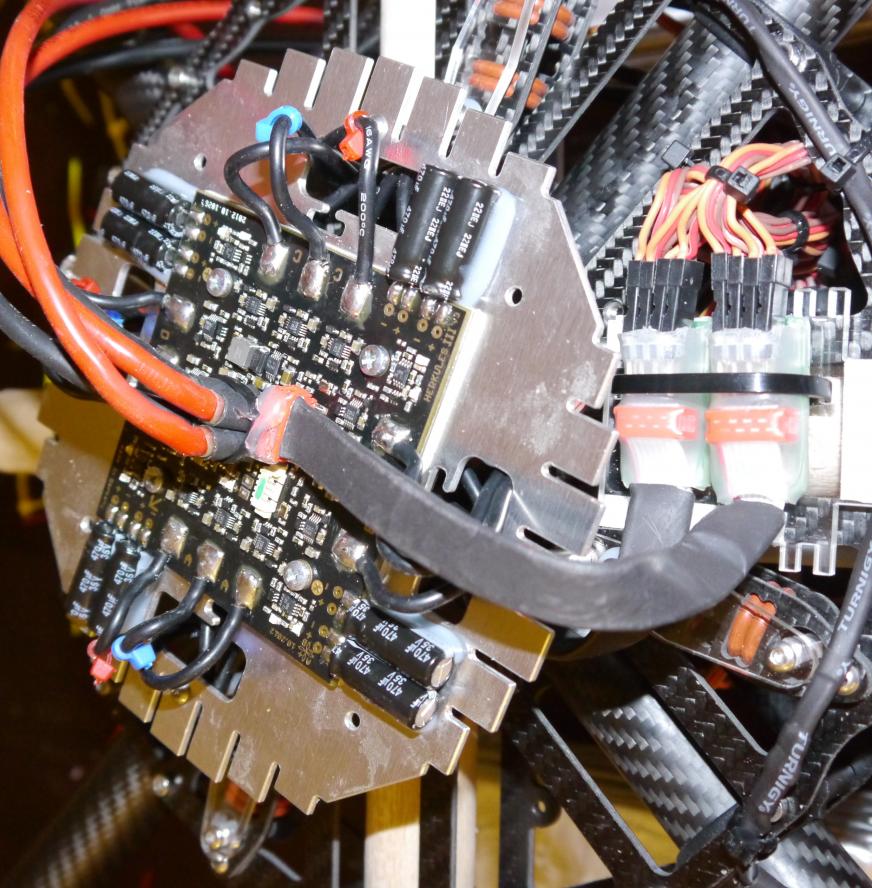

Okay started with the placement of the WKM components and installing the Herks with the ribon cable and the micro match to servo plug converter.
Since the herks are placed under the center plate the ribbon cables are a bit long. I shielded them with cat 7 foil. Micromatch plug in the herks
are hot glued in case some vibs hit the boards and cause the micro match plugs to loosen. Elkos like said fixated with silicon.
Hmm parts are dirty think time for a cleaning session.

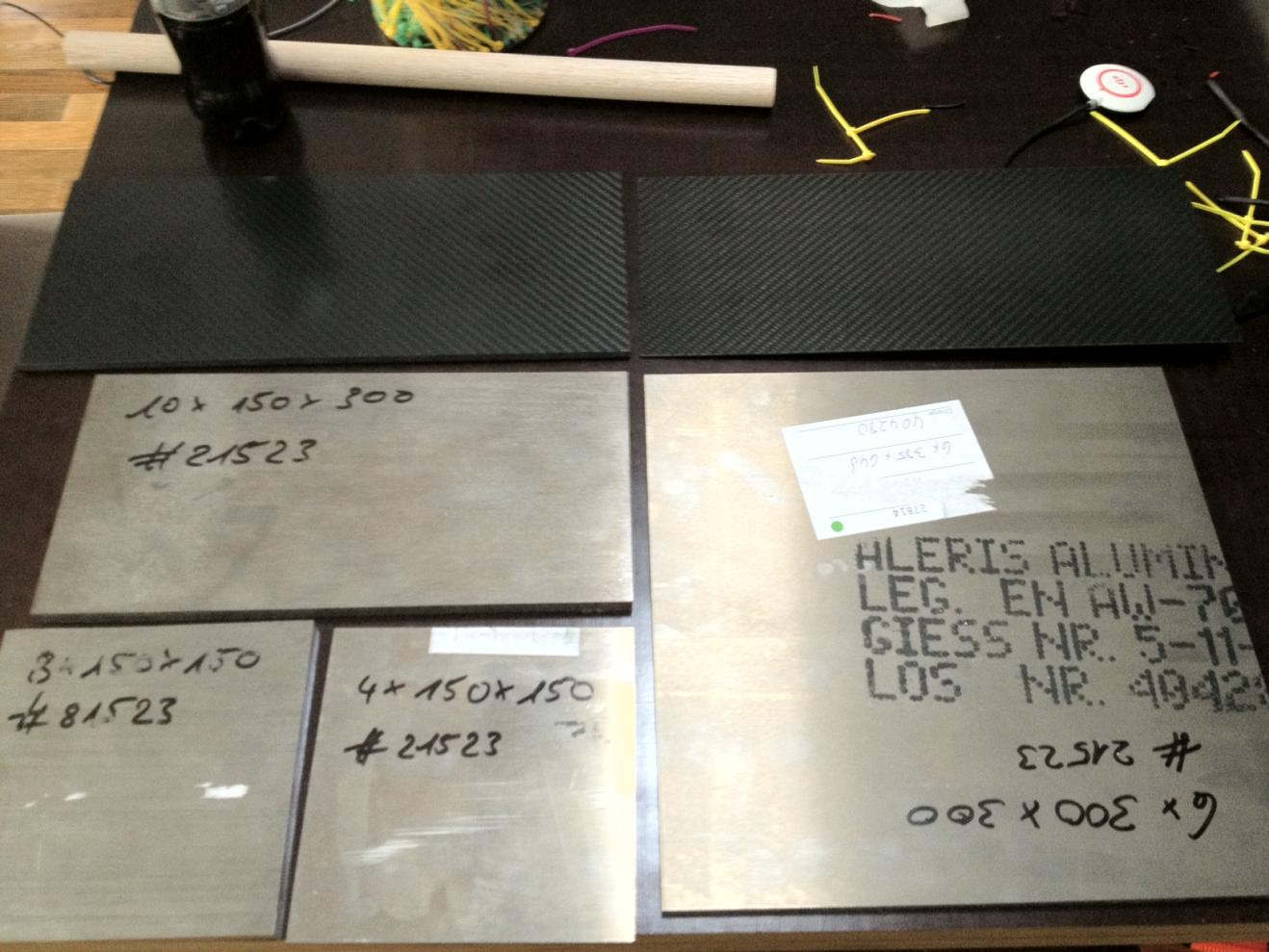

At least the material for the made parts arrived :) This 6mm carbon plate is massive ! :)

:) close to a spaceship I guess :) No only for the holders on the side the adapters for the s800 landdingear and Zenmuse.
