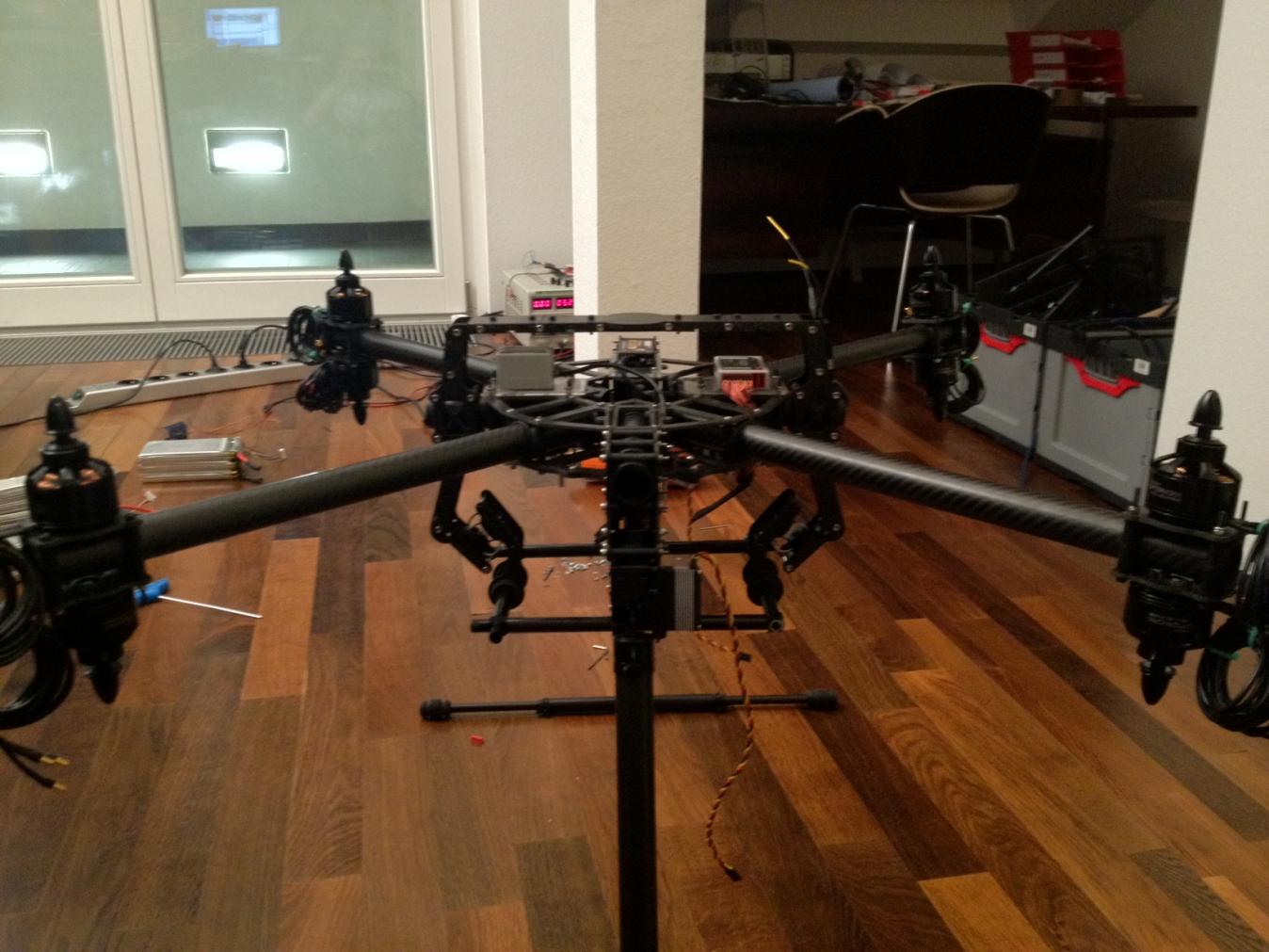

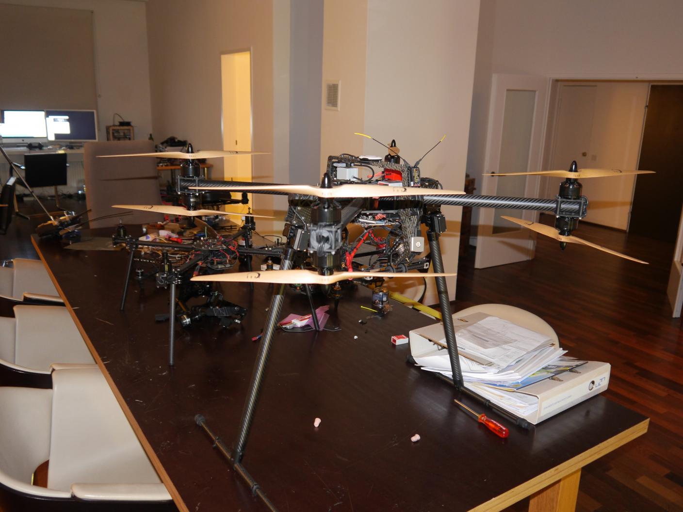

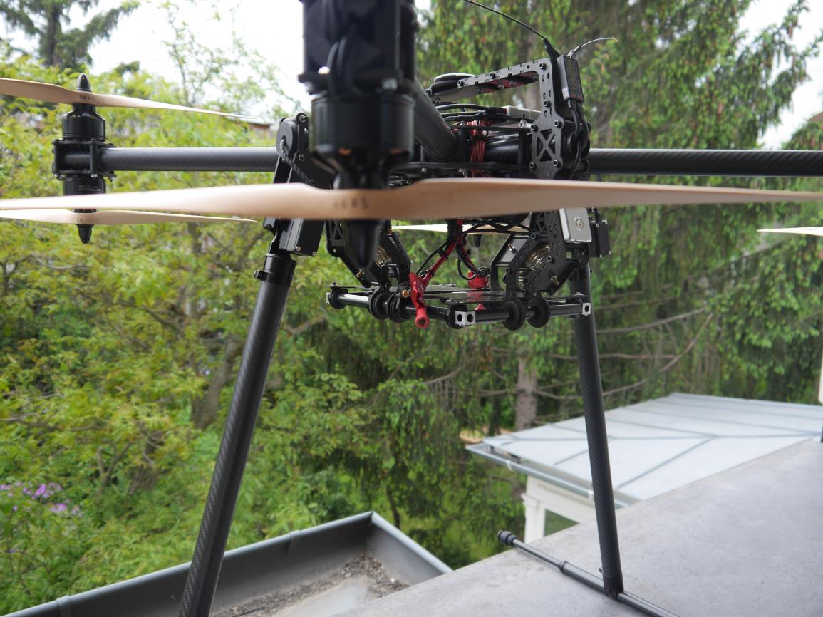

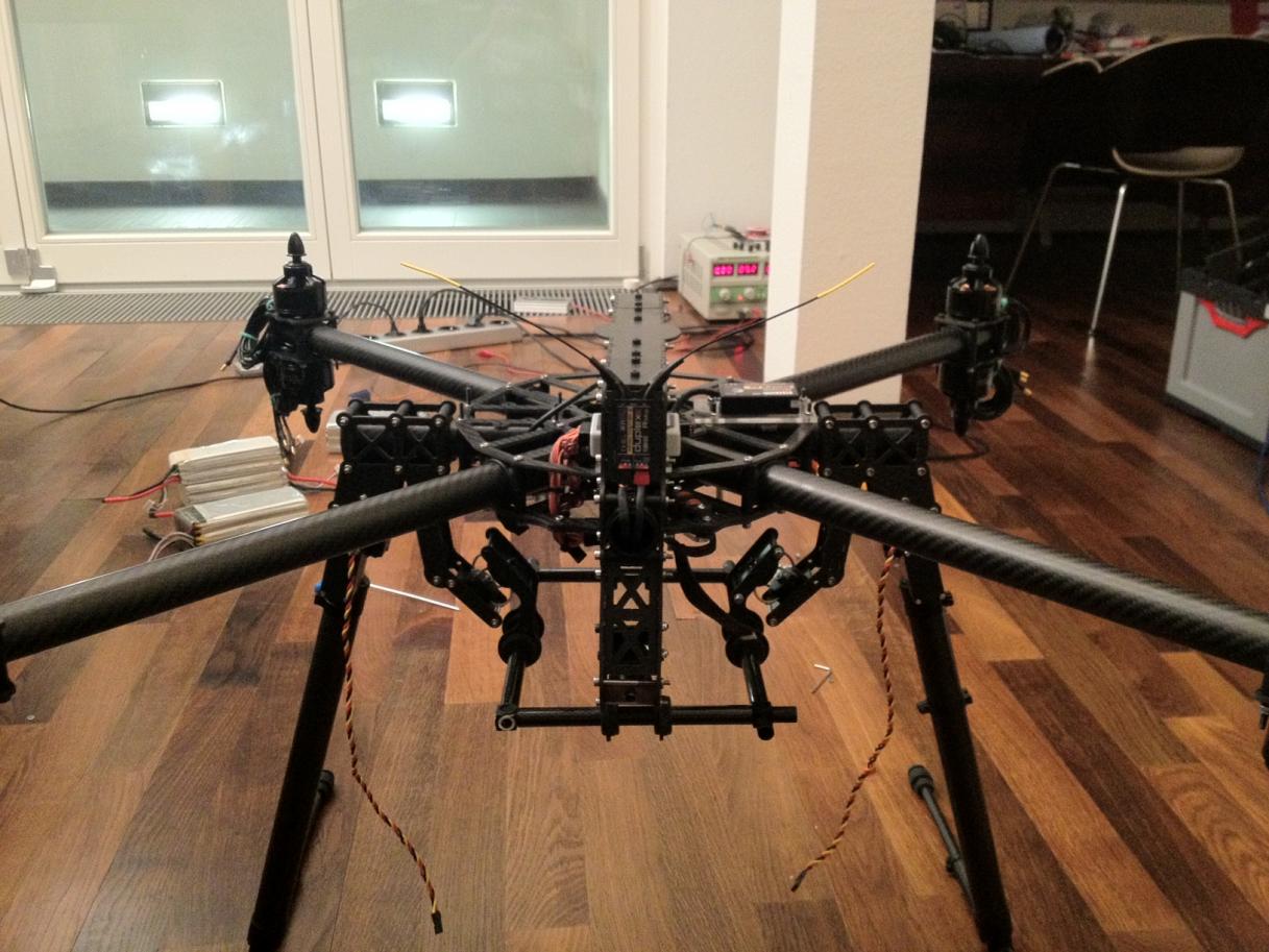

Finally have all my carbon parts, the parts suck though. Getting them but from the water jet guy wasn't a good idea :(
View attachment 9992View attachment 9993View attachment 9994View attachment 9995
3d printed vibration isolations thingis seem to work nicely up to now lets see them once put to the test. End of this week i think it will be finally in the air !

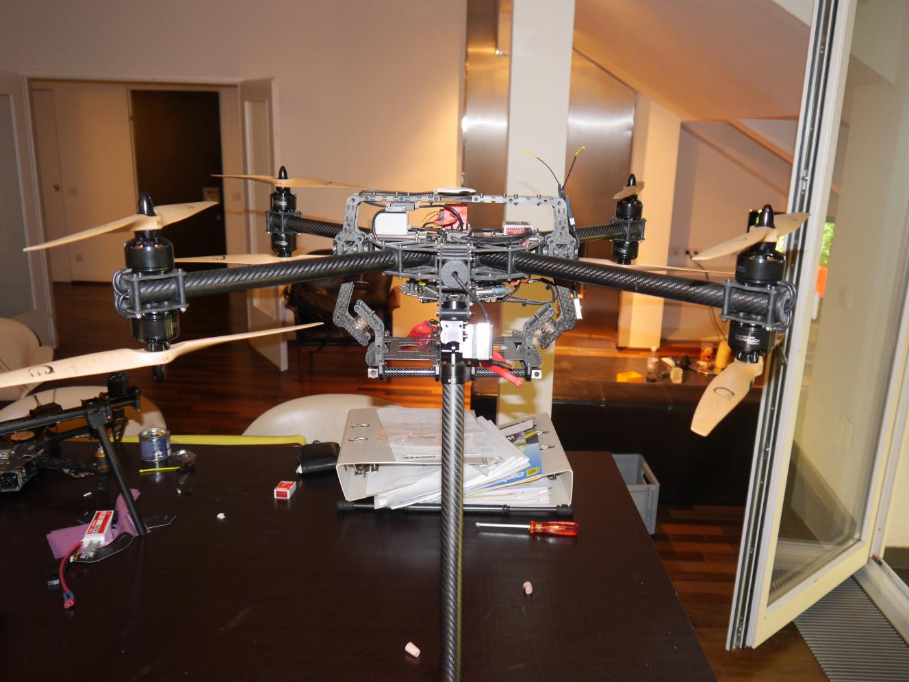

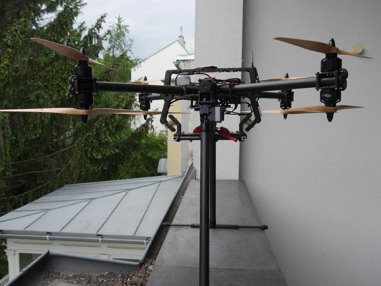

Looking at the pics of your X8 I am wondering what advantages that particular configuration holds over the flat eight. I see the wind cutting advantage but not much else. The weight saving of four carbon booms is not significant and it does not strike me as being overly AP friendly because the lower front props will restrict upwards gimbal tilt. Motor redundancy will be maintained but overall lifting grunt will be slightly reduced.
Do the lower props spin in the opposite to, or the same direction as the top props? If they are opposite, does this induce a degree of vibration cancellation?

@ mombassa. The only reason why I went for an x8 config is because of the size (wanna have the option of 16 17 inch props without going over 100 cm diameter) and I heard from several that x8 in combo with wkm performs a lot better than a flat wkm octo. There is no other advantage over a flat octo. The weight safed is lost again by the low props being in the wash of the upper props.
Concerning seecraft think I will just build in a remote relay or a normal 5a remote switch should work. Two switches on the radio one to activate the circuit and another one to operate the retrace. With some additonal function in the radio that it can only be activated at a certain throttle level.
Japp top spin left bottom right so actually they all spin in the same direction ! Vibration cancelation I can't say

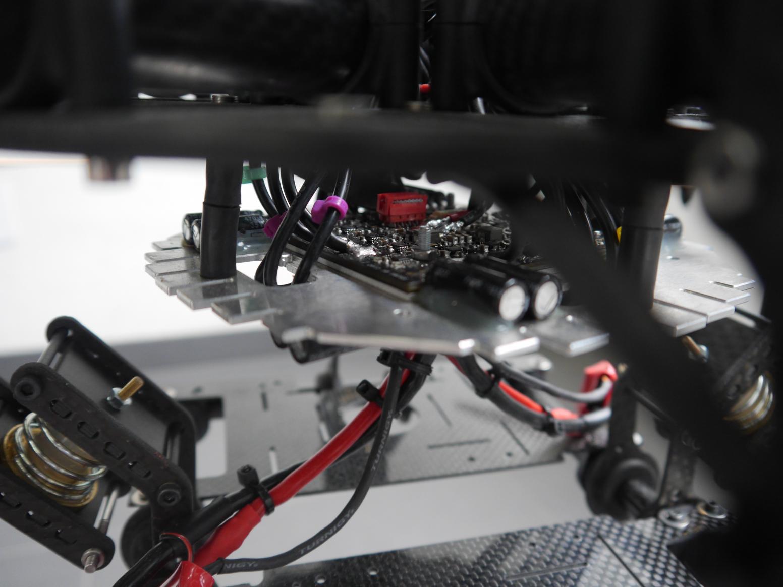

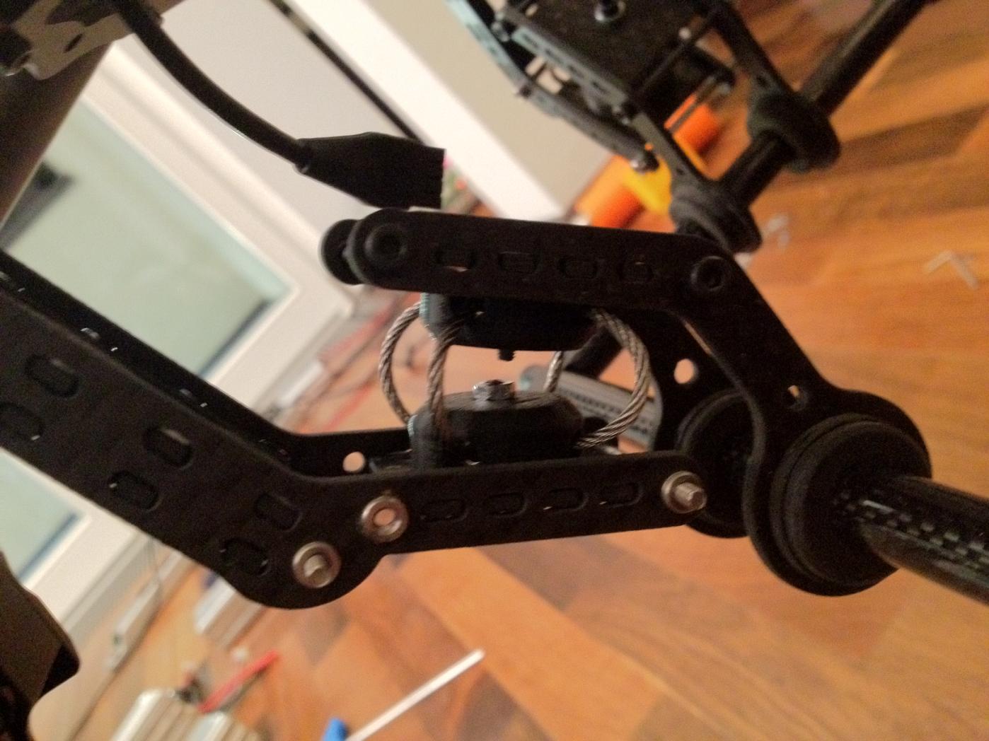

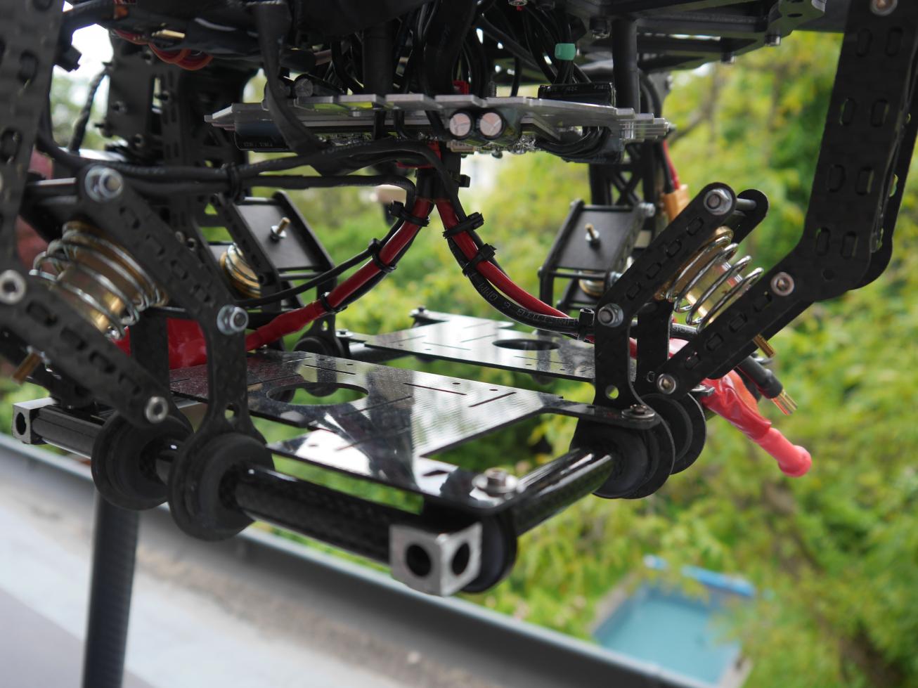

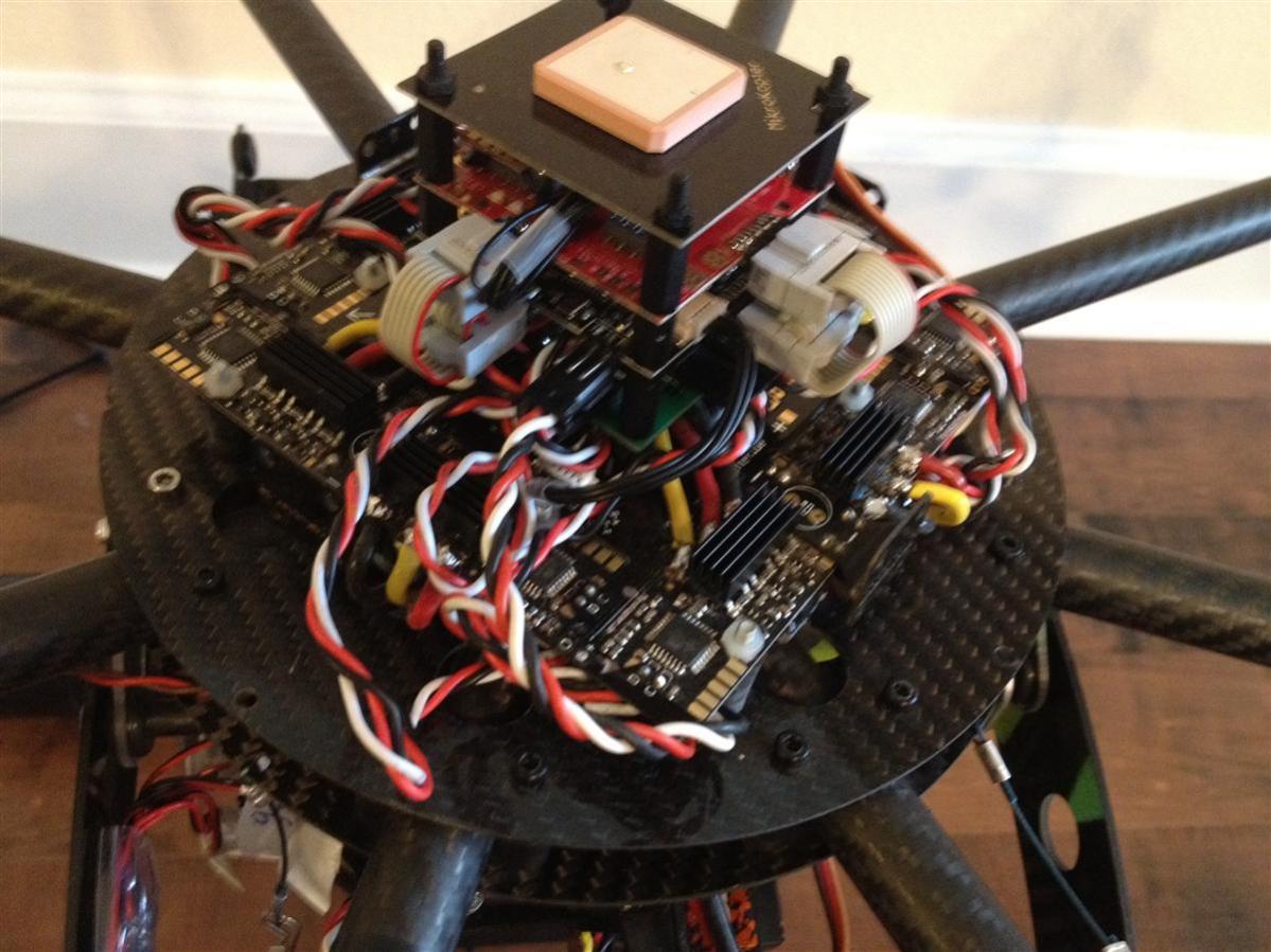

I am liking the assembly Boris. Nice and clean with none that horrible ugly mess of wires, insulating tape and tie-wraps with ESC's hanging off every boom that many seem to be satisfied with.

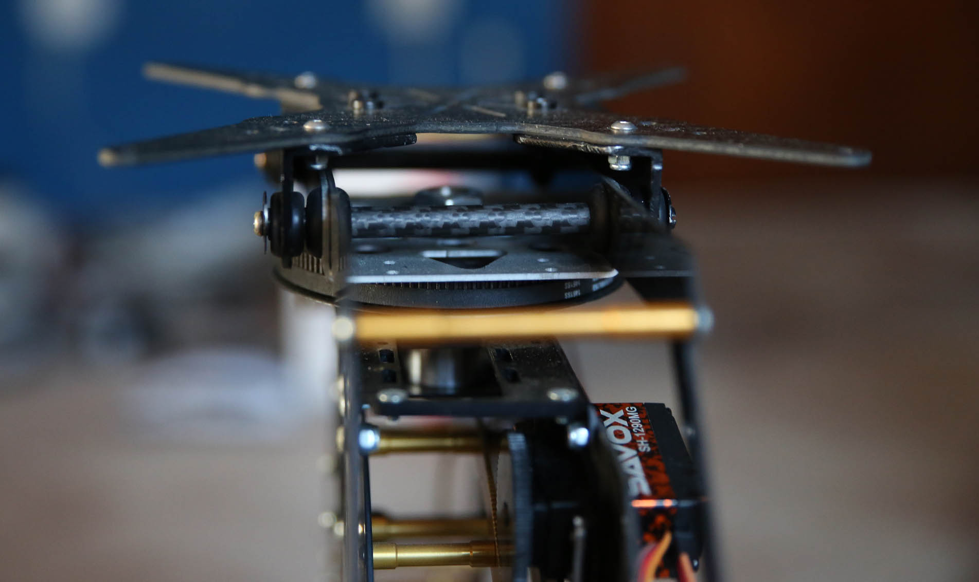

I am curious how those twin-spring mount dampers will fare. The Longitudinal (X) Roll axis is well supported with them being at an angle but I would like to see if they cope with the Lateral (Y) Tilt axis. I had first assumed that there were four of these angled spring dampers but a few photos later I realised there are only two.
Do you have the Hercules ll or lll in there?
BorisS
Mombasa, sorry the pics are crap ! There are four of them. The pictures below should show it better :
View attachment 11610View attachment 11611View attachment 11612View attachment 11613 View attachment 11614
I am using the Herks III, still have three boards of the Herk II in my setups with no problems. But for HL setups for sure the Version III is the way to go !

(edit) I had a gopro hard mounted on the clean zone and had no vibrations. Im gonna do some more test before I am going to mount the Zenmuse though just to go sure and i can finally say what they are worth those isolators. They are not cheap though think around 70 $ a piece. I have selfmade ones though from the 3d printer that i am also gonna test based on wire dampening.

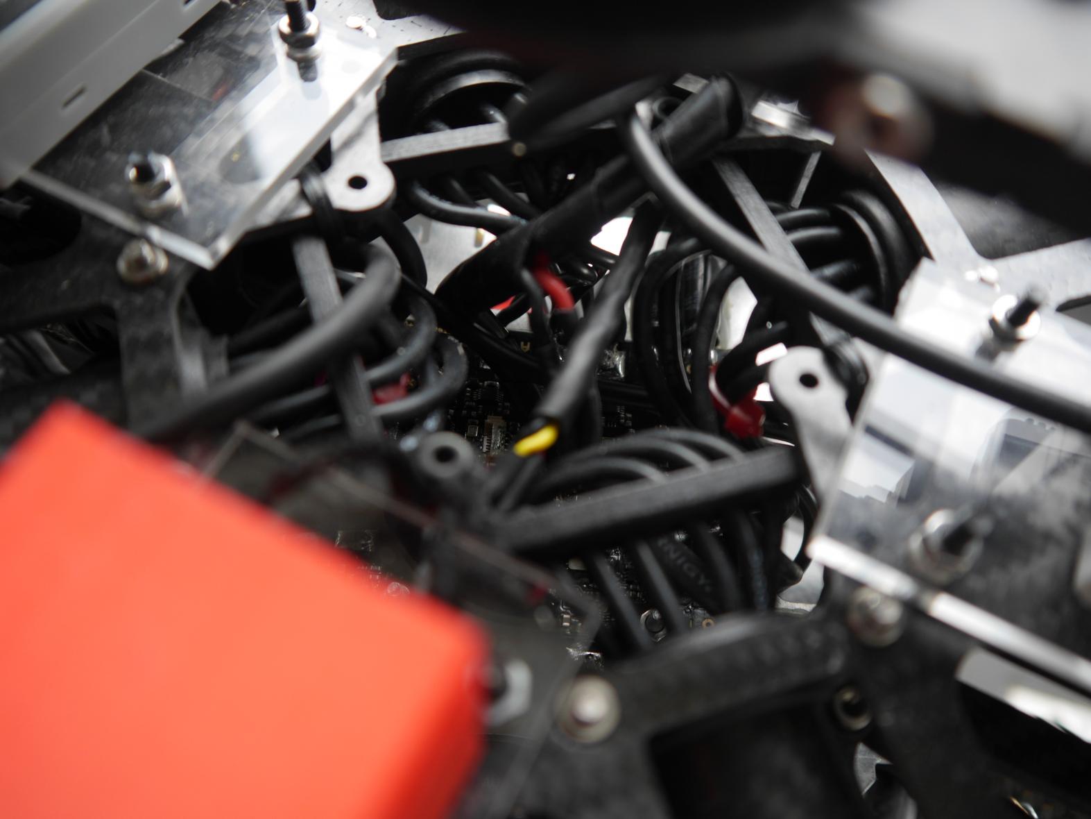

Motor wires routed from the boom through this little plastic holder construction so no shrink wrap need protect them from the edges of the carbon tubes.
All motorwires are soldered on directly to the Herks. Didnt want additional connectors, just another spot were something can go wrong.
