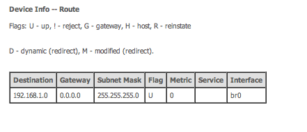

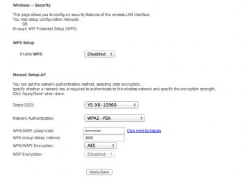

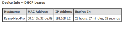

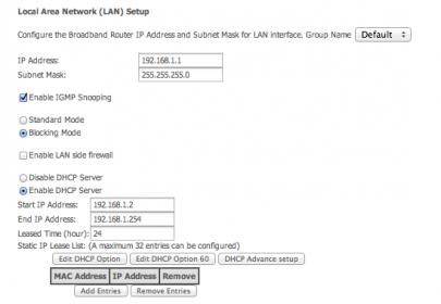

robone
Let start and get the router working 1st. It is the easiest way to do it.
Let is check that you have set up the router properly. Tell us the SSID and the ip address and the range of the DHCP allocated addresses and what make it is.
Sorry about that Its a NetComm ADSL2+Wifi N300 .
Not very good just a spare one I had. Do you want me upload larger images?
Where should the DHCP range start and end? I notice it starts at 192.168.1.2, even tho the ssid is 192.168.1.1.
Is this normal?
