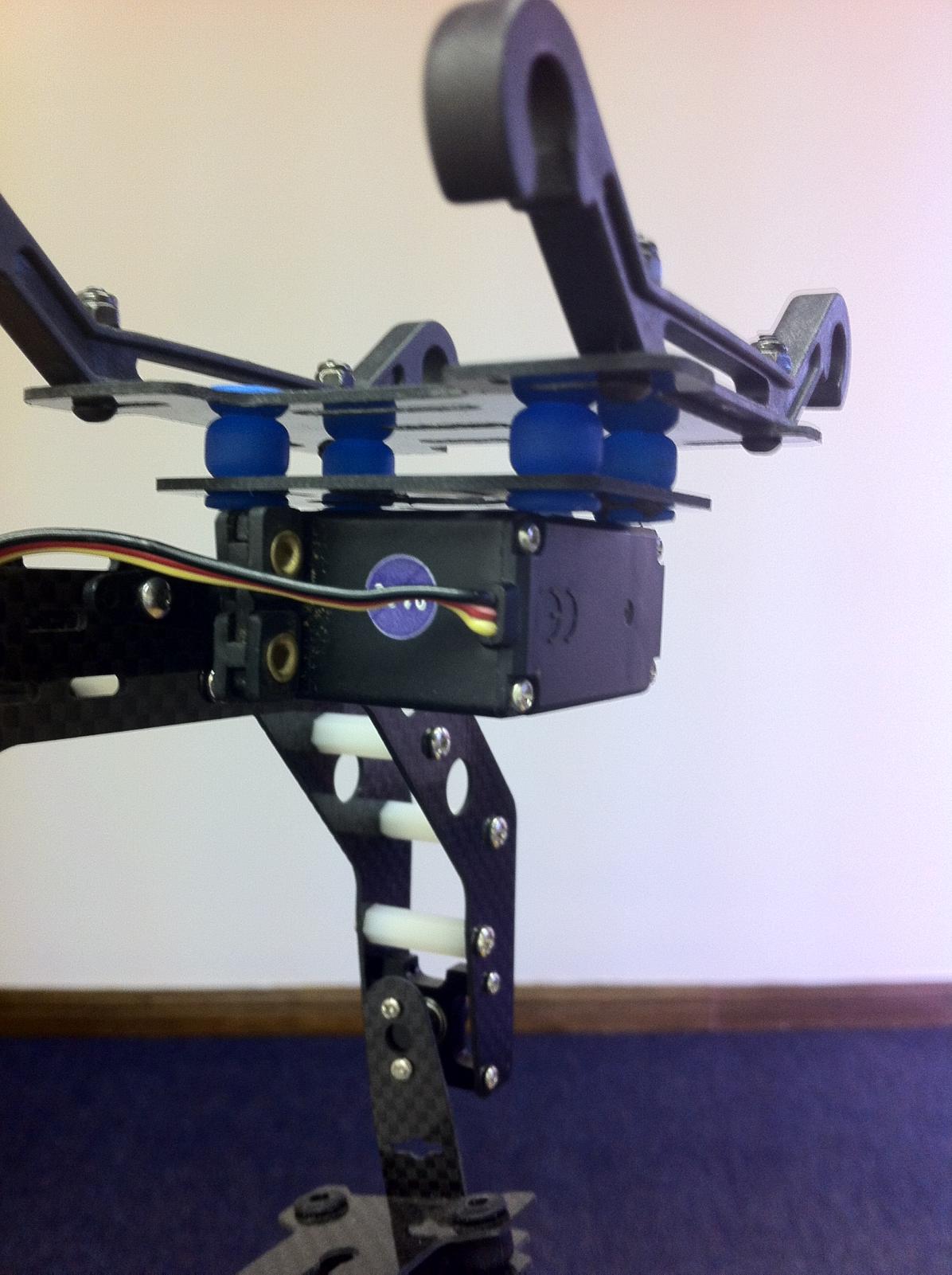

Gimbal Servo Installation
Hi Guys,
I am new to to the thread.
I have been playing with Rc planes and helicopters for 12 odd years but Multirotors are new to me.
I am busy installing the YS-X6 system to a Bumblebee Quad. The Bumble bee has a tilt enabled camera mount that I am adding a pan axis to. (See the attached photo's). I will be using a GP H3 camera.
Now my questions:
1. Do I plug the servo's in as is or do I remove ref wires an use a BEC.
2. On the Autopilot box there is a input (3 pins) marked "Camera" am I correct to assume this receives feed from the camera , process it and transmit the signal to the ground station? Can somebody tell me what is the pin Configurations from mini-usb for to make this work.
Thanx in advance for your help.
Thaba Raptor

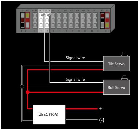

Jim I picked out yesterday on the web from Zero that the Servos on the Steadi were to be fed power wise via 1 x 10amp UBEC! Did you install that or has anyone else for that matter, Its quite interesting I can find nothing on paper about it.
