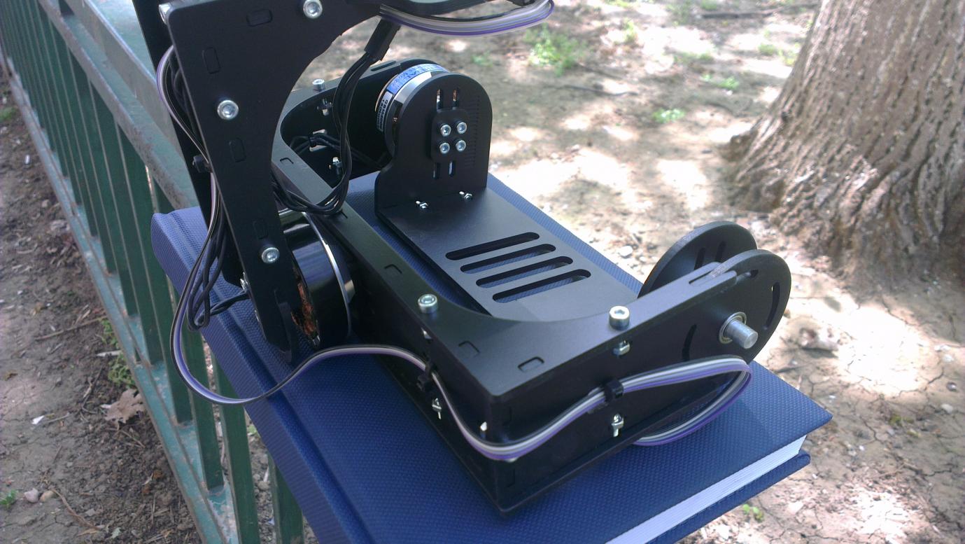

Jim I picked out yesterday on the web from Zero that the Servos on the Steadi were to be fed power wise via 1 x 10amp UBEC! Did you install that or has anyone else for that matter, Its quite interesting I can find nothing on paper about it.
View attachment 11885[/QUOTE
I didn't use a ubec for the gimbal servos. I didnnt see anything calling for one and seemed to work fine without it. Dont know why it would be required....I would expect power would be incorporated into the fc. ???
johnno
Hi Jim, I thought the same thing and they seem to work ok unless they have discovered something and suggest this alternative but why 10amps thats a hell of a current draw
What bugs me is that I just saw it on Robs site and yet theres nothing mentioned elsewhere like take note urgent anything. Cheers john.
robone
I cannot remember where I got the image from. I am not sure how much the 2 servos will draw. This image was really just to show how one should connect the servos to the YS-X6 and not to use the power from the YS-X6.
It is normal practice to provide a separate UBEC to power the Gimbal Servos
Efliernz
Pete
I had my first Hexa fall out the sky after the FC and Rx went low-voltage from a stalled tilt servo (and too smaller ubec) and the servo dragged the ubec voltage down.
It was only an Openpilot CC board... For education sake, here is the demo/instructional video why you spend $ on large (separate) ubecs.
