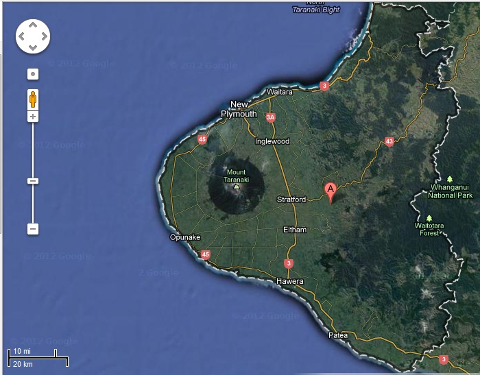

how do you rate your hex ? coning to get semi serious and photograph all of Taranaki this year (bit of a project with the kids) and thinking a decent hex may be idea, that and a wing for windy days
going to make whatever it is out of wood - grown to like building with it over the past month, and if i have a battery drill and a hacksaw in the car a length of wood, i can repair on-the-run which would be important if at whangamomena or mt damper falls .
yes.... i said ALL of Taranaki !

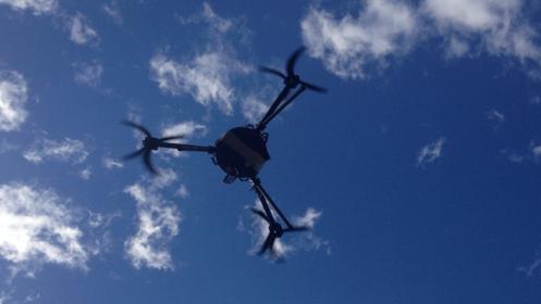

Here is mine :)

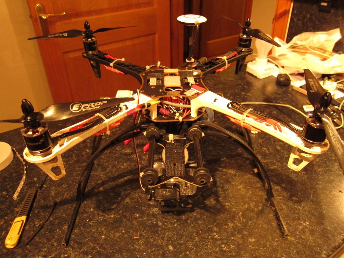

So my Y6 is now finally airborne!
I have just got some of the YAW fixed. Thank you Irisaerial.
But i need some advice what is the best absolute best way to allign the motors so that the are perfectly horizontal. Im using a Rusty Y6 UAP2 with vibration dampening motor mounts.
My rid felw today somewhat stable for first outdoor test flight, How ever when i yaw, it will jump up 5 to 6 inches and yaw real fast. Im guessing i need to set a curve in my futaba TX ??
also when i took of second time today it did a counter clock wise yaw 90% by its self. But this only happened once out of 5 times. Could this be related to the arms not beeing dead center so tha tthe motor can maybe have some sort of incline?
One more thing was flight time. A very stock UAP2 Y6 from rusty no gimbal no antivibration gimbal kit just a Turnegy Nano-Tech 4S 5.0 ( i admit second charge ever on that battery) only lasted 7 minutes. I was hoping for much more then that say 10 minutes.

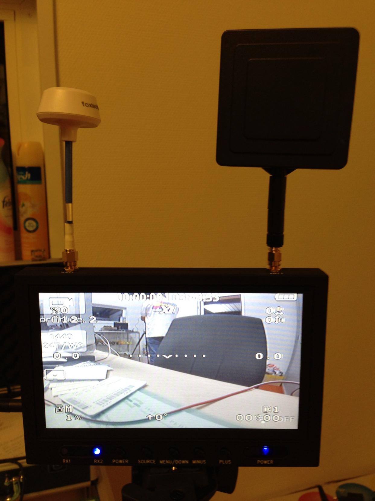

So had a little misshap today. After a smooth flight in wind gusts. Testing out my FPV equipment that worked amazing with the brushless gimbal. Landed and did not turn of motors yet as i wanted to do another takeoff. I left the button for less cyclic on and the thing just went sideways on me and busetd out 3 blades :-( So now that I need to order more blades ( yes I only bought 2 extra blades. stupid me) What Blades should I get ? I have a total 3.5 kilo machine with the batteries and all. Using AVROTO motores 2x 5000MAH 4s batteries. I am currently running on 11x4.5 Gamfan carbon reinforced blades all round. Would like to test 12x3.8 what do you guys say? Would actually like to buy some cheap blades of many sizes to try out different setups.. And when i find what is best i will get wooden XOAR
