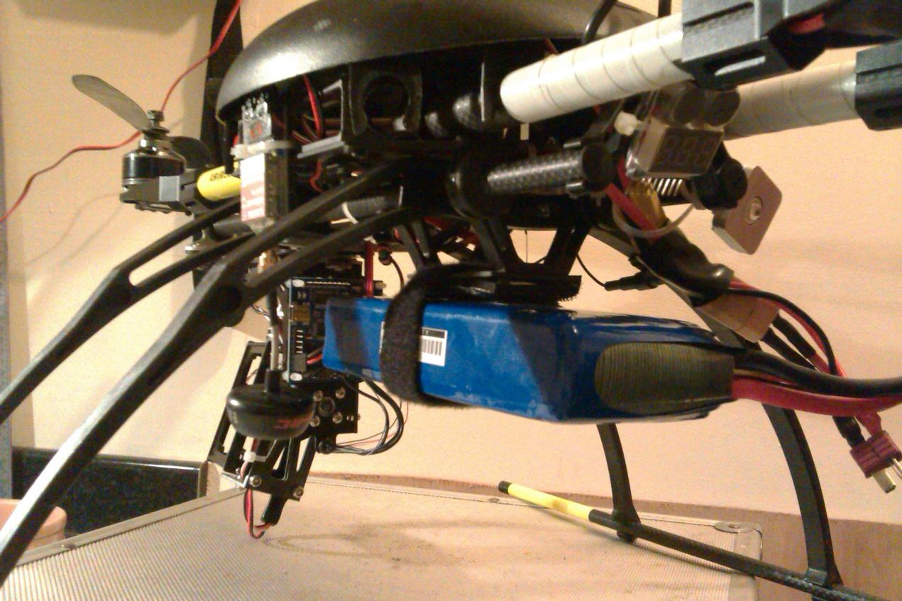

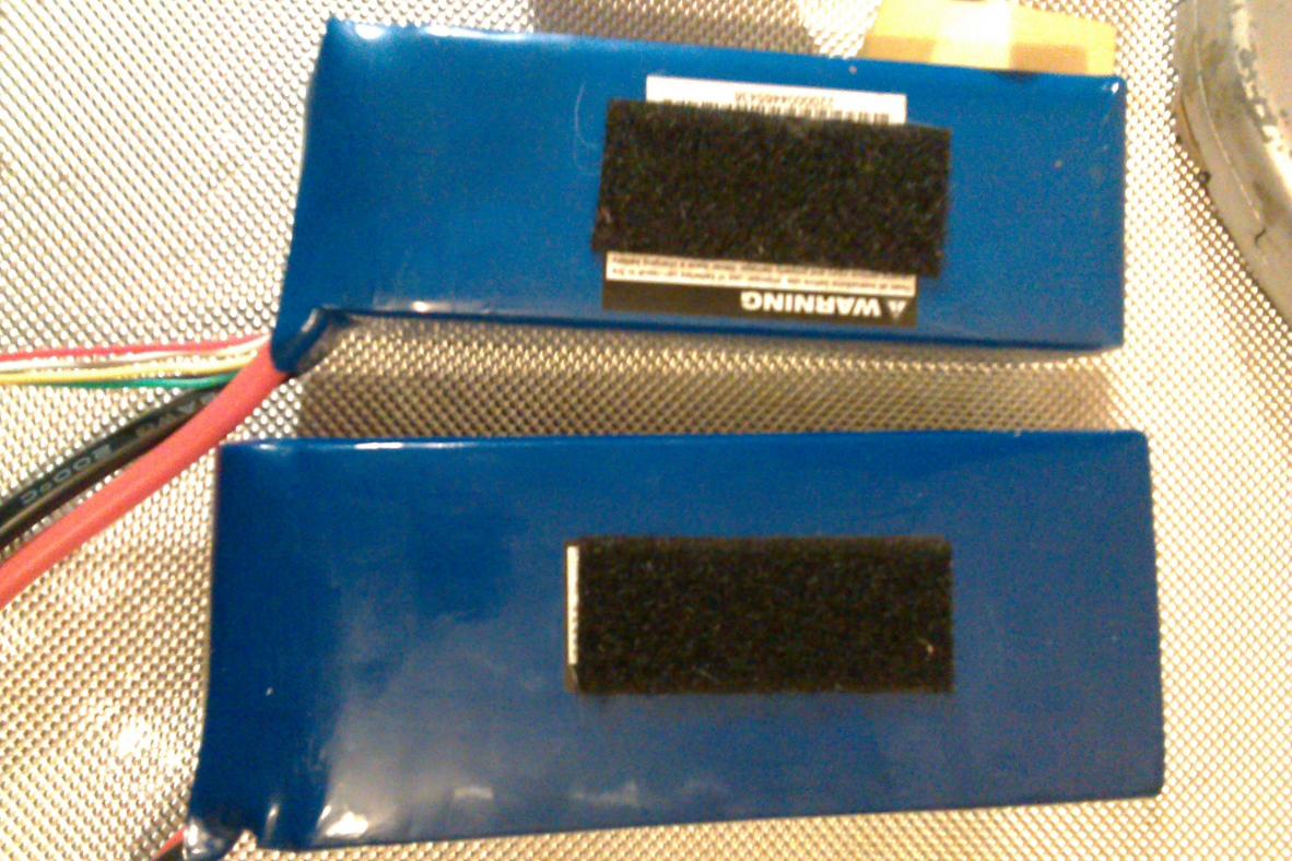

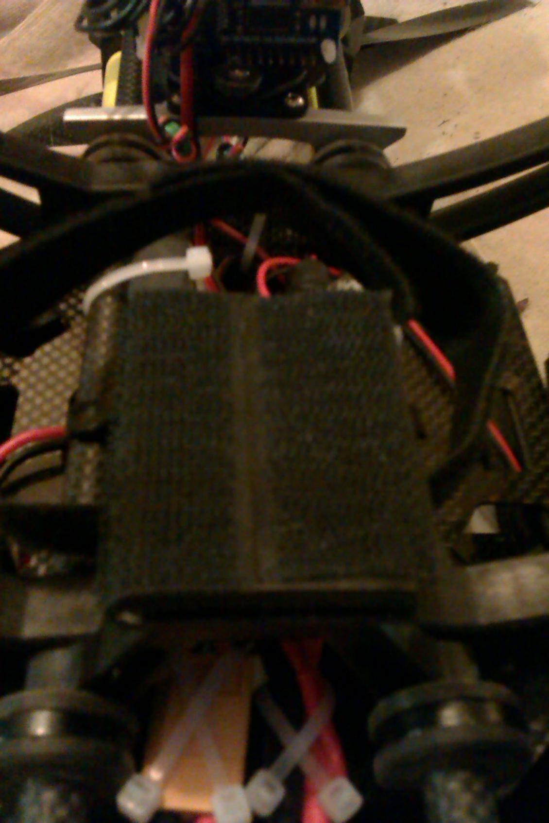

Here we go:
I have put double sided servo tape on the mount so the allen bold heads don't damage the lipos.
On that I have put two strips of hook Velcro.
On every lipo I have put a strip of the soft Velcro.
In the top of the mount I have also put a strip of soft Velcro- this stops the strap slipping on the top of the mount because I don't use two straps.
I then have a loop of double sided Velcro bought on a role.
I place the lipos upto the mount so the Velcro on the lipo ties to the Velcro on the mount. This stops the lipo from slipping
I then secure the strap around the lipo with an overlap of about 3 inches.
View attachment 15088 View attachment 15089
attachment.php
View attachment 15085 View attachment 15087

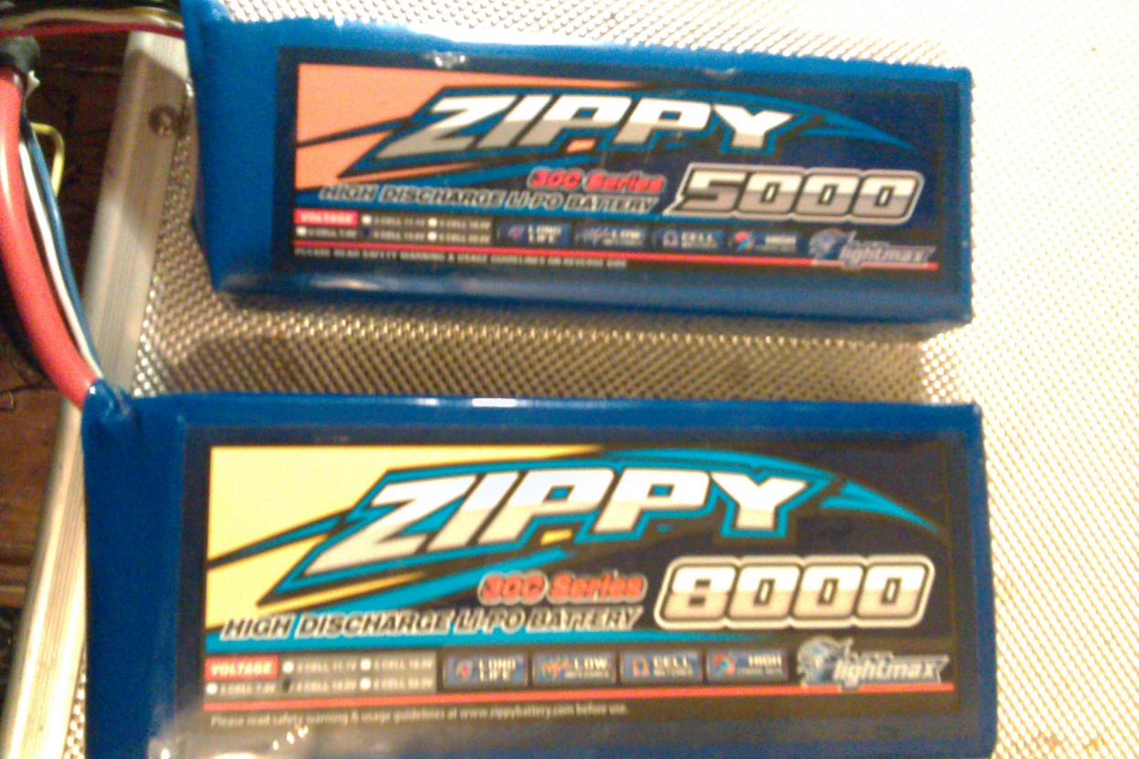

This allows me to balance the quad better every time as I use 3 different sizes of Lipo 5000, 5800 and 8000.
If the mount was fixed I would not be able to alter the balance point each time.

That is EXACTlY how I do mine. Good stuff.
CrashMaster
So glad I am not alone..... The xAircraft straps are not very strong so didn't trust them the minute I saw them.
There's an old expression: Experience Teaches which is true in any language.
I only went this way when I noticed that the lipos can slip during flight and one of my 5000ma lipos got a hole in the plastic because of those 4 hex bolts on the underside. I don't suppose you can give xAircraft feedback and ask for countersunk bolts or even a different method of mounting completely. Putting a hole in the lipo cover can be very dangerous. I was also looking at making a CF or GF cage for the lipos because it the worst happens the skids will collapse followed by my gimbal and then the lipos crash into concrete. This would be a very emotional but also a dangerous situation and potentially cause fire damage on top of the impact damage already suffered.

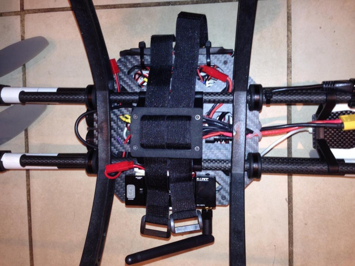

Any one having problem strapping big battery to the carriage with the Velcro strap that was included in seem it want to slide off any one uses different straps?.
Hi Dhardjono,
I had the exact same issues with the stock strap. I looked into getting a battery tray to stabilise things but I did not find anything really suitable. Then I got two smaller straps with buckles and tried them. Without the need to add Velcro to the support or the battery they worked wonderfully and battery slip is a thing of the past. The buck allows a much tighter grip and the two staps mean that if one loses traction the other is there as backup. See this image
You can get the straps off eBay for a few pounds and in all sorts of lengths
Hope this helps
Jonathan

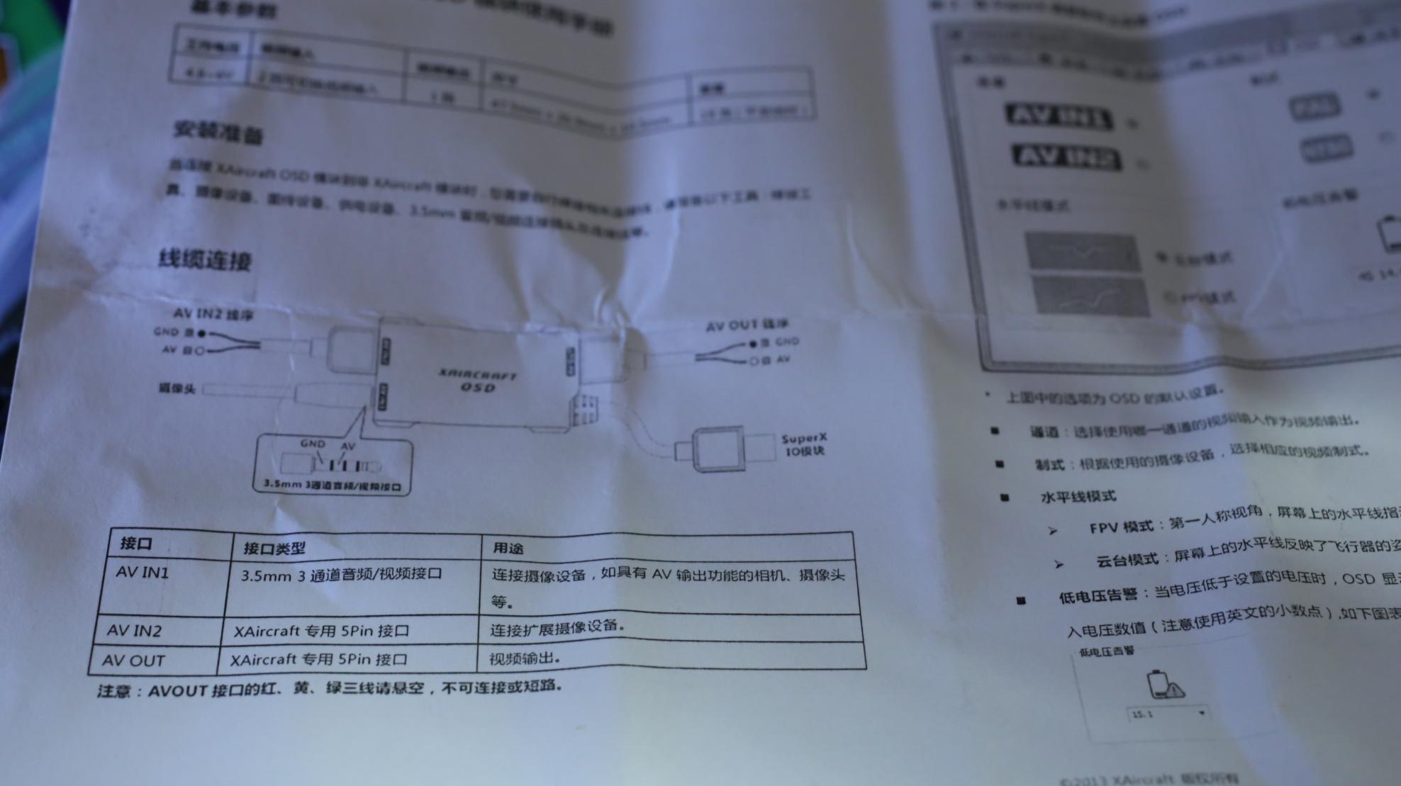

I have the gaui gv100 linked into my gopro for fpv.
If I buy the superX osd module, how do I wire it into the system?
Is anyone using this combination?

It easy just connect white wire to video tx and black wire to ground on the tx than another wire that came with it has a different plug for my set up so i cut it locate the white and black wire and do the same to go to go pro than soldier done.View attachment 15105View attachment 15106View attachment 15107View attachment 15108 instruction that came with it i will try the 2 velcro strap WBROWNJ thanks. Sorry i took the picture of the instruction paper in Chinese the other side is english.

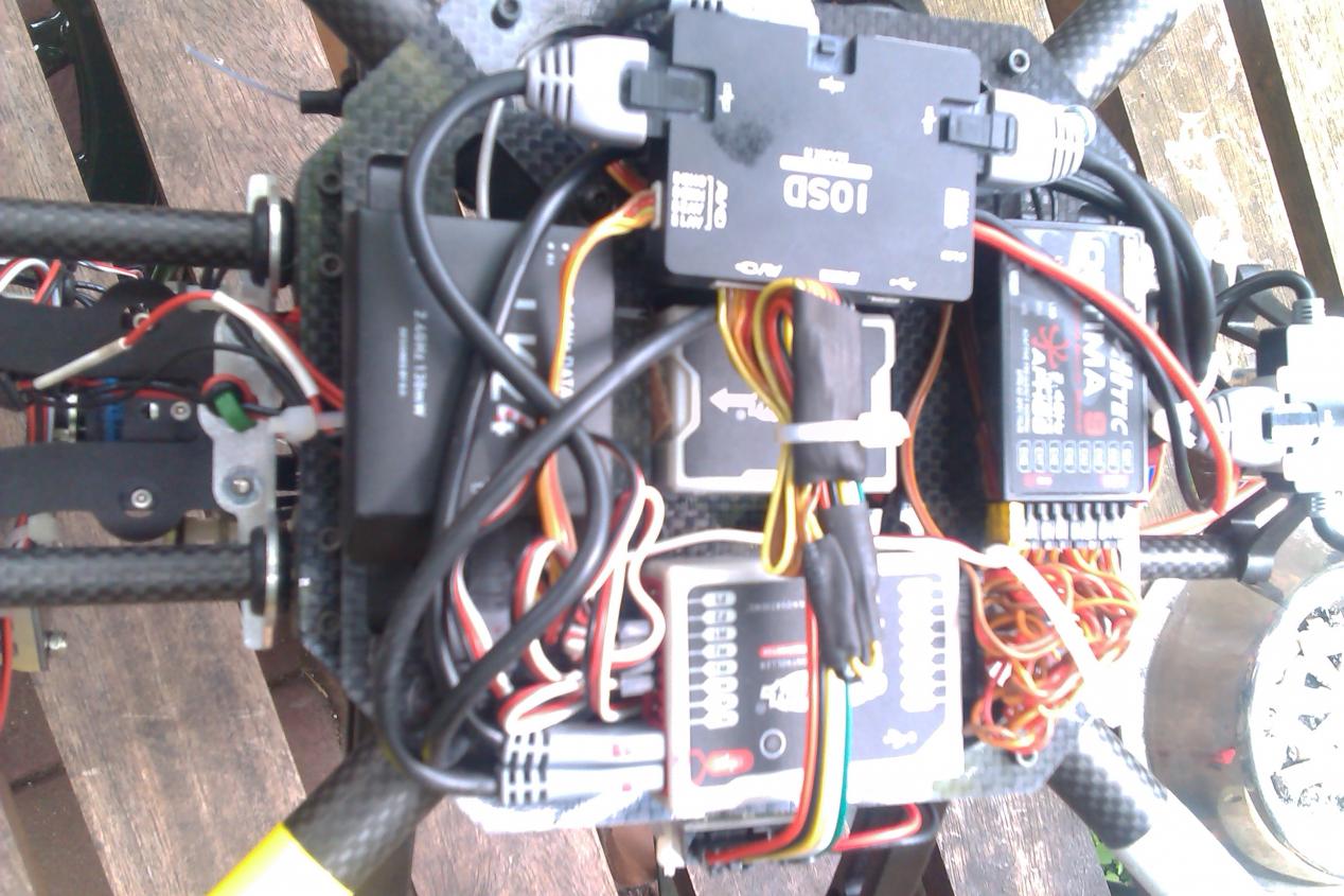

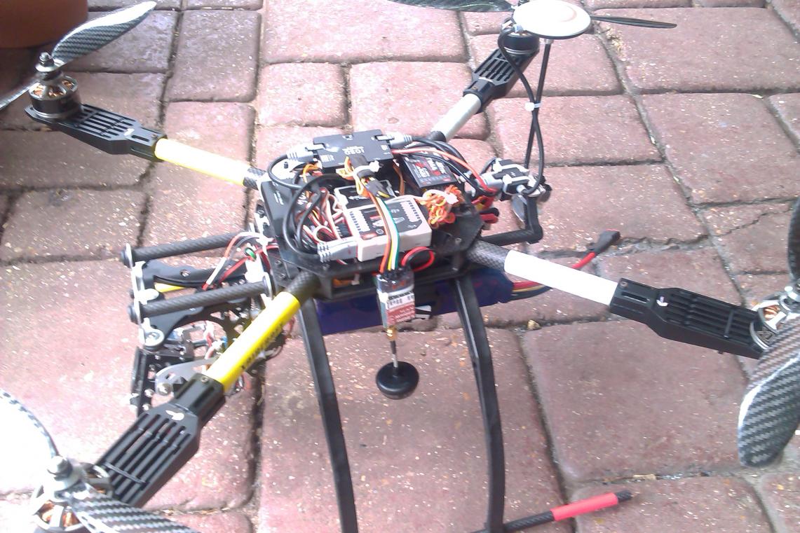

I have nothing attatched to the legs other than the RX antenna and they are only slipped into two rubber tubes so they just pull out. the reason for this is that I can remove the legs in seconds for storage and transportation. Everything hangs on the main central frame somewhere. It does get a little cluttered but all works fine.
View attachment 15110 View attachment 15111 View attachment 15112

It easy just connect white wire to video tx and black wire to ground on the tx than another wire that came with it has a different plug for my set up so i cut it locate the white and black wire and do the same to go to go pro than soldier done.View attachment 18884View attachment 18885View attachment 18886View attachment 18887 instruction that came with it i will try the 2 velcro strap WBROWNJ thanks. Sorry i took the picture of the instruction paper in Chinese the other side is english.
Thank you for the good info.
J

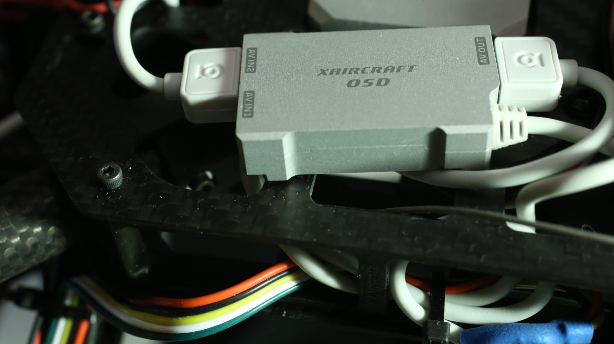

McAND
Hi I'm Andrea from North Italy,
thank you all for information and pictures.
I have a x650 pro with Super x and OSD.
could someone post me some picture of how you have plug in the wires of cam for fpv?
..The cable of the osd haves the video wire on white not on yellow :/ ?
Osd have 2 AvIn is it possible to plug in gopro in avin1 and Fpv cam in avin2 and switch it via radio?
Thank you

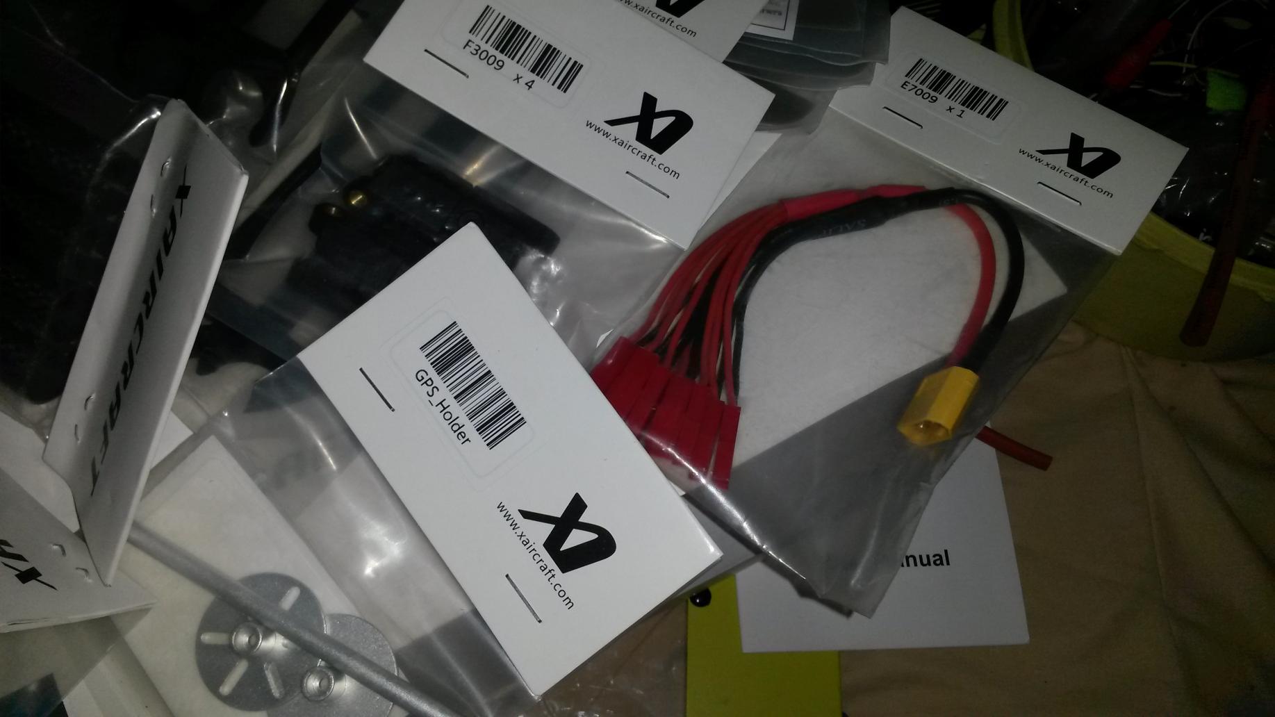

View attachment 15205 Now i order a gps rod to make it higher is that a good idea? also i order the power cable with 9 inputs instead of the 6 that came with the kit i wanted to plug in my gimbal and my tx and maybe a led lights for night flying so i have plenty of power input good idea or bad? View attachment 15206
