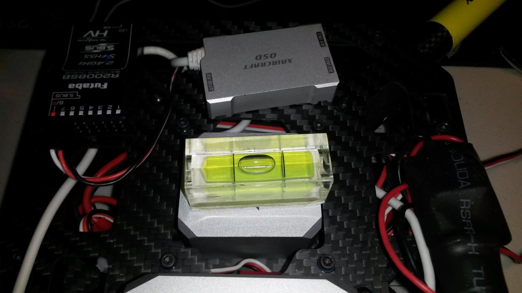

Dhardjono
Hi xmouse thanks for the help it going good i added this gps pole i put the magnetic on the bottom i don't know if this is ok in this spot i almost finish time to balance props.View attachment 15211

Hi xmouse thanks for the help it going good i added this gps pole i put the magnetic on the bottom i don't know if this is ok in this spot i almost finish time to balance props.View attachment 18996
NO! I have been told that where you have put the compass will prevent calibration and not work well, move the compass away from the GPS dome , not far but out of its shadow at least half the length of the cable. the GPS stalk looks good but is not necessary and only provides more things to break when you have another incident, but yes it look sexy :nevreness: but we are going for practicality here

Electro 2
What? The compass sensor is *in* the GPS dome/disc and not moveable by the user. Actually says so on the label. If you're refering to the in-line blivit-in-a-box, that's the back-up battery for the GPS receiver so it holds the last loaded ephemeris table for a few hours or so.
Well I just got confirmation and you are right I'm wrong, the compass is in the disk the rectangular box is the autopilot.
From XAircraftAustralia:
Nope. In the disk, the little box is the auto pilot. Easy way to tell, get a small magnet and put it on the box, then put it on the disk. When magnetic interference occurs the LED turns yellow. An iPhone or other smart phone does the same thing
Live and learn

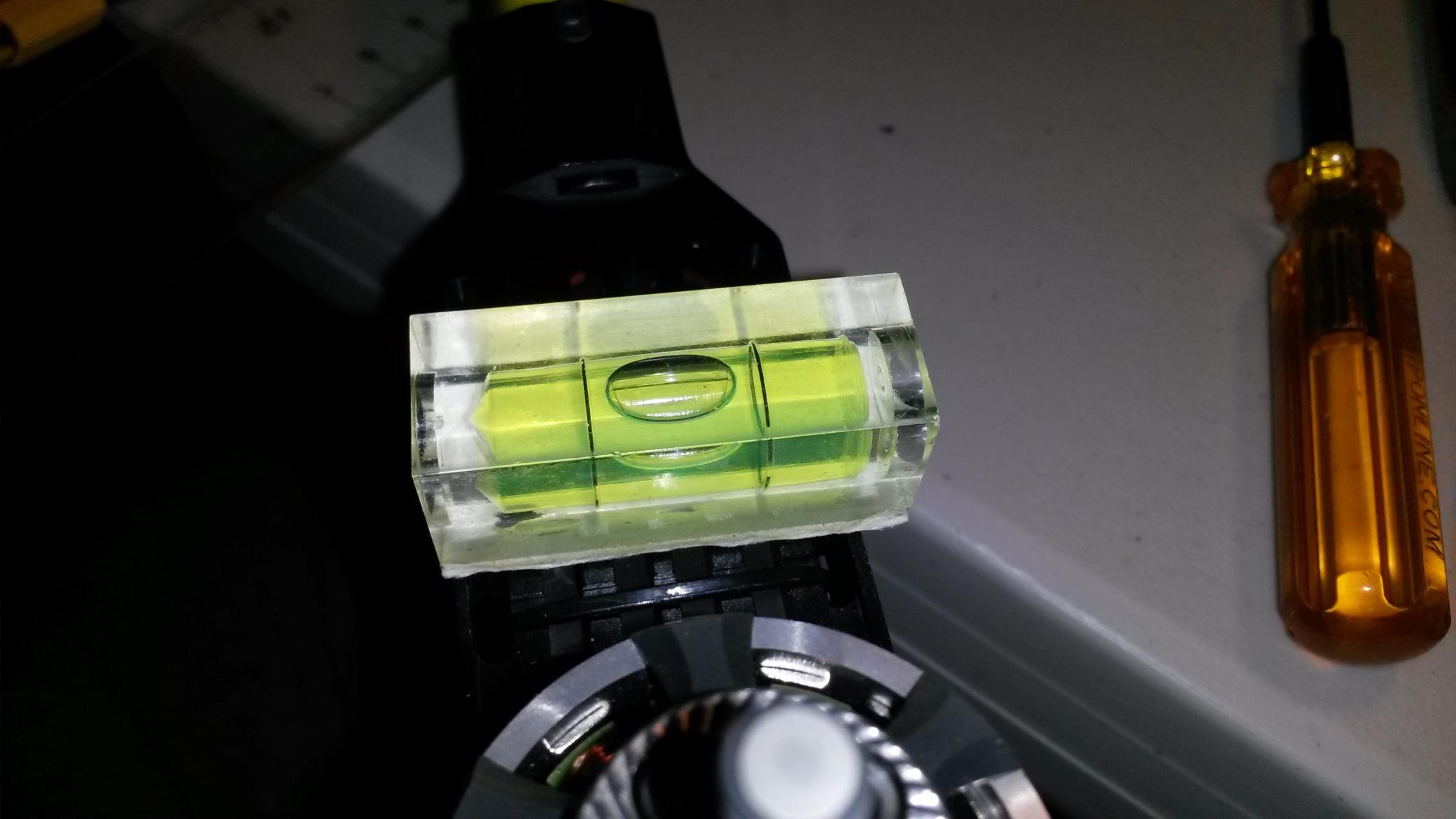

Am i doing the leveling of the motor correctly. I first level the center and than level 4 motor mounts with the skids off.
I have tried all sorts of methods to level my motors. The most accurate one I have used was using a digital pitch gauge that is accurate down to .1 of a degree. However in reality I found this to take a very long time and it did not affect my flight in the slightest when compared to using the quickest and easiest method ie the Mk1 Eyeball method. Yes, using the eyeball meant that the motors were slightly out of exact alignment (showed in the logs that 4 motors were spinning slightly faster than the others) but this did not make 1 iota of a difference in terms of flight stability, yaw control or flight times and this is on a heavy lift octo with 5D plus heavy lens. Yes I know in theory that this is less efficient way of doing it but in practice this just didn't add up, for me at least. I therefore now stick to just using the Mk1 eyeball which is surprisingly accurate in its own right. It saves so much time faffing around with spirit levels / pitch gauges etc etc.
Just a thought for you really, I know that many of us are naturally and rightly anally retentive about our MR setups but in this instance my eye is now the tool of choice. Having spent years in the military using all sorts of high end sensors you get to understand just how good and accurate your eye can be, even for those who wear glasses!

I started my military career as a tank gunner so well aware of bore sights and other optical devices, I found them much better than my eyes! Super X people have a distinct advantage called Black Box that provides graphic and numerical analysis of motors and vibration.
As a user I can, without hesitation, state that motor levelling and prop balancing on a XAircraft X650 improves video when taken from that vehicle, how you go about levelling is your business, in the case of Super X a good result is an average below 0.5g in say a 5 minute flight
