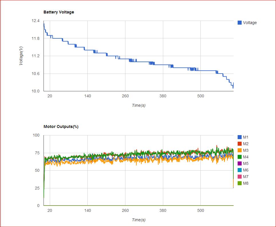

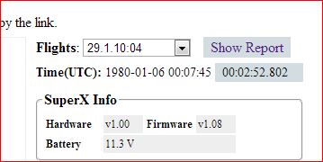

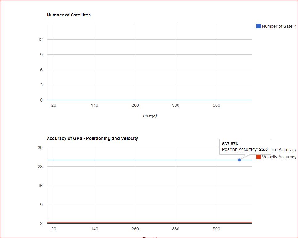

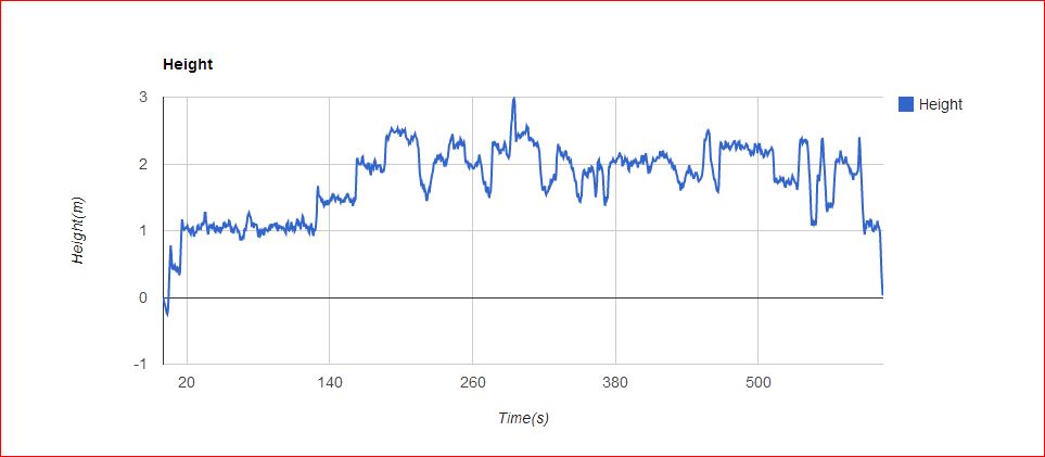

Did you get Super X from a XAircraft dealer? the log you have posted here has some very strange reports that I think need to be sorted out in China.
1. the UTC date on flights 27, 28 and 29 the latest is 1980!
2. the last flight 29 as well as 27 & 28 show you have NO satellites at all!
3. Vibration is good but motors not so.
4. It shows take off with 27% throttle! I don't think so.
5. Your height fluctuates from 1 to 3 meters like it is a yoyo
6. Your battery levels would be un-flyable
I presume you know to click on 'show report' top right of the opening black box window.
My only advice is to contact your local XAircraft dealer, get them to look at the report and advise you.
The main issue is you have no satellites at all, flying is possible but not recommended for a novice.
Good luck
David

You are just not feeling me! YOU ARE NOT GETTING ANY SATELLITE SIGNAL! if your GPS module is broken get a new one, if you are in a Satellite black spot move home! but until you can get Super X to see satellites doing anything else is a mute point, sorry and I know it's money at the wrong time of the year but it is broken!
Sorry I have gone as far as I can, maybe somebody else can take up the gauntlet and help, I'm getting too old for it :dejection:

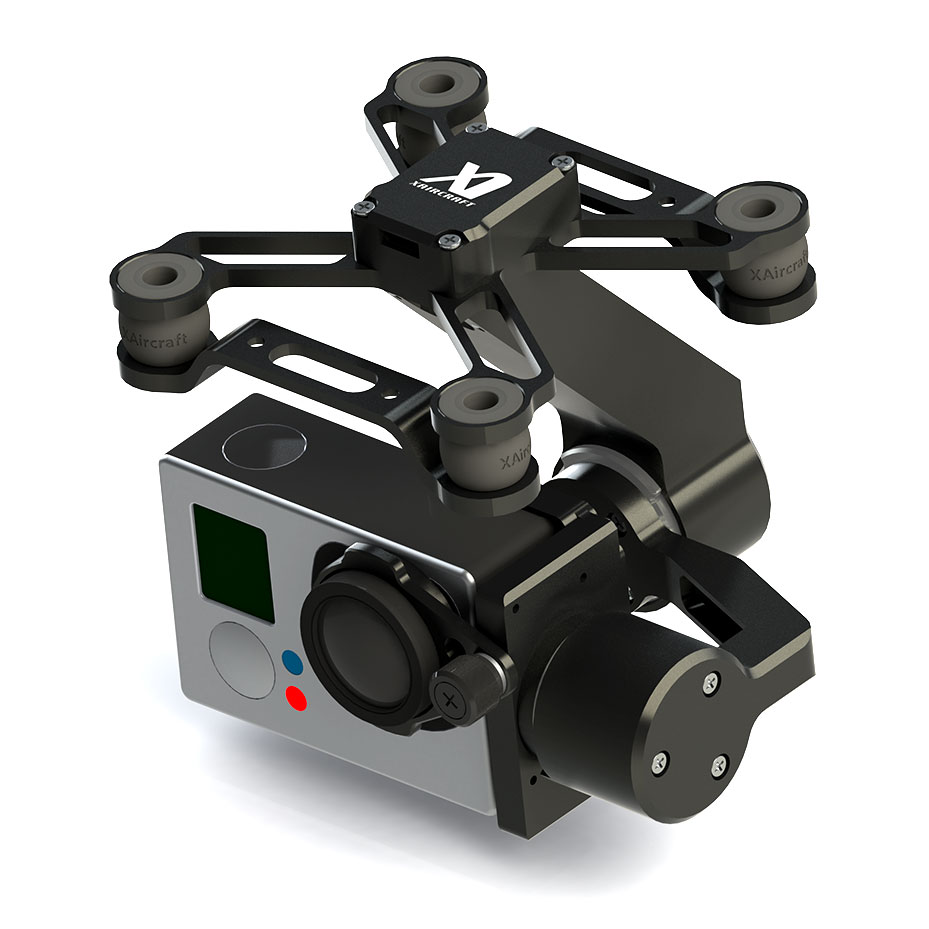

I have a theory that the "flex" in the X650's lower frame, being the loading pipes, skids, gimbal, etc. All of that is just held on by those 4 dampeners that the load pipes go through. There is a little flex around those connections. I have tried to minimize that by stiffening that area with various techniques, it might help a little bit. But I definitely think that is a culprit to some of the minor shakes and tiny vibrations that come through on video taken by a X650.
