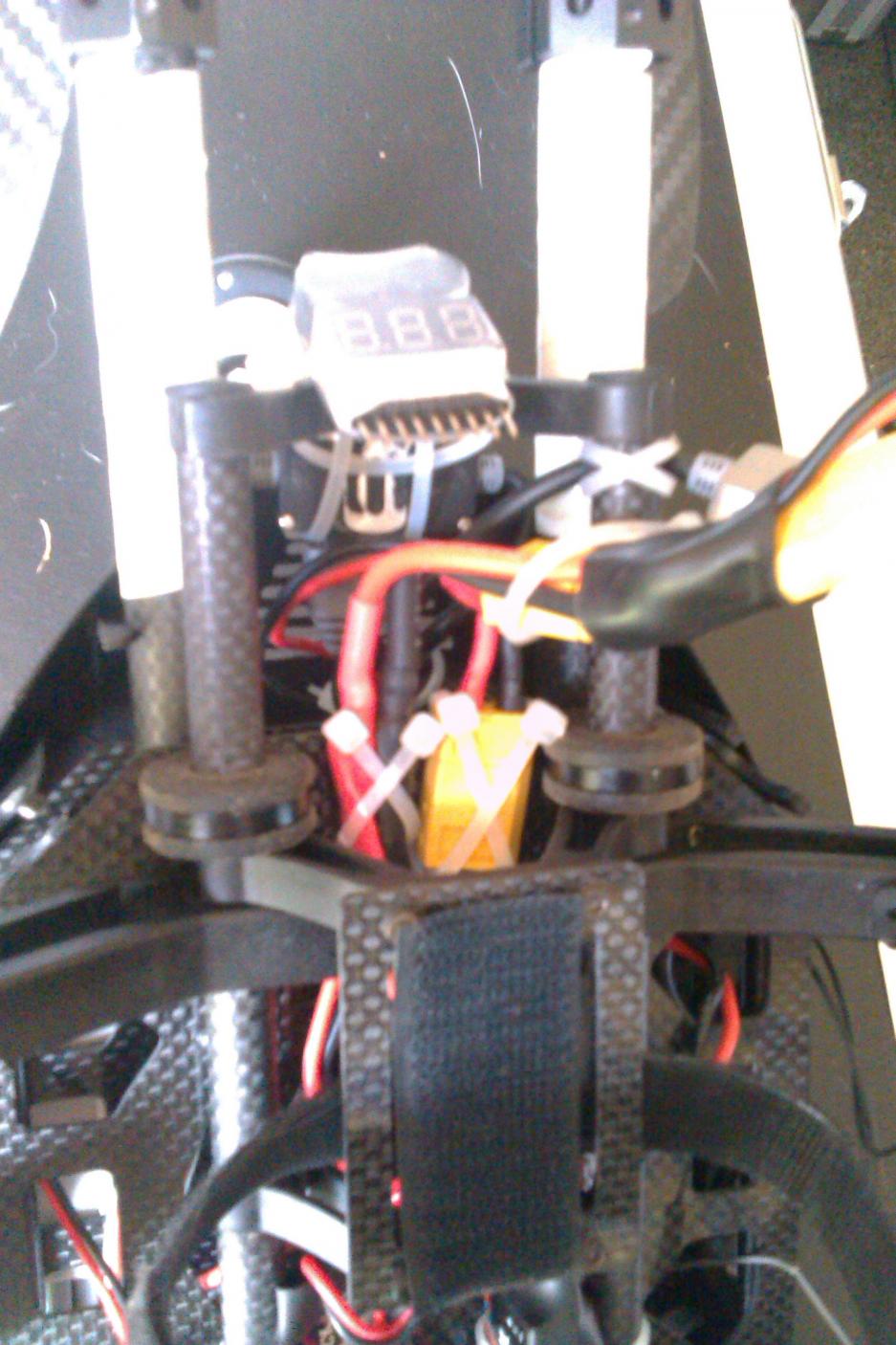

The only issue I have had is that the rear left arm kept going out of true so the prop was never flat. I tracked that down to a screw in part number F3009 having pulled it's own thread off. The quality of the screws has been questioned before but should this happen again I will add longer screws with lock nuts not relying on the brass inset to hold.

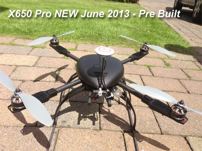

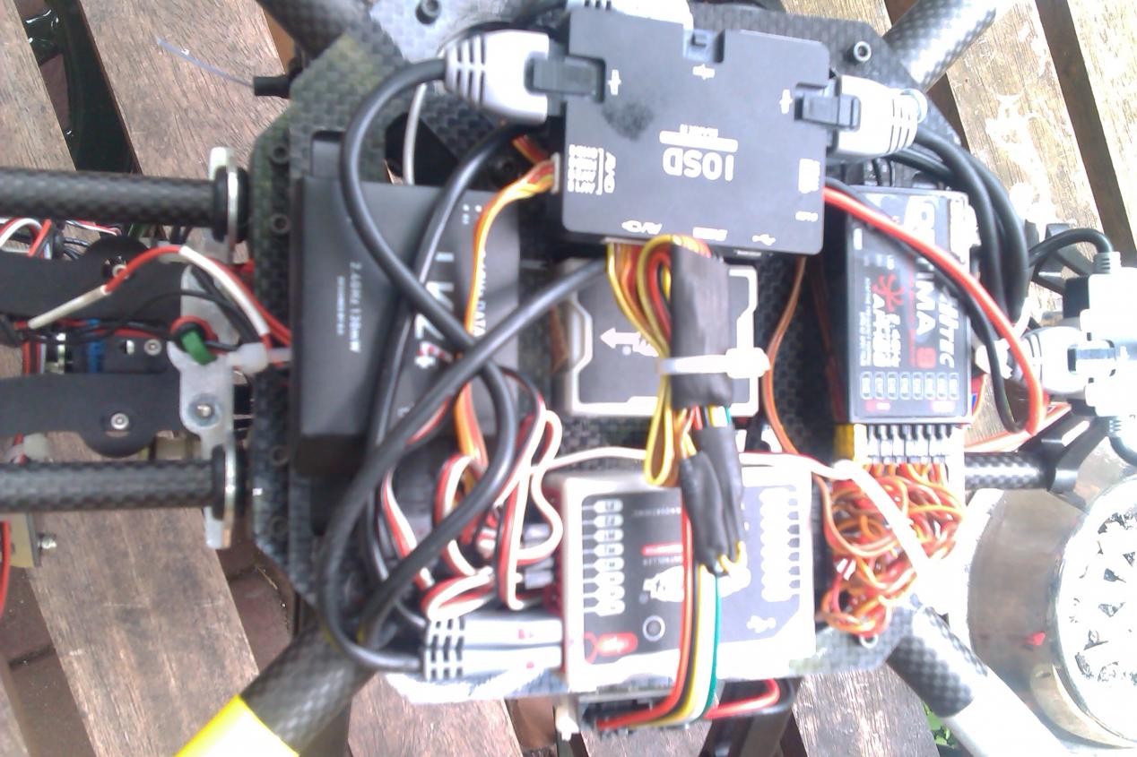

Here is what I have inside !
View attachment 12718 View attachment 12719

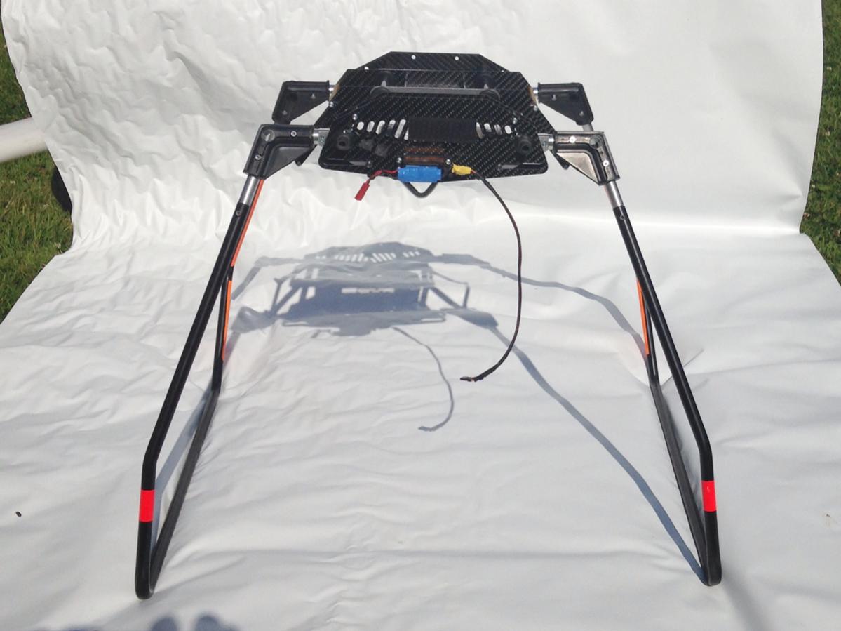

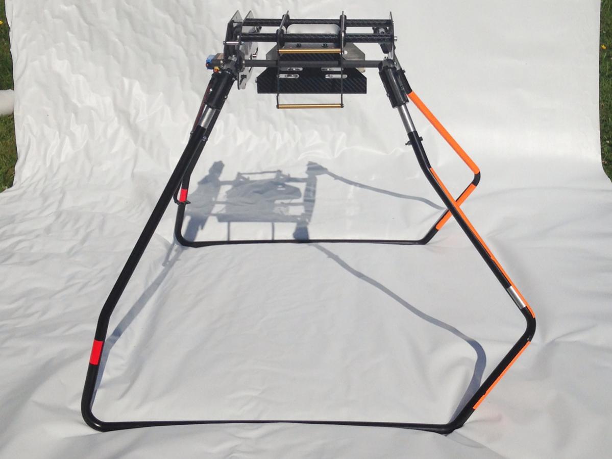

iflynavy
Crash
Thanks again for the conversation...

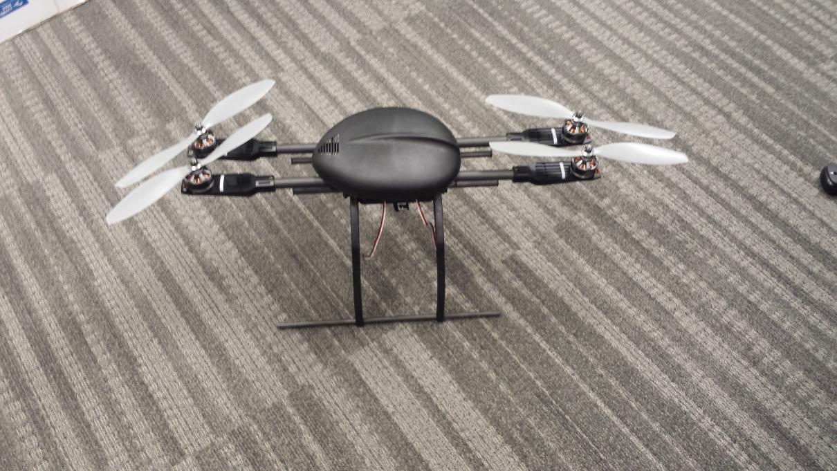

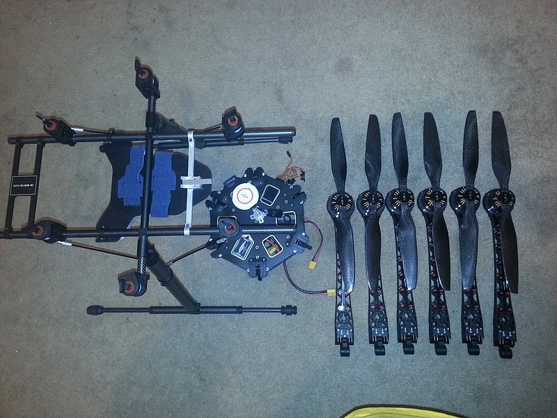

I ended up getting the x650 Pro. Much like we discussed it's light years ahead of the Value version. The motors for one are T-Motor, as are the ESCs which are much better then all the things I have heard about the stock ones or the AKE ones that come on the Value Kit from Century.
None the less here are the first pictures...no electronics as of yet, still waiting on WKM before I mount receiver and FPV Gear.View attachment 12767View attachment 12768

Once airborne you will notice the stability and spare power available with the pro compared to the Value.... The name gives it away. You get what you pay for.
Can't wait to see how the build goes. If there are any problems I should be able to help as you are building almost exactly what I have except you have the 50 way-points as opposed to my 5.
