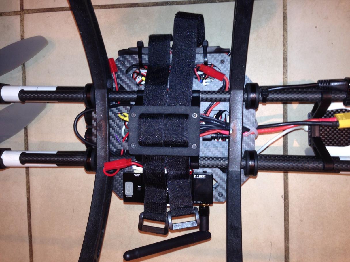

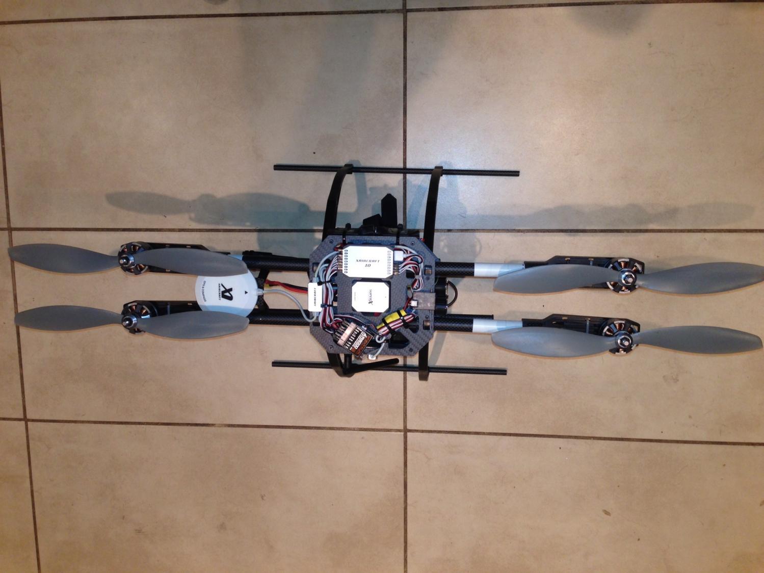

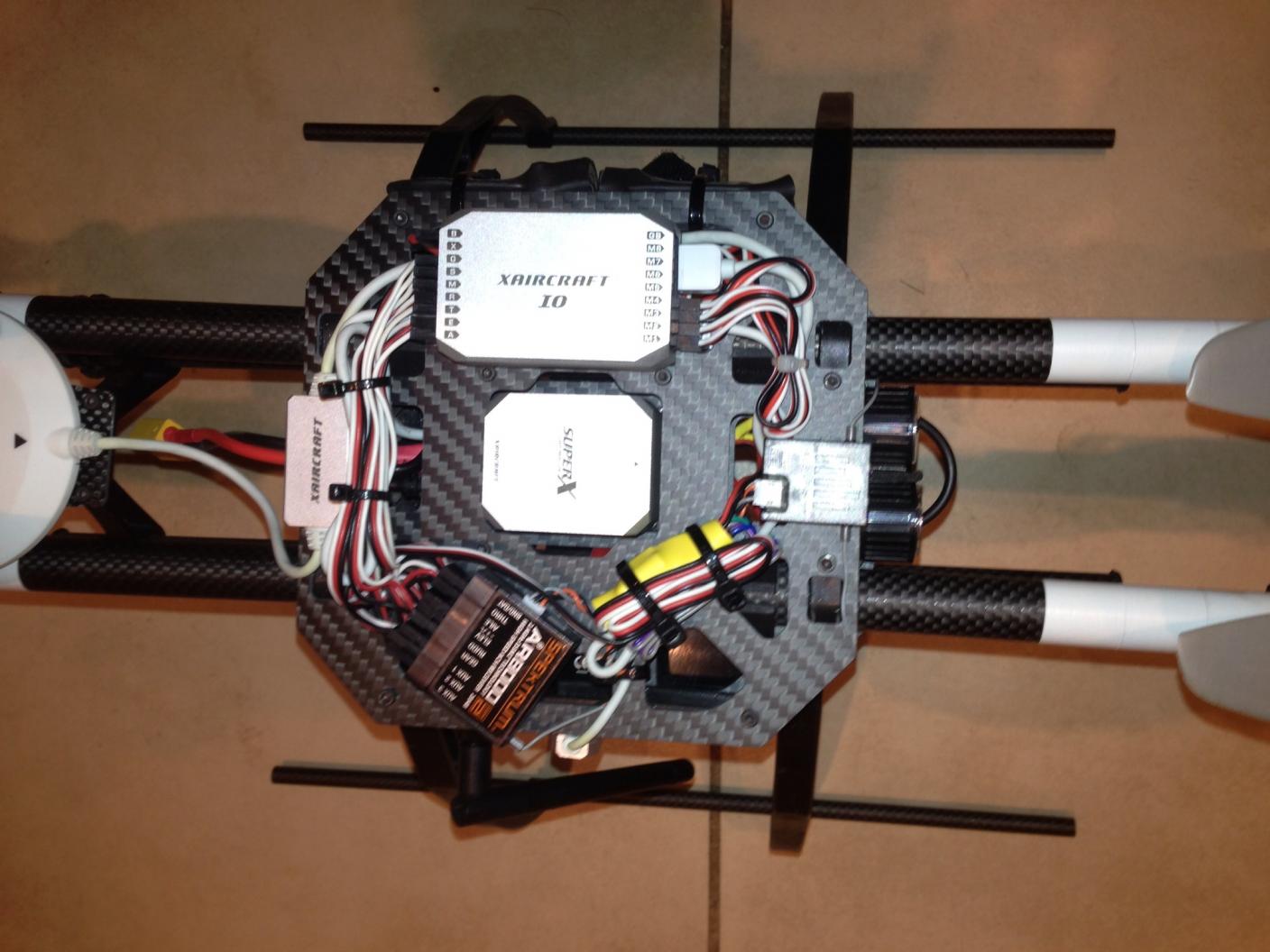

Hey all,
You all sound very professional compared to me but I too recently bought a XA650 Pro with SuperX. I too got it from Mark at xaircraft.co.uk and got very good and reliable service from him.
I really am only a hobby flier. I went from helis to quads when I discovered the Hubsan X4. That soon led to a DJI Phantom which I still have and enjoy but it soon became clear that I wanted (NEEDED :):)) a better craft and after due research I opted for the xa650 Pro. And wow I really do love it. SuperX is..er..well... Super. Here are a few photos of my setup....
I use a Spektrum Dx8 transmitter and a R8000 Rx together with its satellite receiver.
The bundle of wires with the yellow attachment is the controller for the lights I use for orientation. More on these later.
On the side I have 2 ubecs. One for 12volts to power my gimbal and FPV setup and a 7.4volt one for the lights.
QUESTION: When a ubec is not powering anything but is still connected to the flight battery, does it draw much/any power??? Thanks in advance for answers!!
So these are the lights and I really DO RECOMMEND THEM. They are available from http://www.4-max.co.uk/led-lights-landing.htm and whilst they are not cheap, they really are the business and fit perfectly into the body cavity at the front of the body. I hope you can see this from the photo. I have them held in place with strong double-sided tape and they are solid as a rock. In the photo, the lights are not on, what you see is just reflection from my camera flash. When they are on they are very bright and look very impressive even from a distance. They are great for orientation. They are controlled using a spare channel on the Rx.
This is my GAUI GV100 FPV system. I plugs into my GP3 BE. I really have not tried this yet because of the rubbish weather we have been having. I have the monitor screen that comes with the GV100 but have not gone with goggles yet. I have a few (lots) of problems with my eyes and goggles may not work too well for me. I may need to get some better vTx and vRx antennas like cloverleafs, but I need to see how it functions out of the box first. I liked the GV100 because it is so self contained. I was very easy to set up.
This final photo shows how I use two smaller straps for the battery. They are the type with buckles that allow them to be pulled tight. When I got the xa650 Pro it came with a very long xaircraft Velcro strap but I had a few worries about the battery slipping but these new belts really hold the battery firmly and there is no chance of slippage.
I am using 5000mah Turnigy lipos but have not really done any timings of flight times etc. At a guess I would say about 15 mins but that it pure guesswork.
Anyway, that is my setup and I am very happy with my Xaircraft 650 Pro.
Thanks for reading,
Jonathan
