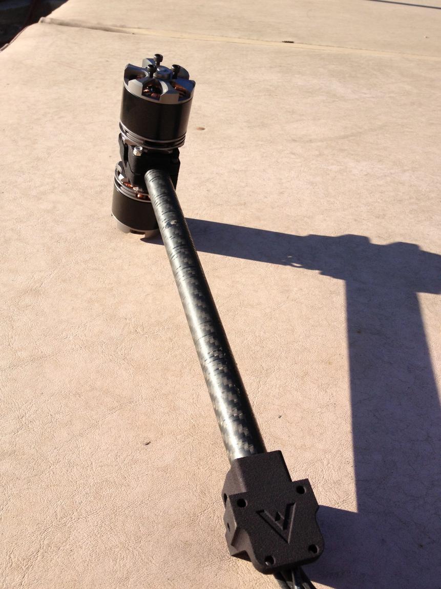

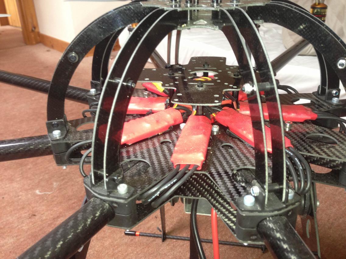

yes, we have another product called a stomp pad that has a precut space for the esc's underneath the frame.....
otherwise the esc's go under and don't land her too hard or you can glue them to the arms.....zip tie, whatever

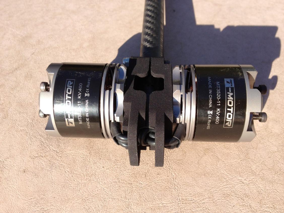

I can attest that even with "just" 4x 3515 and 13" props the disco with our early prototype mounts was by far the fastest multirotor I have ever flown. And it was smooth as heck.
the hovering capability in wind is another big benefit, the jello free video too. theres so many reasons, but if you crash alot, stay off these with a pro frame cause they'll take the frame out before they break @ $600 a copy
heres me going at it
if you go all the way to 3515 or 3520 with 6s it'll fly dam near a half hour with 5000 6s.....

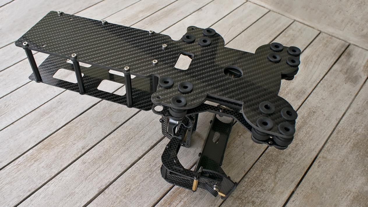

the outside plates had to be redone, almost guys, super close to perfect. Your all gonna dig the inner bracket, it's the coolest thing ever. only change were looking at is we may revert back to this 16mm tube. it's super strong and has better meat left on the parts. I've been busy moving some stuff around, but i'll get on this week and go see how the pro frame likes the handlebars. it's big setup for 14" props and these motors. looking forward to building out a stock length/power setup
