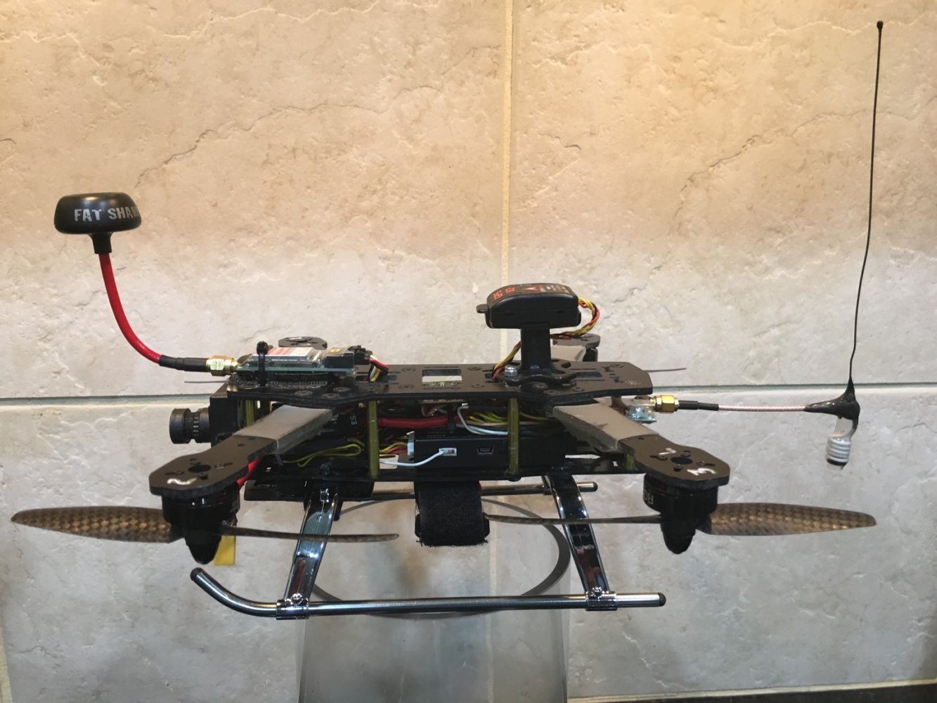

Mine...
Od this I have 1.2GHz Lawmate 500mW vTx
Next project is Mini H quad...

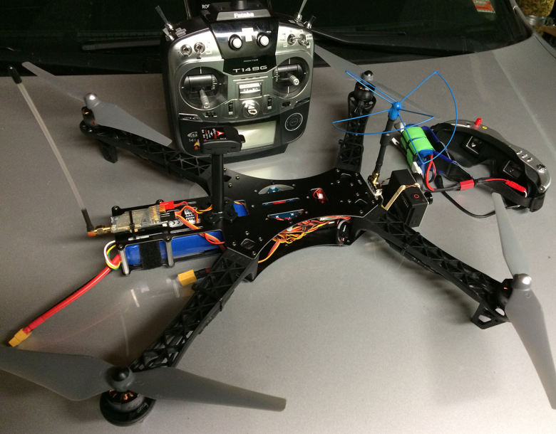

Just finished building this for fun...
Neewer Alien-X frame from Amazon (cheap)
Eagle Tree Vector
DJI E300 (had spares lying around)
RMRC 700TVL
Boscam Goggles
DragonLink - newest receiver (very cool)
4S 3300 Turnigy (also have 4S 4000 that fits in the trunk)
Not sure what to think of the Vector yet. I'm a little more used to DJI controllers, but so far, flying in 3D or 2D/2D Hold, it's been pretty stable. The 2D Loiter, which is similar to DJI's GPS Hold is not quite as locked in, but... this is more for playing around.
Was using a RMRC 200mw 2.3/2.4Ghz transmitter with the Boscam goggles (which support 5.8 and 2.4). I wasn't getting much range with this - only around 600 feet, which is horrible. I typically run 1.2Ghz (1258) and of course, when I switched back to 1.2Ghz, I have to run my ground station and use 5.8Ghz relay to the goggles, which is ok. My range is typically 2~3 miles flying under 180 feet, but flying that far out with this new multi is a bit too much of an adrenaline rush, so... 1 mile is perfect. So far, I've had her going up to 40mph in 3D mode. Considering trying some different motors...
View attachment 22180 View attachment 22181 View attachment 22182

a 150? looks fun, can you put a tape measure across the front of that and retake the photo pls? they get to a point where it's hard to tell exactly how small they are without a reference in the photo.

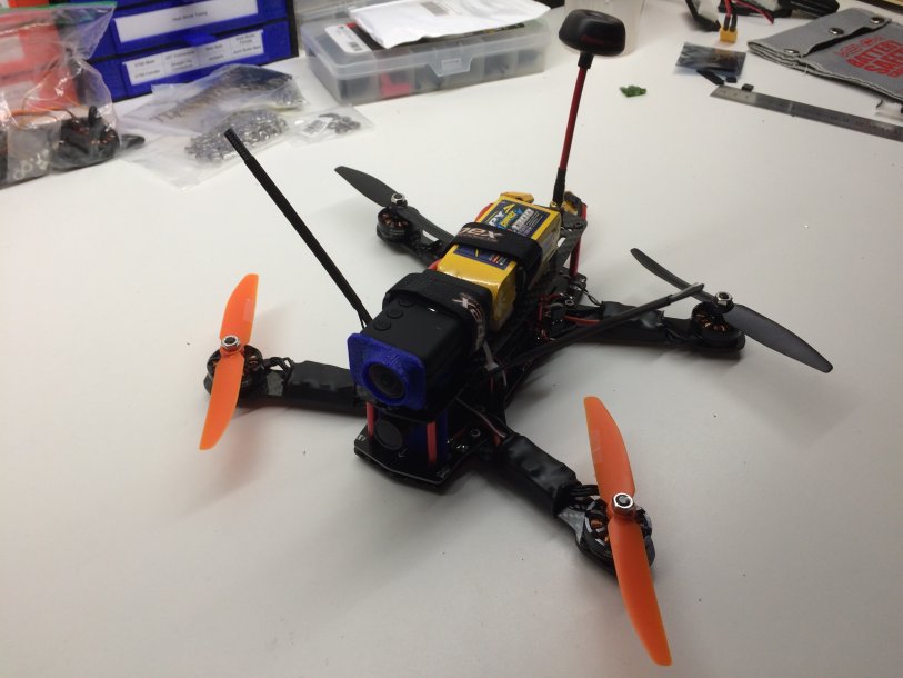

ZMR250
Been rebuilt a few times, just changed the Mobius and FPV camera mounts to be at 20 degrees. Started with HobbyKing blueseries ESCs, recently moved to RotorGeeks 12a ESCs due to the previous blueseries burning up. SunnySky 2204 2300kV motors, Naze32, Fatshark 600TVL CMOS with their 5.8Ghz 250mw transmitter.
Only have flown it a couple of times. Lots of fun!

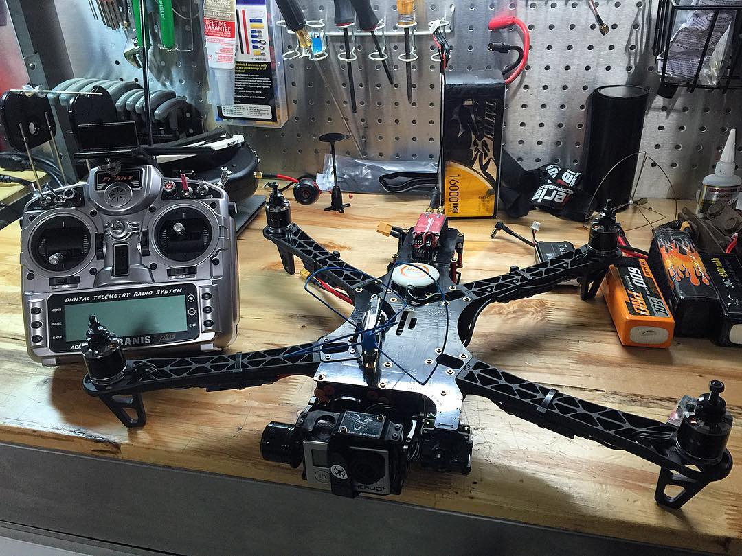

View attachment 27604 I hope to finish this up this weekend. There's three others I need to fix though before I can work on my own.
Dji s900 with tall landing gear, Zenmuse Z15 with a Sony A6000 and 20mm pancake lens, A2 Flight Control, iosd MKII, and it will have an ImmersionRC 600mw 5.8GHz transmitter for video and a fatshark 700 tvl for fpv view.
