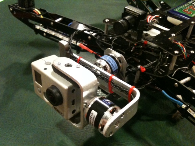

Thanks SMP, having a little difficulty getting the PID settings right with the OP CC3D after adding the additional weight in the front and larger battery but the initial flight performance of the Alexmos is pretty amazing.
Here's a few other photos of the DIY gimbal:
Only problem I have now is that I nicked the GP lens on a landing this weekend and trying to figure our a cure ( purchase a GP3 or aftermarket lens for this camera)

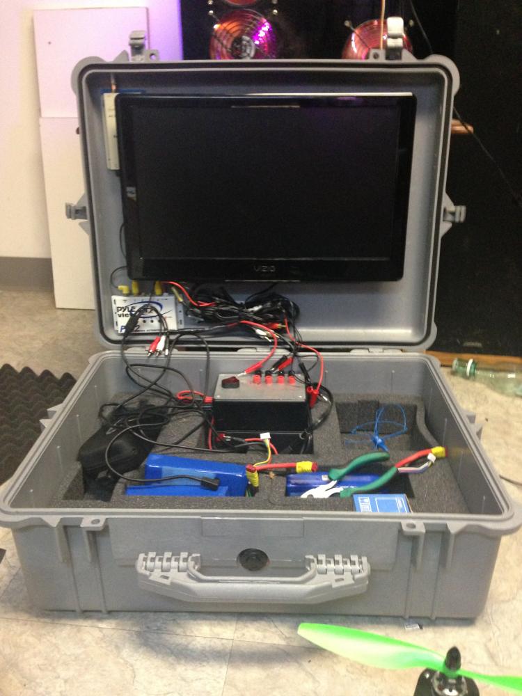

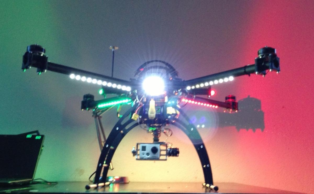

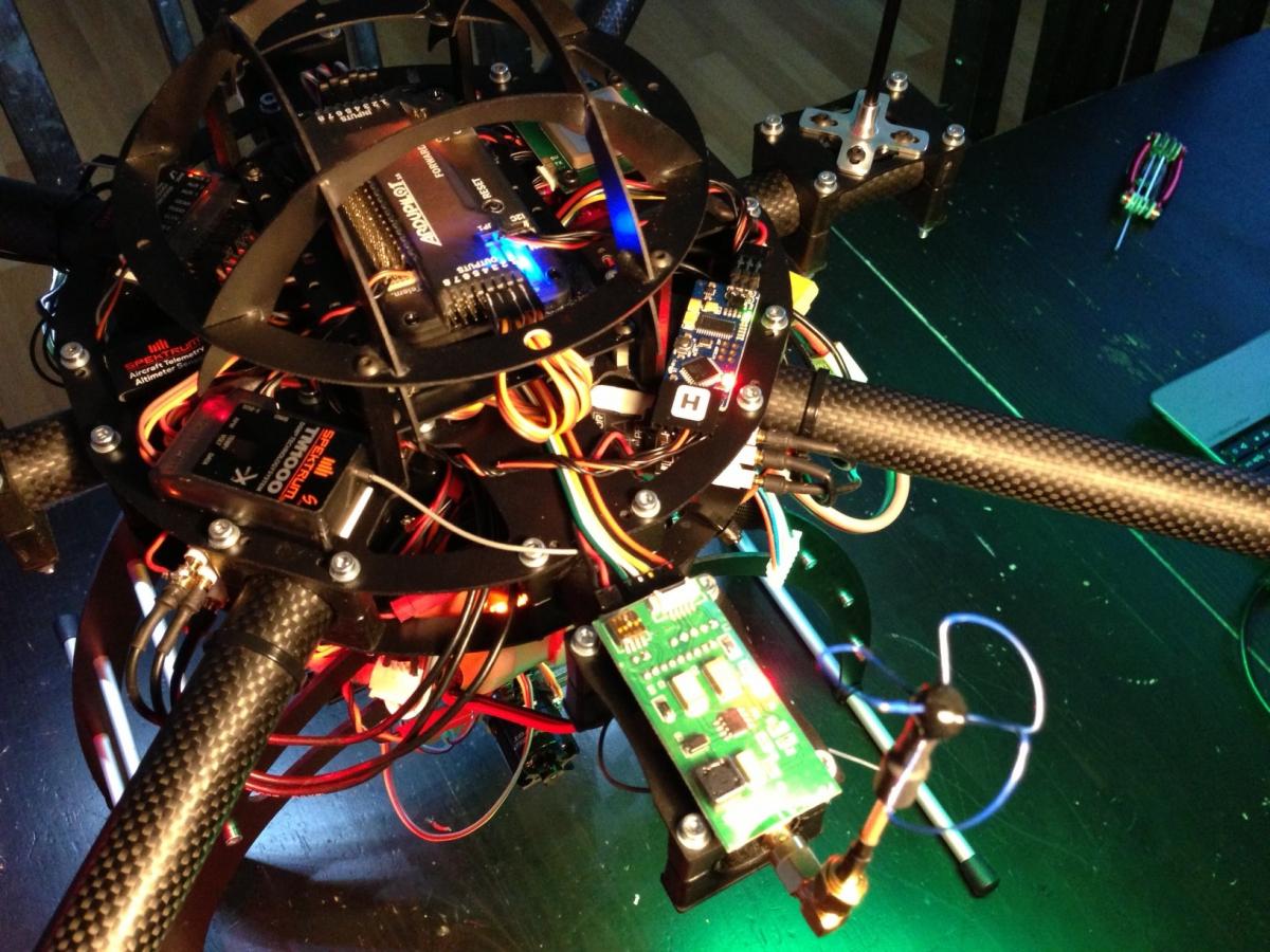

View attachment 13374HERE is my NEXT LEVEL 650 QUAD. I got a lot of help from randy at RCDUDE.com. On the quad, I'm running a 800mw VTX with circular polarization IBCRAZY antenna setup. My ground station is a used Pelican case I got of craigslist with a 19" LCD proven not to blue screen, bought refurbished for 90.00 bucks. None the less, with the DJ NAZA M VII, Futaba S-bus RX, Skylark Trace IV OSD, 1.3mah 3s lipo to power the cam and TX, 4s 5000mah to power everything else, she weighs in at 5.76lbs. View attachment 13372View attachment 13373

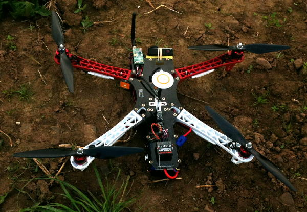

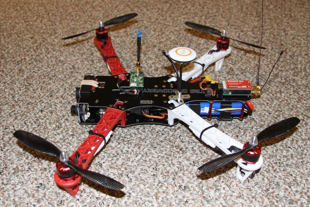

A few pic's of my Disco, she's less than a week old and this is my first quad/FPV and she's still missing a few bits ie an iOSD, love seat and flash card, will tidy her up when Ive got all the kit on board. My disco has Naza V2 GPS with ImmersionRC 5.8GHz 600mW VTX, Gopro hero 3 black (only camera on board), AR8000 & sat 2.4GHz and DJI 920Kv motors with stock DJI arms and esc's. I live on the welsh border and Have enjoyed today looking for sites to play, a few pic's View attachment 13382View attachment 13383View attachment 13384View attachment 13385 Last Pic is of a 5.8 GHz Skew-Planar antenna I built yesterday, only running rubber ducks at the mo.

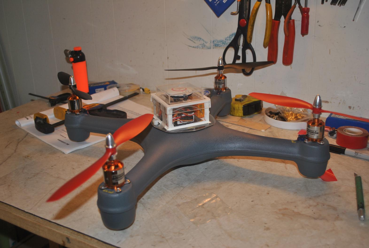

My completely homebrew 3D printed frame FPV quad...
The original testbed...
Both are being flown on a regular basis, the orange and black has a Naza lite, the other is a Multiwii Pro. The Multiwii version is the performance machine, the Naza flys just as well but is more stable at very low speeds so it gets used for tight quarters and flying through obstacle filled areas like the woods surrounding the flying field.
Ken
