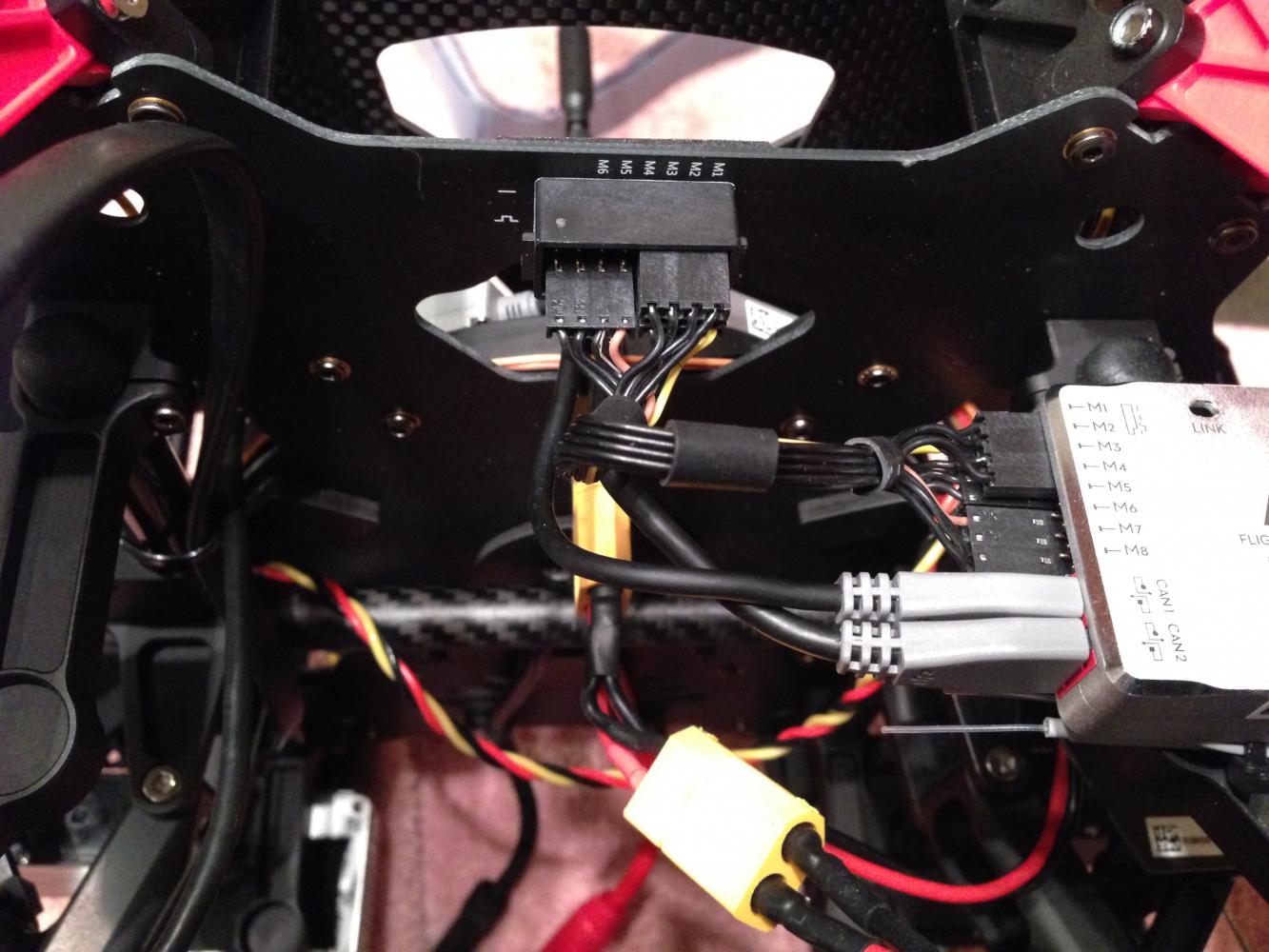

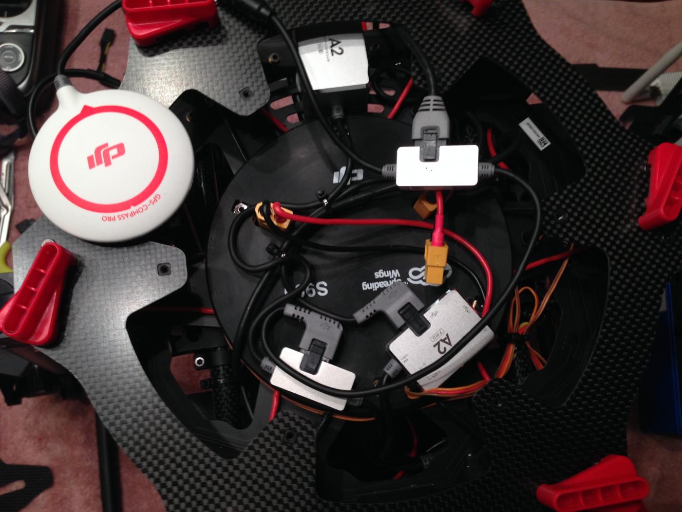

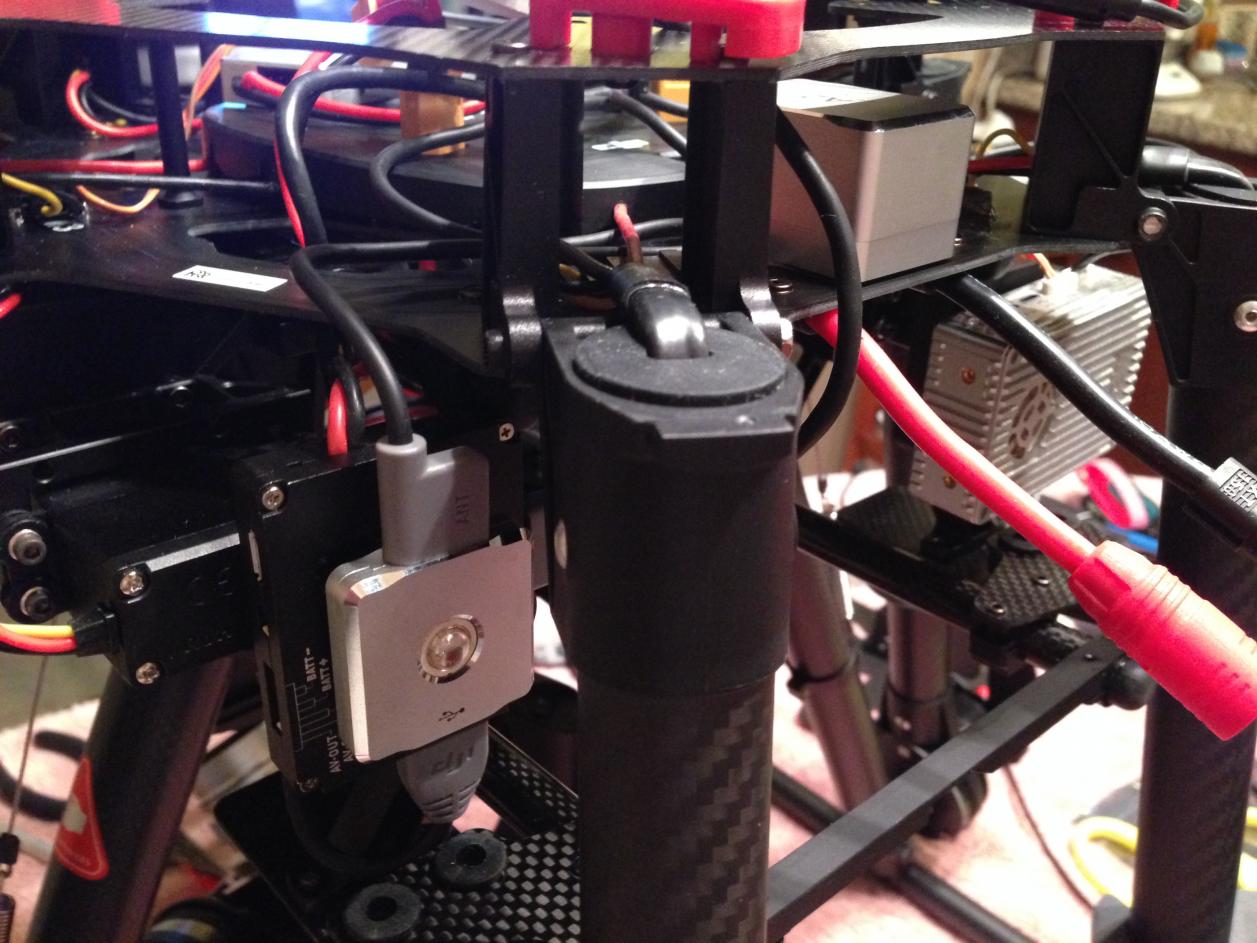

Electronic are in now time to upgrade all the electronics, set model in 14SG, calibrate in LB Assistant, calibrate in A2 Assistant, set gains (I will be using the same gains as me S1000), take off the gimbal and camera and fly.
