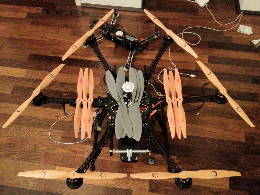

so ready to test I hope tomorrow. What were these graupners people were discussing about ?
Unilog installed so should get the needed data to compare flight time A draw etc.
15 x 5 Xoar 14 x 4 JXF and 14 4.7 APC

Those woden props look pretty cool on the S800, can't wait to hear what your results are BorisS.

What I liked about the Graupner 14x8 is the distribution of lift along the blade It works harder in the center which is good for stability and motor cooling. To me they felt much softer on the sticks. 15" may cost you some stability....and draw some amps.
Same old story, best efficiency is not the best stability.
I look fwd. to see your results Boris.
