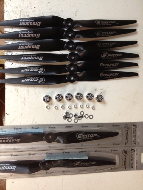

Today I flew a few flights with the S800 and ran some tests again (vid. to follow) I tried those 14x4.7 APC's again as I managed to damage a graupner in the car. I like these props. it ran as smooth as silk. No white flashes and the system was none the worse for wear after the FOD testing. I would say that 5.14 is as safe as anything else in the sky. The whole package is working fantastically well.
We have to congratulate DJI on what they have now achieved (albeit with with a little help).:apathy:

Rule #1, always order more props than you have motors on your copter.
Rule #2, always check the props before your close the doors of your car, a part of the prop might still be outside :D
best regards
Ferdinand

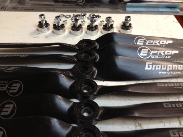

As of tonight I will be fully up to date with all adapter orders. Just sit tight they will be with you soon. Having exhausted the Islands supply of 3x8mm cap screws. I finally found some more hiding in the stainless box so you lucky guys are going to get stainless steel cap screws in this last batch.....

I ran over a pot hole and everything got thrown up in the air. Must drive slower.... but it did get me thinking APC again!!!
