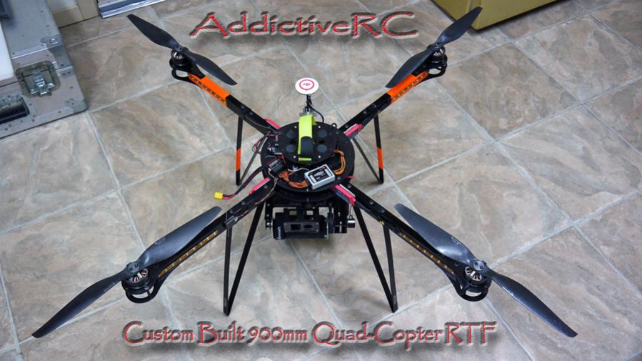

T-Motor CF 15 x 5.5 Props tested on T-Motor MN4014 Motors
We had a chance Saturday to test some of the new T-Motor CF 15 x 5.5 Props on our new Vulcan UAV 900mm Quad Frame.
We are very pleased with the smooth results!
Our Quad Has T-Motor MN4014 Motors and they love these props.
They behave nicely in wind and are very quiet with little to no Motor wine.
Our Qaud has an AUW of 12 Pounds RTF with 6S 8000mah Lipo.
Flight time was just about 15 min.
Very impressed with these props.
Please note attached photo is with our original props.
Cheers, John W.
