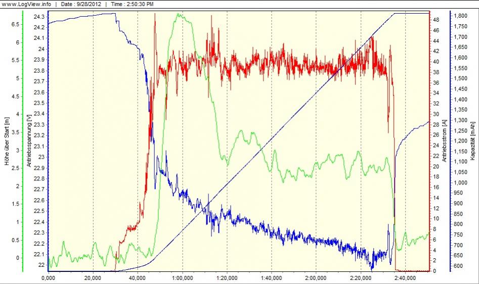

okay first results ! Fully loaded s800 z15 gh2 zippy 8000 mAh:
15 x 5 Xoar :
14 x 4.7 APC :
APC flight was very short. First of all I forgot to switch on the telemetry to start logging and than i heard a noise i didn't like. Since i didn't have the little inlay with me for the APCs i though it was because of that and stopped testing.
of coarse i forgot most of my stuff again, so the datalink wasn't with me so i couldn't do full flights to drain the lips since that my only way to have feedback of the lipo. I don't use the LED lipo signal.
Videos to follow !
But i must say i prefer the Xoar for now. Nice solid sound both props gave me a stable performance although there were gusts etc. I liked the sound and the feel of the Xoar better though, more solid just a safer feeling for some reasons. Gains are different for both ! Xoar need higher ones or can take higher gains and seems less nervous on higher gains. Don't know the values though since I had the on the radio ! Xoar to also work a little better conceding draw. To add there was much more wind when i was flying the Xoars mainly flying attitude and i had to hold the bird on position manually. The APC were in the air when there was hardly any wind going on. Should be considered concerning consumption and A needed to hover !

Ah temps. Both the same little warm, maybe a little warmer with the Xoar caffe having this temp I would pour it away :) !
BorisS
Japp additionally you have to consider that the xoar setup had to fight against the wind the APCs had calm conditions !

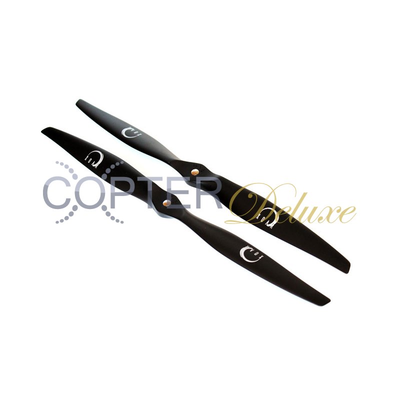

For some reason the shop is saying they are on maintanance....but the props are not carbon....they are wood, but painted black...check the bore
