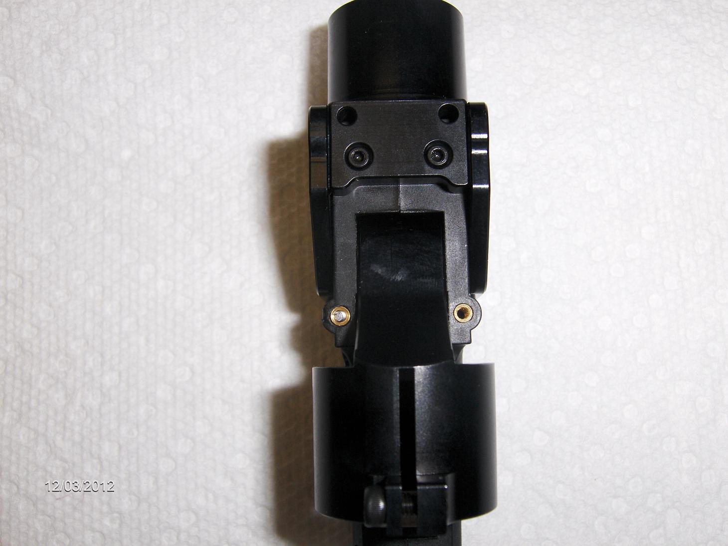

Hi, as the propeller is on the plate slab, the force will be in traction and not in shear. for me is apparently correct. jdm66

well a m6 thread is grooved 0,8 thick
so there is 5.2 left
that means the walls are only 0.6 thick.
so there is a lot of stress if you tighten them.
and eventualy can sheer of..
