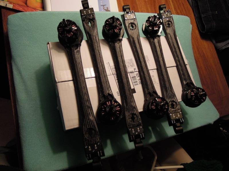

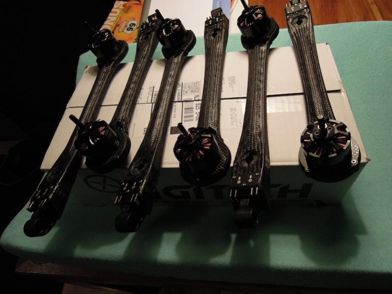

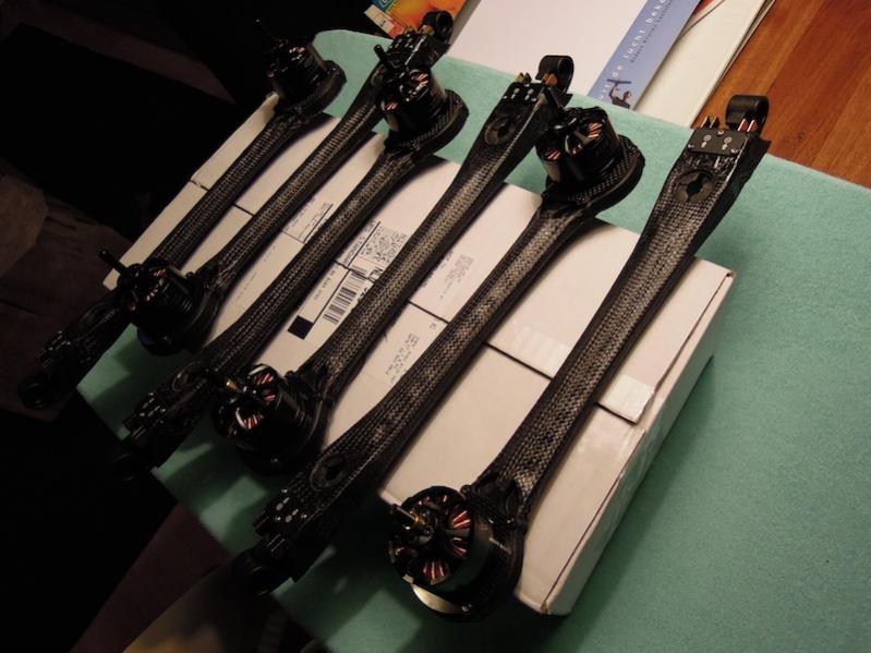

well now with this cold weather we are getting in some complaints with distorted images on the zenmuse.
it seems due to the colder weather (4-10C) the vibrations on arms seem getting worse.
the xoars seem to be doing ok , but a good and final solution are these arms.
we offer them now as a extra service to our customers.
View attachment 7845View attachment 7846View attachment 7847

BorisS
even better than modded arms, would be the info that dji is finally excepting this as an issue. I bet reseller are reporting back ? How far to a upgrade of the arms by DJI ?

Digitech
Boris
these are no supported by dji in any means , we use them monstly for customers that use a AV-200.
the added weight is about 15 grams on each arm
