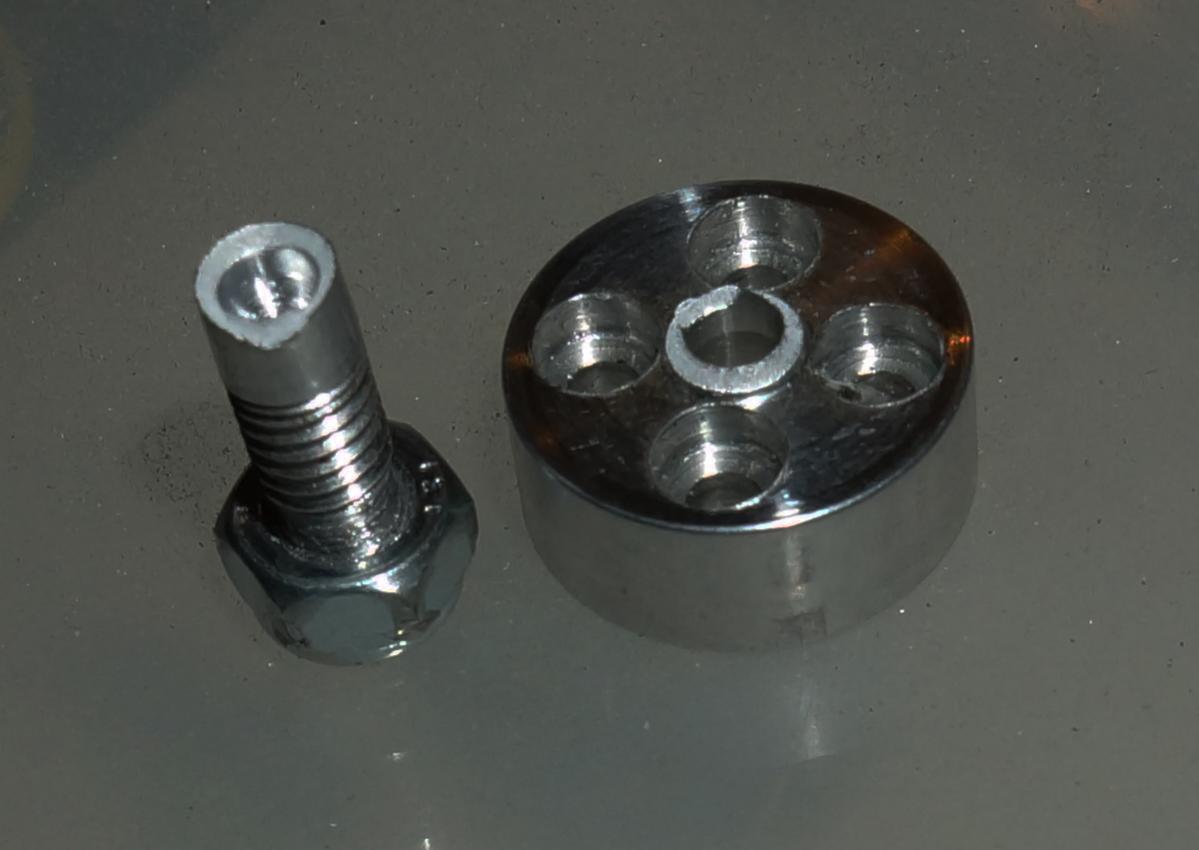

We all know that the S800 has had it's problems with reliability issues, but that is not an all together unique scenario amongst all Multi rotor craft. We need to be vigilant at all times to see potential failures before they happen. I almost feel that what I am about to say is going to sound like sour grapes to most people but. For most of my life I have been trained to design cutting edge components used in the most demanding of situations throughout the motor racing industry. Components that must not fail.
I just checked out a s800 adapter made by this company Secraft. It has a 4mm pilot hole that extends right into the base of the 6mm main shaft. This is made from 6061 alum. material and thus we have a 1 mm. tubular section at the most highly stressed part of the model. Not only does it have to support the weight of the model it is under tensile load from the prop. nut. Add to that a few torsional loads and it is about as strong as a carrot. Clearly it does not take a great deal of grey matter to see that this represents a failure point that could happen at any time. Sorry guys if you bought this item but it is going to fail at some point.http://www.secraft.net/shop/step1.php?number=1318 check out the drawing for yourself. It has a few other bad things like the stupid prop. nut and the countersunk screws and the nice stress raiser sharp edge at the base.
Please be careful, we don't need anymore issues. The S800 is a great machine that is now reliable. Lets keep it that way
DennyR
View attachment 7925 This is how much material you have supporting your investment when you drill out the 6mm main shaft with a 4 mm drill. FWIW
atomkind
Denny, isn´t this one of your adapters? the secraft ones look kind of different. What material do you use. Seems to be alloy too.
Also do you sell them via kopterworx?
jffry7
aka TruckBasher
Its Denny's adapter on photo but he deliberately drilled close to the 6mm shaft to mimic the secraft ones. if you noticed the Secraft is thinner than Denny's adapter. Dont worry if you are using one it would break like shown on photo as the drilled part is not too close to the shaft
DennyR
I do supply Matjaz and they wont break, This was a test that I did to prove that the Secraft design has a bad flaw. Even if they did copy the same material that I use.
