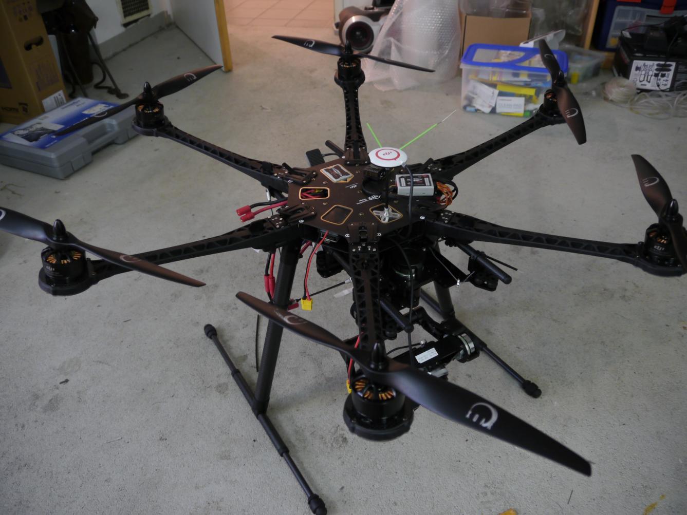

in terms of flight feelings (not vibration): apc's are the most smooth props. with xoars you will have much more nervous response.
I have been flying with APC and Xoar, but it is pretty logical that you will have to run different props (in that case plastic vs. wood) on different gain settings. I fiddle on the gains with each set of props untill I am happy, and than I save that settings in the WooKong Assistent software. So next time I change props agin....just load that matching setting from the Assistent....and off we go. At a certain stage (especially when using the Zenmuse) it becomes more of an academic issue which props you use......
I am prefering the Xoar props at the moment.....I am very happy with them...and I like the looks
View attachment 8224View attachment 8225
Chris
