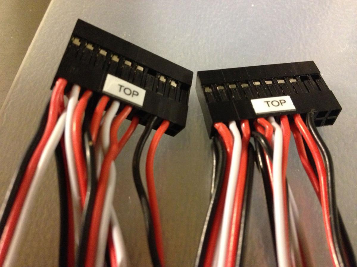

Can you also link the wiring harness modifying guide if you have it? I am not sure anymore which harness is the right one :shame:
Tuukkuli
Hi
Here are my harnesses. The one on the on the right has one extra wire, tilt pot. Which one is the new one to use with the dummy pots? I foolishly placed them next to each other...

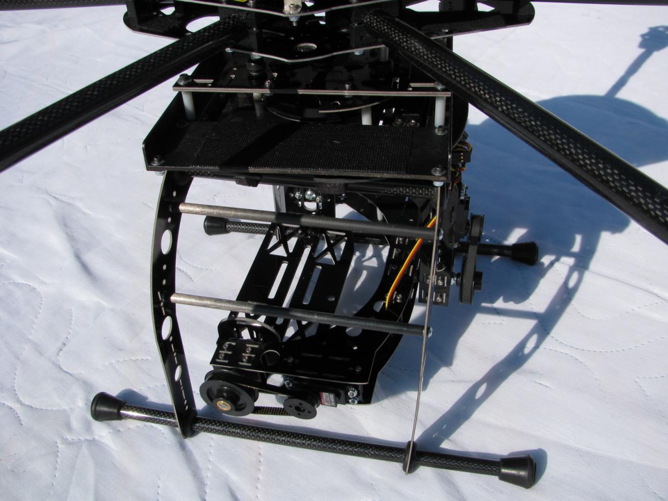

I found the direction out pretty quickly! Just as well I had a quick-release on the power plug ;) Tilt was going round and round and round...
I used auto and that will do until I flight-test. Weather is rubbish...
I will document / photo when tidied up and tested. Especially since it is a diy gimbal. No probs with a budget tilt servo either. I am building my own database of cheapee pot-removable 360-deg servos.
