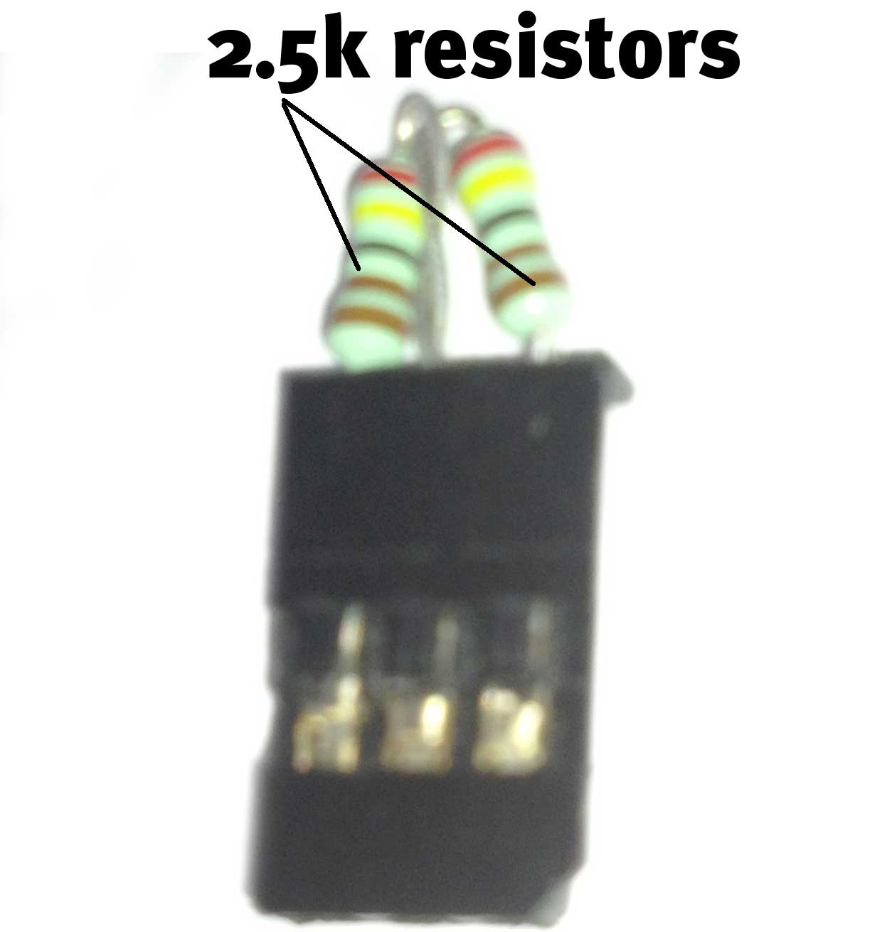

so is it safe to say YES I can go purchase a skyline and install it and wait for the software update or do i wait for complete new hardware also?
Yes, you can buy it. However, it may work very well or it may not (depending on many variables in your setup).
Ultimately, you will be ok but you may have to wait for the new reconfigured software. I don't think the hardware will change much accept for the wiring harness over the next few months. This is because the servos signal needs to come of different pins on the microcontroller etc. When the reconfiguration is done, it will be safe to buy with guaranteed results.
