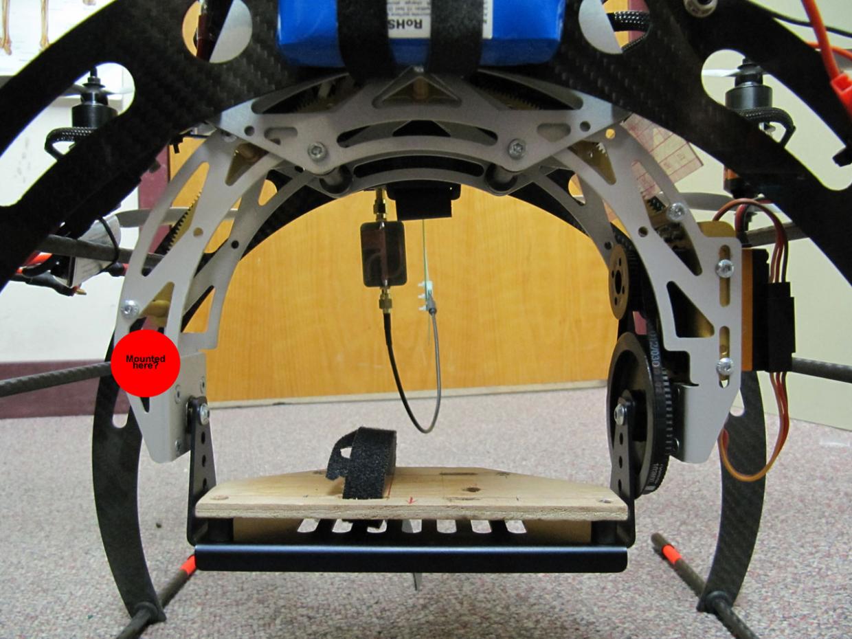

Would you mind showing us some pics of how you have the Skyline for roll mounted?

Hi Guys,
The second Skyline is mounted to the side of the camera mount on one of the arms or sides that support the tilt axis bearings. It sits right behind the tilt axis Skyline. There is no black magic.

Sorry, still not completely clear to me. So, you have it mounted to the roll cage oriented perpendicular to the Skyline on the tilt axis? See red circle in attached pic. Thanks, Shawn

If i understand correctly:
the second skyline you're referring to is the one that stabilizes roll so it's not rotating with the camera bed but it's fitted to the arc so that it rolls with it.
Did i get it or shall i sue my english teacher? (again....:))

WayneMann
Hi Guys,
The second Skyline mounts directly beside the tilt axis Skyline. The tilt axis Skyline is obviously mounted to the Tilt axis shaft and the roll axis Skyline is sitting right behind it on the side plate that houses the tilt axis bearing. I doubt that it would be possibe to rotate the Skyline 90 degrees and mount it to the face of the roll axis or parallel to the camera lenses and use the tilt axis portion of the Skyline to control the roll axis. I thought about doing this so that I would have slew control of the roll axis, but I have not had time to test this.
