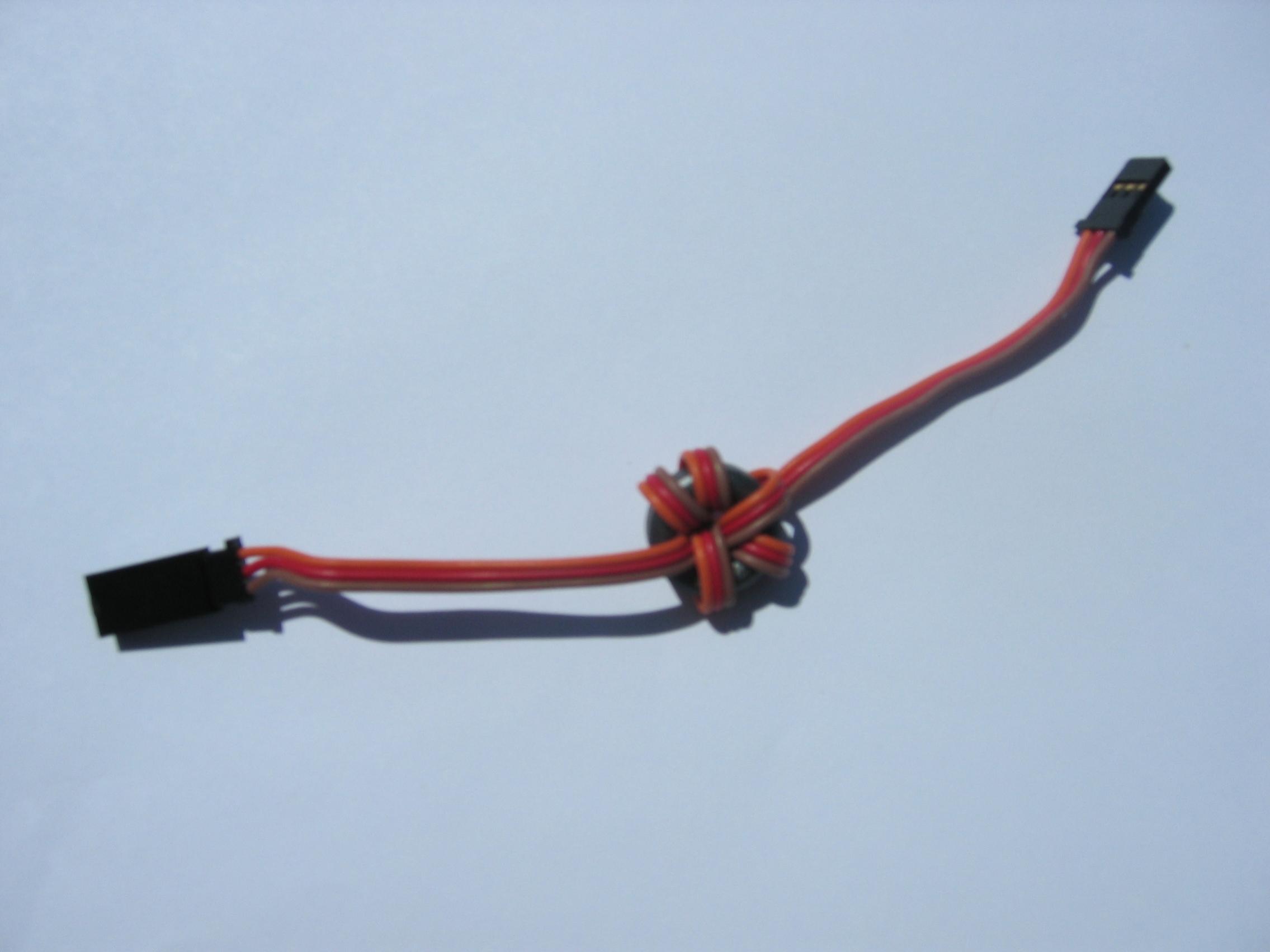

Do You use a Ferrite ring on your servo cables: View attachment 5421
Most of the time with that you get rid of interference from the sourrounding hardwares. If that doesn't help the interference might already happen on the stabi board.
