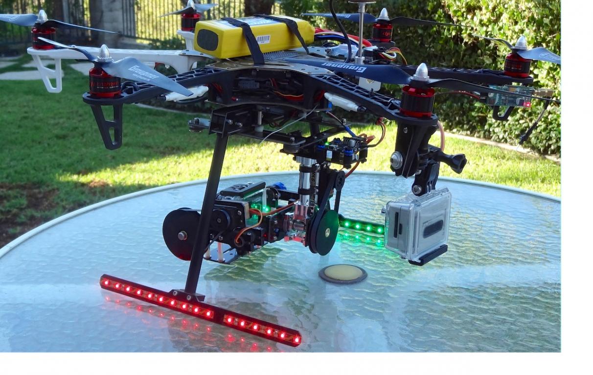

I have tried resetting, re-calibrating, etc., but with v1.7r2, I even get yaw coupling with everything off except power to the Naza flight controller and the HFG board. Withe board basically pointing north, at initialization, if I manually yaw left, the gimbal rolls to the right. Yawing back through north, it levels out, but if I continue yawing to the right, now it tilts back. Very repeatable. :dread:
I went back to v1.03, and bingo, the problem went away. The video below was shot this morning. The only change to the setup was the switch back to v1.03. I've had these same issues with every version from v1.5 on.
So, until you guys figure this out, I will continue to recommend to our customers that they use v1.03.

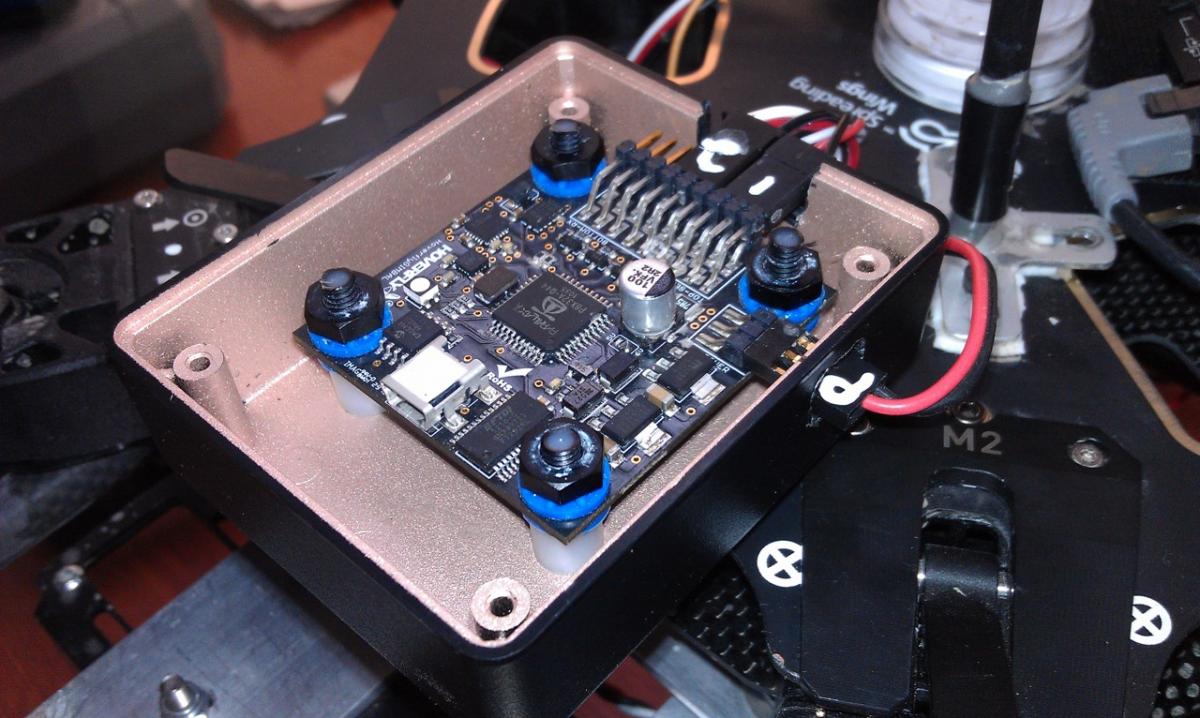

Hi,
i have the PH AV200/360 and had problems with the horizon going off while jawing. In tried all Firmwares available but there wasnt any change at all.
I tried different mounting positions and nothing changed.
Then finally i mounted the board exactly like you can see it in this video from HF. Now the horizon stays pretty much the same while yawing.
I dont have a camera mounted yet and the copter is not ready to fly, so it might change with everything set up.
For right now it is ok.
But why is it like that? For some people it works for some not.

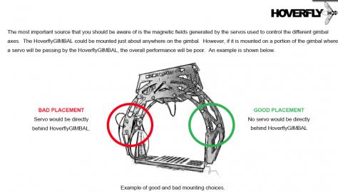

George: I guess I misunderstood this part of your manual as seen in the screen shots below that makes reference to magnetic interference. There are also many individuals who have commented on the fact that the placement of the board relative to their camera and other electronics effects the operation of their HFG. A shielded box seemed to make sense. I was so desperate for a solution that I would have waved a dead cat over it if I thought it might help. In any event: I just re-tested the HFG with and without the shielded box. If I fly with the unit contained within the box I have no issues with my horizon. As soon as I attempt to fly without the box I am right back where I started: a horizon that is very quickly off by more than 10-15 degrees.
I appreciate your comments above, George, but they would have meant a whole lot more if they had been made to me directly and at any point during the past 3 months when I was desperate to get some assistance with this prior to the end of my Fall photo season. I contacted your company through Ben many times voicing all of the issues I was experiencing and always expressed the urgency of my situation. The only "tip" I was offered was to go back to 1.03 and then, just last week, to go to 1.7. Nothing in between. I know that you are now trying to help me with your comments above, and I appreciate this, but it is too little too late and this is no way to conduct business and still expect any customer loyalty. In very simple terms: I am a guy who bought your product. It did not work as advertised. I practically begged you people for help. I never got any. I'm done. What other outcome could you possibly expect?
Here are two screen shots from your user manual that specifically make reference to interference:
