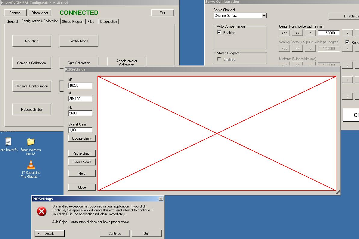

elossam
I´m testingf the 1.8 rev 1 firm. Some questions I saw.
The first one is I still need to click twice on the connecting button as the first time it shows "unable to detect device".
Then, on the general page it shows Hardware version: Gimbal 1.0 (the unit is a V3 but may be that has no importance).
I was able to make the gyro and acc. calibration, play with the gains, set the servo values... but sometimes the yaw chanel didn´t work in self stabilization. I works for stick imputs but not for auto compensation (even having it enabled). When that happens I cant see the graphics in the PID option of this channel (yaw) the screen was crossed with two red lines and a windows advised me about an unhandled exception in the aplication (Axis Objet - Auto interval does not have proper value. And a click on the details shows at the end this sentences: ************** JIT Debugging **************
To enable just-in-time (JIT) debugging, the .config file for this
application or computer (machine.config) must have the
jitDebugging value set in the system.windows.forms section.
The application must also be compiled with debugging
enabled.
For example:
<configuration>
<system.windows.forms jitDebugging="true" />
</configuration>
When JIT debugging is enabled, any unhandled exception
will be sent to the JIT debugger registered on the computer
rather than be handled by this dialog box.
After that I can see the PID values, which are set as they come from factory but cant do it work, and the the diagnosis label all values becomes freeze and the Setu program goes slower until it hangs.
