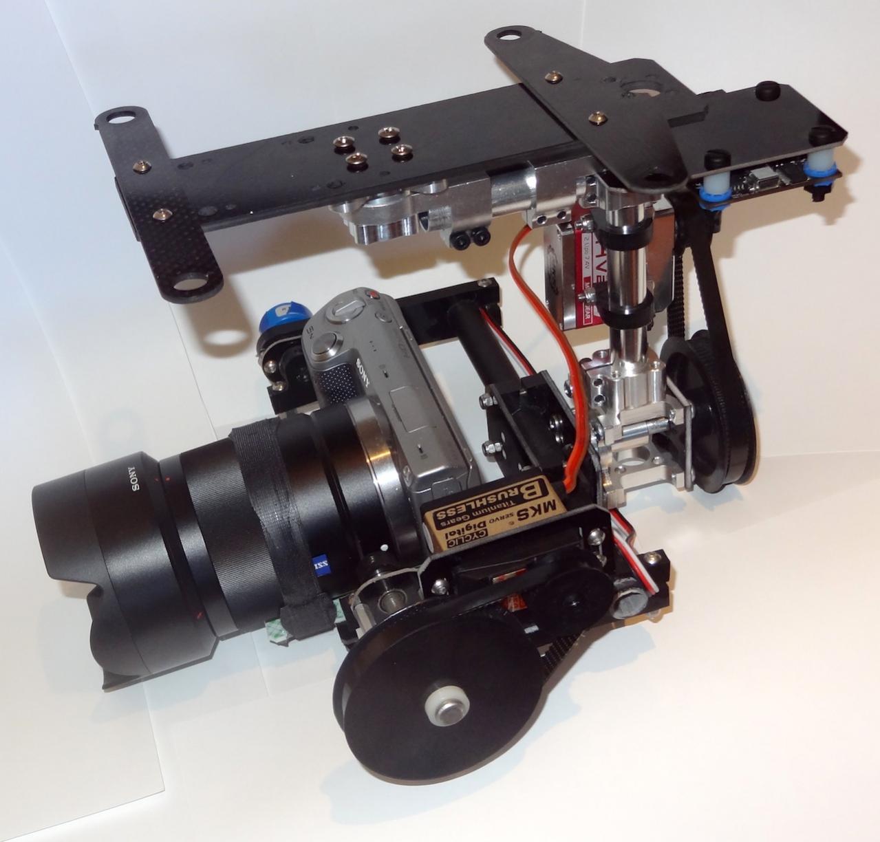

We too have reverted to v1.03, as it causes less problems in this area than v1.6, but it still will do it. The trick to a workaround is to move the HFG board so that it is at least six inches away from the body of the camera, and also not anywhere near being directly over the camera. We added a small mounting plate that moves the board to the very top/rear part of our AG550v2 gimbals. This has pretty much eliminated the problem.

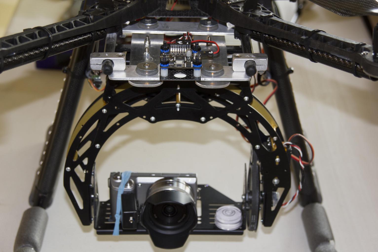

Thanks for this. Nice picture by the way and VERY cool looking gimbal! I sure wish that I would have bought one of these rather than the PH AV200. My HFG is well above the camera but I must admit that it is pretty much directly over the top of the camera and a little to the front as you will see in this image (if I can get it to load alright). Take a peek and tell me what you think, if you would. It seemed as though this location would be well away from GPS, IMU, lipo and lipo wires, etc. so it seemed like a good spot but if it is the camera itself that is creating interference maybe there is a better location. I will be interested in what your thoughts are on this. Thanks again.
Pete

Yeah, I think you really need to move it behind the gimbal somewhere. I haven't ever got one to work when it was directly over, or in front of the camera.

Gary: Thanks. I was able to move the HFG up approx. 2.5 inches and back nearly 6 inches from where it was in my image. This was an easy fix so I will try this and see if it helps. If not, any other move is going to be a big headache. Also: if we believe that it is the camera that is causing the interference I should simply be able to remove the camera from the equation and see if the gimbal still rolls in the way that it has been doing. I assume you tried this so as to confirm that it was in fact the camera that was causing these issues (?)

Yes, I did that, and I've tried different cameras. Surprisingly, the NEX-5N wasn't as bad as my RX100. The worst, though, is the PJ710V. The HFG board needs to be close to 7" away. With the NEX-5N, it is more like 5", but not directly over it. The RX100 needs to be a good 6" away.

Okay, that's what I figured... and now that I think of it I do recall your mentioning this so I should have remembered this. When the winds die down a bit I will be able to give it a go and see if what I have done improves things. The problem is that I cannot find anywhere else to mount the HFG without other potential EMI issues, although perhaps the cameras are the worst of the bunch. I'll find out soon I suppose. I'll post my results. Thanks again, Gary.

Gary: Just wanted to say that your advice of moving the HFG board further away from the Sony NEX5N camera seems to have helped quite a bit! I just did a test flight and the results were far better than yesterday when the board was mounted slightly lower and forward of its present position. Since the HFG seems to be so sensitive to EMI (or perhaps RFI - don't know much about this stuff) I will be testing a small, light weight plastic shielded box to house the HFG to see if this helps further. Who knows; perhaps it will work well enough to allow the HF to be mounted closer to a camera with no negative effect. I'll post my results once I receive the box and get further into this. Thanks again for your very helpful advice.
